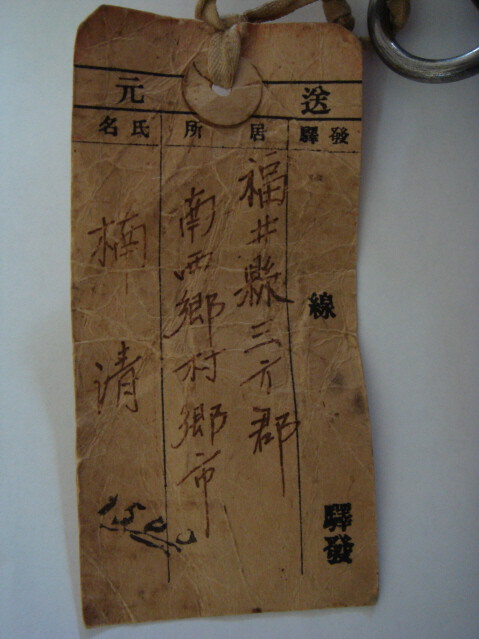

Who can tell me something about the smith (any information is appreciated) and who can translate the surrender tag for me...?

福井県 Fukui Ken (Prefecture), 三方郡 Mikata (?) Gun (County), 南西郷村 Nansei Go Son (village), 郷市 Kyoichi/Goichi ? and the name is Kusunoki Kiyo/Kiyoshi (?)
*Without knowing the actual place names in Fukui Prefecture it's hard to guess the local readings. The Kanji on their own are fine as long as no-one tries to pronounce them!!! :lol:

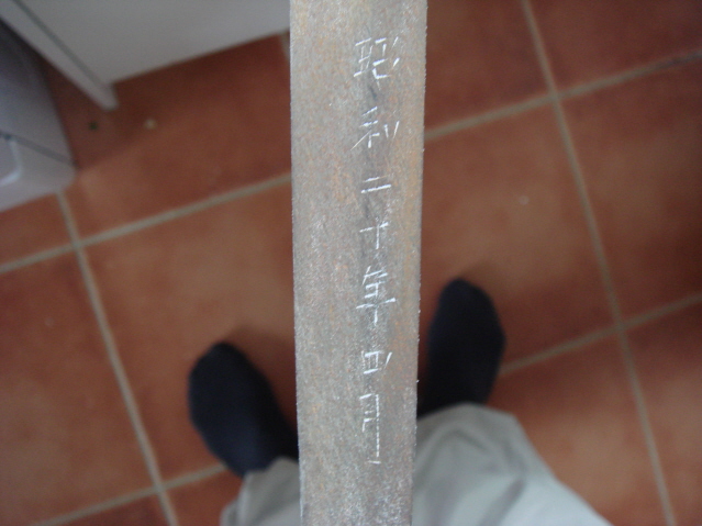

My 1st attempt on a date!!? (No giggling) :oops:
Sho
Wa
2
- = ( 20 )
10
Nen = Year
Shi……= 4th
Gatsu…..= Month
So my translation would be, April 1945?
If so, then in 1944 Yoshifusa is one of the listed 209 smiths registered officially as sword smith in Seki. (See page 212 of Modern Japanese Swords and Swordsmiths. From 1868 to the Present)
Am I close??
