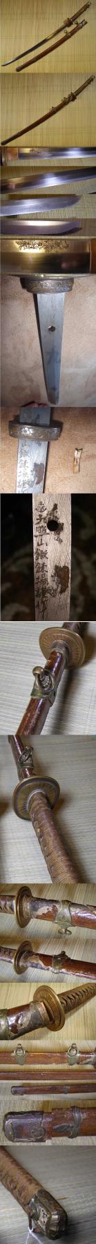

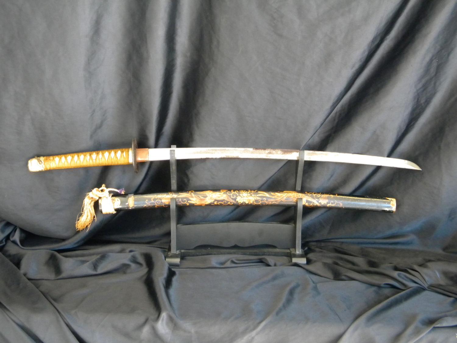

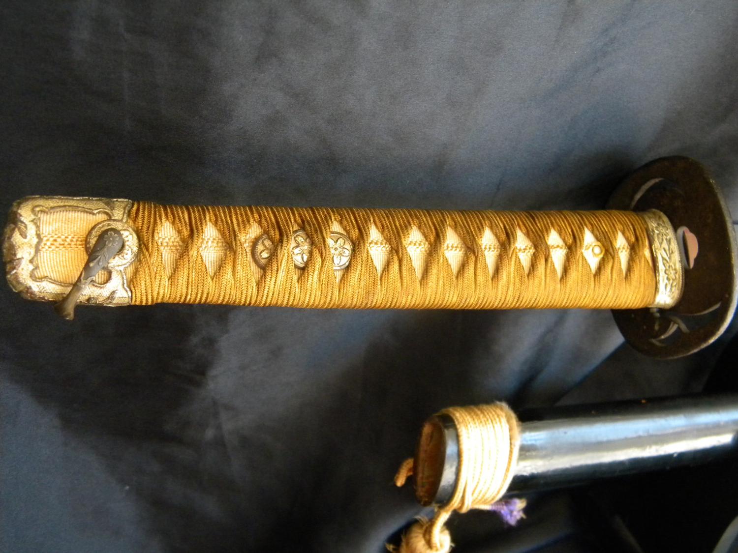

tokashikibob Posted October 26, 2016 Report Posted October 26, 2016 Gents, You may have seen this before as I spotted it on a few old boards. I was intrigued by the tsuka, as i seem to get excited by unusual in Nihonto and also because I've tried my hand at a few wraps with the help of Thomas Bucks book. Anyway, I bought it. The Tsukaito is gold and the backing is a fine cloth. However, all the fittings are standard Navy. The scabbard is unusual and maybe not original due to theme to the piece but it fits together well and maybe is correct? Has anybody else seen or own odd Navy koshirae blades? Other points of interest are what i believe to be a zodiac date and the Star stamp Endo Nagamitsu mei and a family symbol beneath the tassels on the scabbard. Best Regards, Bob Quote
Stephen Posted October 26, 2016 Report Posted October 26, 2016 Hey Bob So far i see a navy type tsuka added to sword dont see them matching, missing mei pix brother Quote
lonely panet Posted October 26, 2016 Report Posted October 26, 2016 it looks very much like those "put togeather " pieces made up of loose fittings from a backyard dealers. it tsukamaki work is beyond poor, and the shows no sign of use, and the tsuka looks so fat and round . Endo Nagamitsu?? I cant see the Mei, just a date. but this smith does have a medium ranking. so you could think of a togi if the blade has merrits Quote

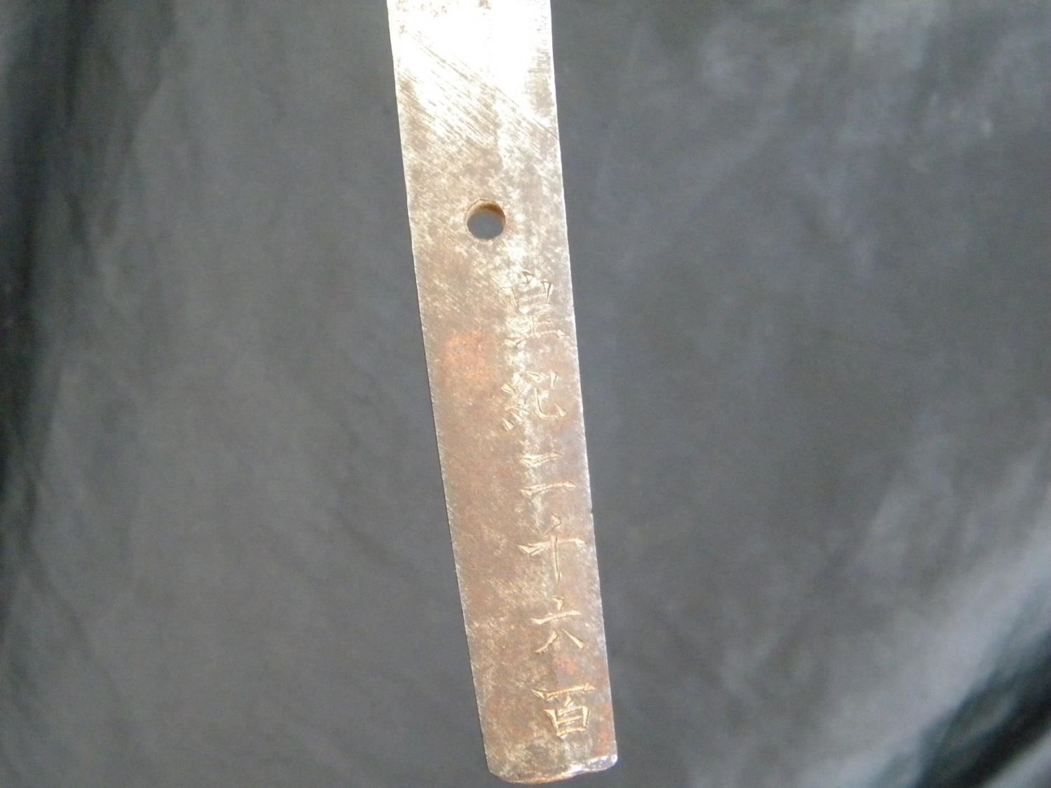

tokashikibob Posted October 26, 2016 Author Report Posted October 26, 2016 Steven & Hammy, Here's the Endo Mei. The last inch of the nakago is gone, another mystery. Anyway you may be right but I'm thinking some sort of Navy civilian government worker. Tsuka is good work, Endo Nagamitsu not so much even with the star stamp. I'll get a kurikata for it and put it away for another day. Quote
Bruce Pennington Posted October 27, 2016 Report Posted October 27, 2016 The stamps on the nakago-mune are Kokura: 小 Army Arsenal Kokura Factory - Kokura Army Arsenal inspection mark: "Ko". "Ko" stamp is not discovered except for the following example. It seems that the inspection mark used the "To" commonly since most Tokyo Factories relocated to Kokura Factory. ホ Army Arsenal Kokura First Factory inspection mark: "Ho" So the blade, at least, was made for an Army officer. 1 Quote
