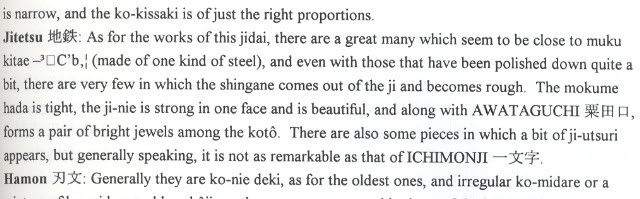

Shintetsu or core steel showing in places is a good indication but there are always exceptions to the rule
According Kokan Nagayama and some others like Harvey Stearn the tsukurikomi like Kobuse or Makuri were invented in the late Muromachi (around 1450), so many koto blades which are folded never show core steel and seems never tired even though they are also fine as a cigarette paper.
This can be interesting and instructive :)

If you read thru the Usagiya site provided you'll see it's belived
that Shingane was already present much before the dates Nagayama and
Stearn quotes (according to you...).
Thinks to Soshu Kitae too. To arrive at such a Kitae
needs several stages before. ALL the Kitae started from 1450 ?

Read also the connoisseur's book of Japanese swords (Page 33) and Comments on the Construction of Japanese Swords by Harvey Stearn, BUSHIDO: An International Journal of Japanese Arms, Vol 2, No. 3, January 1981.
You can believe what you want, it's not my problem.
