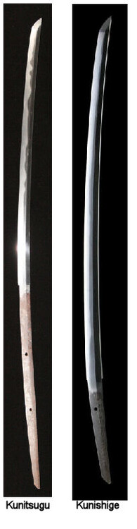

Marius Posted October 4, 2007 Report Posted October 4, 2007 Dear All, could you have a look at this sword here, please: http://cgi.ebay.com/SAMURAI-Katana-swor ... dZViewItem Is the nakago "real" or has it been produced to remove some flaw of the blade? The sword looks like a nagamaki, but the shinogi zukuri does not fit this weapon. BTW, I have recently posted a request here to have the origami for this sword kindly transalated. How stupid of me I haven't put my question clear... Sorry for posting another thread. Brian, feel free to remove it (once you do it I will know that the answer is: of course it is a nakago someone has tampered with :-) Best regards Quote
huntershooter Posted October 4, 2007 Report Posted October 4, 2007 The nakago looks like that of a naginata. From what I can see from photo's it appears, if not original, not "added on". I'm sure help will arrive shortly Mariusz. Quote
Nobody Posted October 5, 2007 Report Posted October 5, 2007 I think that the Kunitsugu was originally made as a katana and its machi was moved but its nakago was not shortened. In the attached photo; Left: Kunitsugu in question Right: a Kunishige (same Mizuta School) for your reference Ref. http://www.touken-sato.com/web-gallery/ ... ohyogo.htm Quote
Marius Posted October 5, 2007 Author Report Posted October 5, 2007 I think that the Kunitsugu was originally made as a katana and its machi was moved but its nakago was not shortened. In the attached photo; Left: Kunitsugu in question Right: a Kunishige (same Mizuta School) for your reference Ref. http://www.touken-sato.com/web-gallery/ ... ohyogo.htm Koichi, thank you, this was valuable reference. I understand that the machi has been moved up, possibly to remove a flaw like hagire, but it is still very strange that the nakago has NOT been shortened to convert the katana into a wakizashi. Who would want to carry a wakizashi with such a long tsuka? Best regards Quote

Mike Posted October 5, 2007 Report Posted October 5, 2007 Could possibly katana reshaped into nagamaki. You can see that on the closer part of nakago to the ha-machi, the color is lighter than below. Mike Quote
