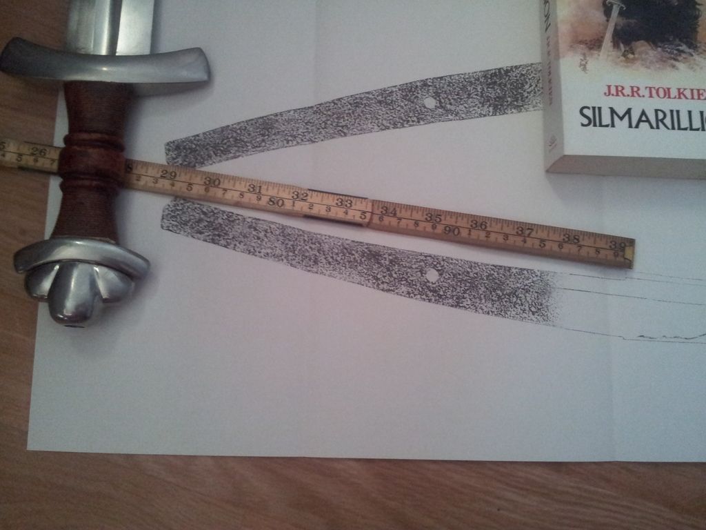

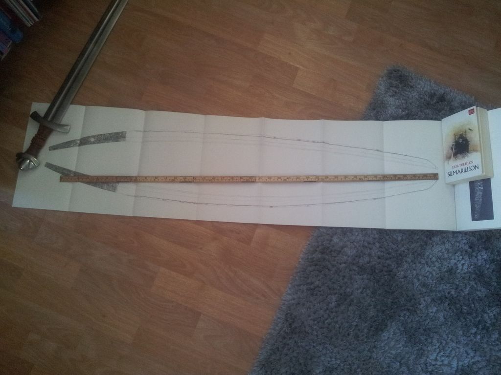

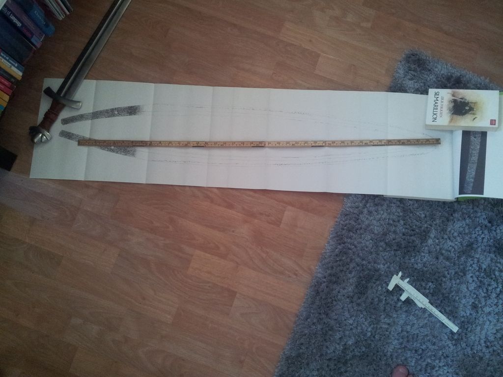

I believe full length from nakago end to kissaki end is 全長 - Zencho. For some very curved old tachi this overall curvature can be very large. I measured few for the fun of it. I took 3 swords for which Imeasured this, as the overall curvature is my own measurement it's only c. as I couldn't get it down to mm accuracy as the book has folds and I am very careful in stretching the pages.
1st sword: nagasa: 80,3 cm, sori: 3,2 cm, nakago sori: 0,7 cm, overall curvature: c. 6,0 cm
2nd sword: nagasa: 84,4 cm, sori: 3,2 cm, nakago sori: 0,6 cm, overall curvature: c. 5,0-5,5 cm
3rd sword: nagasa: 83,7 cm, sori: 3,8 cm, nakago sori: 0,4 cm, overall curvature: c. 6,0 cm
First two pictures are of sword n.1 and third pic is of sword n.3.
