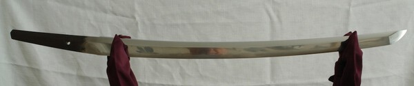

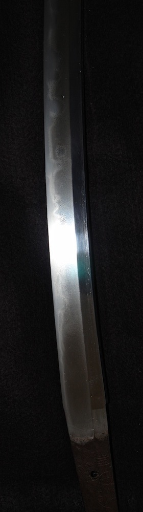

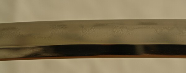

The subject blade I have, shows ji nie and tobiyaki, so my question for discussion is, ‘would this blade be considered, in one of the two categories mentioned, if at all?’
There is a mei, but not visible in the photographs
O’ Wakizashi
Nagasa = 49.53.
Sori = 1.4.
Hamon = Ji nie. Tobiyaki. Toran-Midare?
Boshi - Sagatta.
Nakago = Ubu
Nakagojiri = Kengyo
Yasurime = Katte-Sagari.
Mekugi ana = 1.

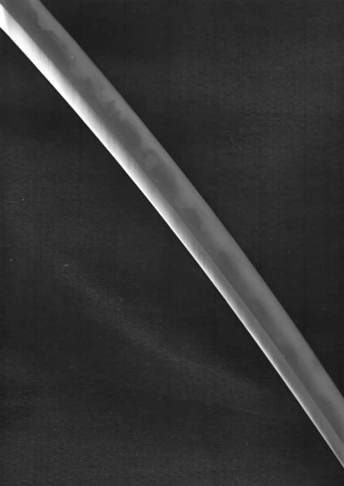

One good indication is to research other work by the same smith and see if it consistently shows up.
It looks to me as if the smith was purposely trying to get a scattering of nie and tobiyaki over the blade. Some looks well controlled in its application, some looks a bit out of control...

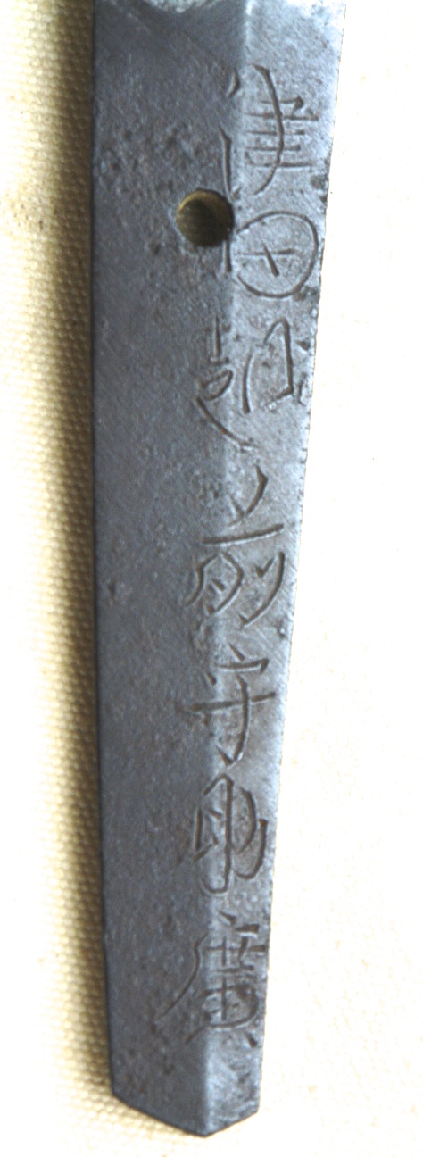

First, even I could see that the mei is off, and to be fair I bought as such, but I thought there was a certain quality to the blade. From there on a couple of ideas, a search of books and internet, led me to the point of posting my question on the board.

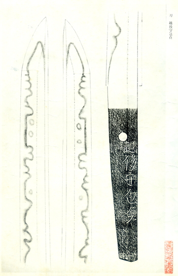

Markus indicates several smiths who worked in the then highly praised toran- midare of Sukehiro
(Shinto and Shinshinto Kantei page 309)

You will not see ara nie all over the ji of a work by Sukehiro, Sukenao, or Suketaka....This smith was a few ranks lower in skill than these well known smiths....
Also, this hamon is shaped more like that seen in the work of Echigo no Kami Terukane/Kanesada or some of the later Tamba no Kami Kanemichi smiths.
Sukehiro, Sukenao and Suketaka make a more rolling wave, rather than squarish, shallow waves with space between them....if you get my drift...

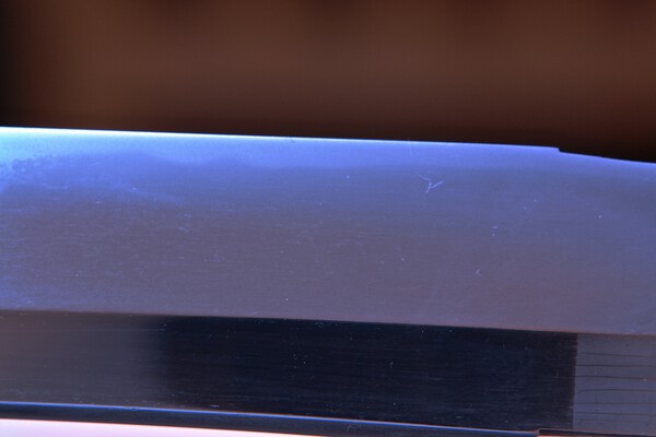

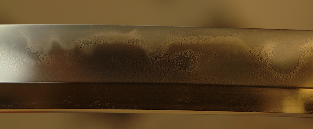

Where the ara nie in the ji on your sword break down they are forming yubashiri rather than tobiyakai. This is thick ji nie with no defined boundary. Tobiyaki would be clearly defined areas of hardening in the ji. So for instance you would see yubashiri showing on early Soshu swords but the nie is fine and beautiful, and even more earlier you will see them in Ko-Yamashiro. With the mid period Soshu you get tobiyaki which look like an attempt to formalize the formation of yubashiri which may have been only a pleasant side effect. With later time whatever method was used to make the tobiyaki and hitatsura in middle period Soshu is lost or evolves away and it starts looking really clumsy and artificial, then it goes away. Later on you see tobiyaki come back and with the specialized toranba of Sukehiro and the Osaka Shinto school, you get the round tobiyaka called tama. Not everyone did it so well as your sword and my Takashige show.

Satsuma more often than not is said to have, in addition to ara-nie, thick, long sunagashi, forming imozuru, the trademark of Satsuma work. Also, frequently, there is masame. Tama-yaki with a toran -like hamon are really not textbook Satsuma. Satsuma hamon often shows a Mino influence with some togari...Nakago shape is different as well. You might post pictures of the yakidashi as the Satsuma yakidashi is different than what is seen in Osaka and Tokyo blades. My bet is it will not look like those most often seen in Satsuma blades, which is more midare based.
The large, uncontrolled nie, as I have said, show this smith was a rung or two lower than the top smiths previously mentioned.
Look to the yakidashi for a hint. My bet is he was an Osaka or Osaka influenced/trained smith, down a few ranks from Kanesada and the like....Remember, the toran-ba became very popular and was emulated by many smiths in many different areas of Japan so you may never be able to pin it to anyone specific....

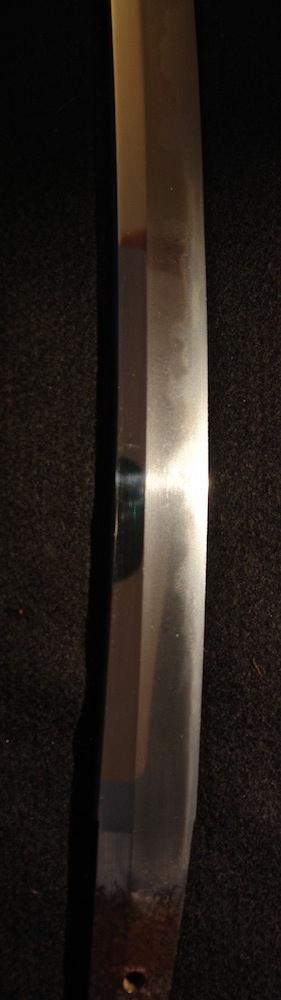

Now here’s a fix. Yaki-dashi.
I have found on one site, two readings for this term.
Yaki-dashi. Straight temper line near the hamachi.
Yakidashi. Hamon drops off the edge a short distance from the hamachi.
Now I have under stood that a hamon ,that becomes straight to the hamachi, as Yaki-dashi.
And a heated nakago, can causes the hamon to drop off before the hamachi. I wasn't aware of the term for this event.
The photos have been tricked to show the Yaki-dashi as I know it!
Are we on the same page?
Cheers.

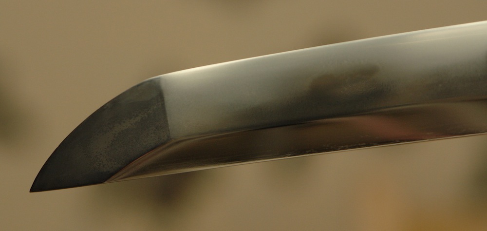

Usually yakidashi means the first few inches or so of the hamon as it climbs the blade from the hamachi. If the hamon runs off the blade before the hamachi, that is usually called yaki-otoshi.
Can you take a picture that shows perhaps the first half or so of the hamon? It is hard to get a feel from such a tight shot.

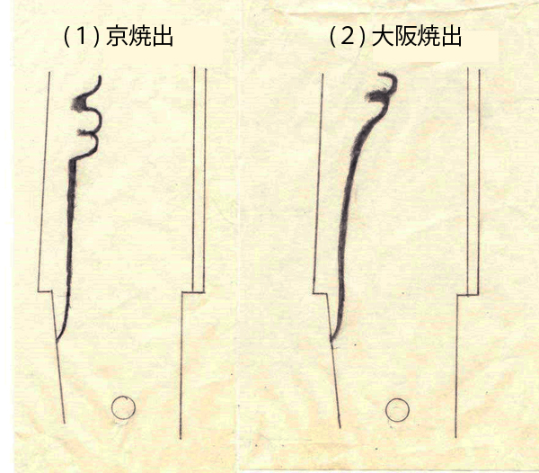

Please have a look at Osaka, Edo, etc., yakidashi and see if yours fits...
What do I know about yakidashi now? Not a lot but a lot more than I did yesterday.
Acting on advice from Chris, I searched for info on Osaka and Edo yakidashi, using my blade for comparison.
Typical Osaka yakidashi.
Starts in sugaha or gentle notare, then widens before shifting smoothly to midare. Sounds simple enough, but the application of that description to examples was fun.
But I did find two examples by Sukenao, that to me matched, called ‘sugu-yakidashi’, and others were not to far off.
Edo yakidashi.
The majority of Edo yakidashi I found stopped just above the ha machi, and the sugaha was not of any length.
Now with my limited knowledge, I compare my blade nearer to Osaka, as a general example. Knowing, that there are probable at least another dozen points I am not seeing, I submit the photos.

Hi Denis,
The book "Cutting Edge" is a catalogue of newly polished swords in the British Museum, by Victor Harris, Tuttle, 2005 (about 160 pages). A good book with many blade pictures...I think you can get it on-line for about US$ 35...worth it IMHO.
The explanation of yakidashi that was mentioned is on Pp.21 and 158 and if you look at the illustration (and also that kindly posted by Chris) the explanation fits well:
"Yakidashi - Lower end of a complex hamon that straightens into suguha on shinto blades of some Edo schools and slopes down down to hamachi on shinto blades of some Osaka schools" (my underlining for emphasis).
