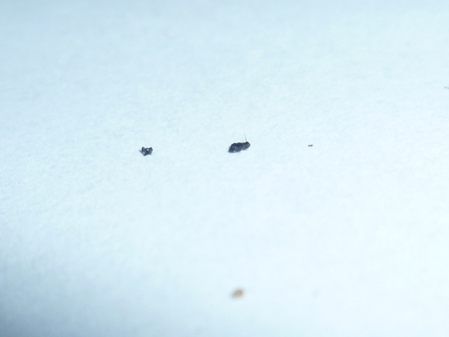

Hi Brian, just spent half an hour looking down the saya with a torch :roll:. Pinched an aerial off one of my lads toys (needed something harder than a pipe cleaner) and scraped down the saya where i estimated the bother might be. I tapped the saya out on a piece of paper, a picture below. Feels like grit, sure isnt wood. Whether it was this or not i will never no. Ive gone back to using the more viscous oil i used to use.
If anyone knows how much this will cost to put right il be happy to know. It is annoying, best sorting it.

Suspect from the image posted these scuffs are from contact with the side of the saya. Exactly from when and why may be difficult to determine. These could be from the way the saya was made (not all saya makers are equal as much as we would like to believe), or it could be something about the motion going in and out, or a combination.
