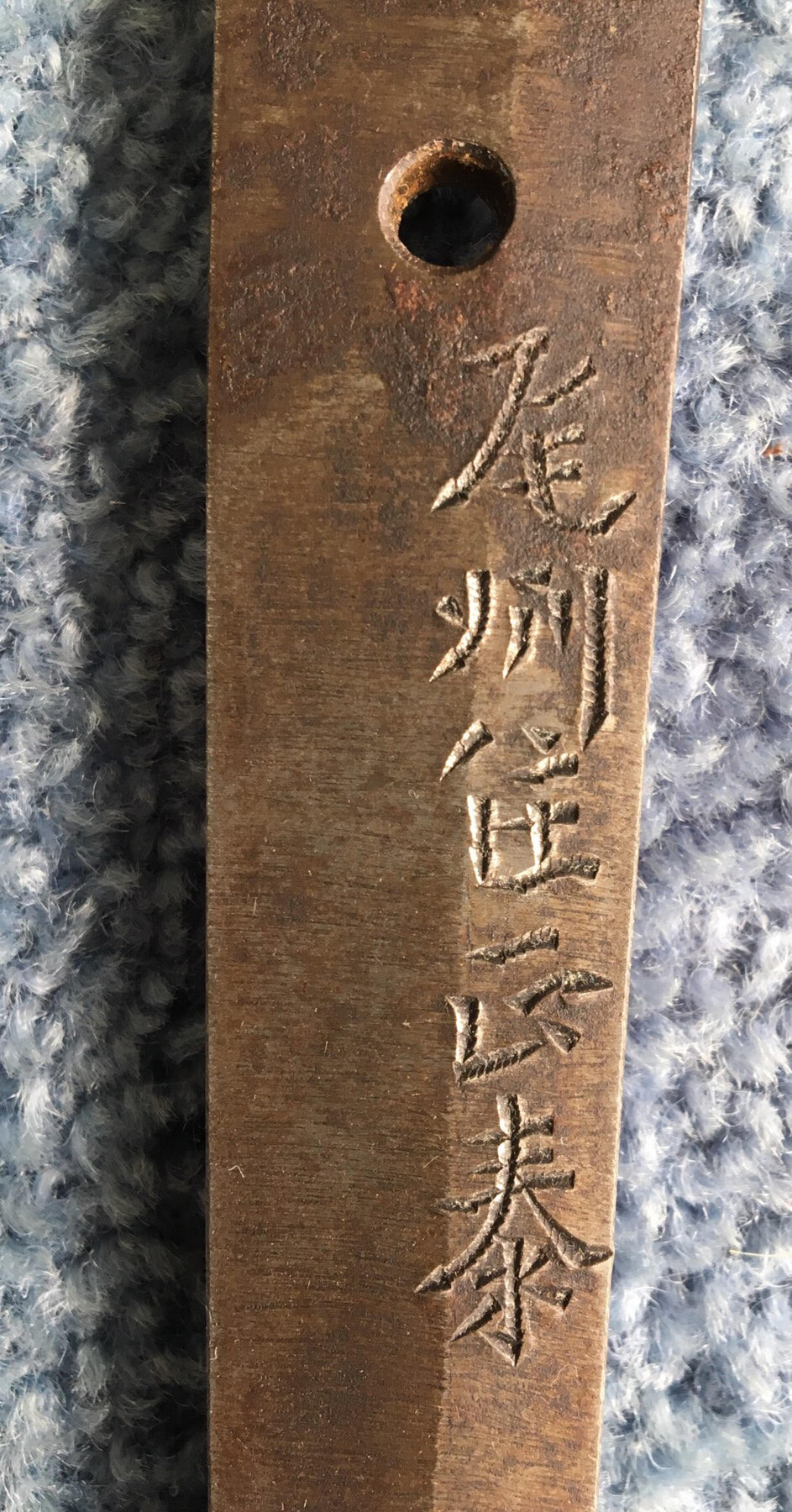

Trawling through old posts, and was searching for any information on (Mano) Masayasu, and stumbled on this one. So many different Mei. This Gendai-to is signed Bishu Ju Masayasu, in '94 mounts, so probably 1937ish, no date no stamps. It looks well made, with prominent Hada, Habuchi, and Hataraki.
Sorry to revive such an old post, but it helps reference swordsmiths where information is scarce.
