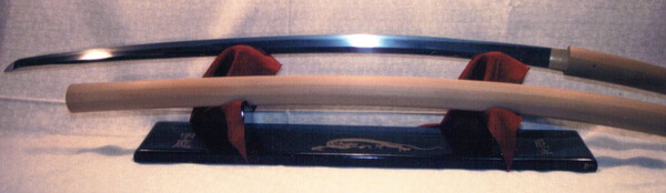

I have a koto tachi from a smith in a lesser desired area that is everything I wanted and it wasn't too expensive - well at least not 25 years ago. :roll:
It is O-suriage signed Kanemitsu of Mino - dated to 1330's = 34" , with funbari and no serious flaws.
Now if it was Kanemitsu of Bizen ?
Thanks Brian. A pic is a thousand words, eh? Funbari is a good word and is the limited taper in the first 10 or so cm above the machi. Is this what you see in your sword or is he refering to the taper of the sword as a whole? It is funny, sort of, 踏ん張り funbari, refers to standing with your feet spread to brace one's self more firmly, exactly what it does at the base of the sword. Why Tsuruta san transliterates it as hunbari I don't know. John
