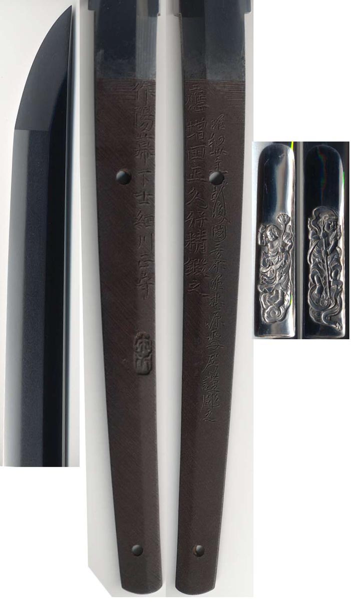

kunitaro Posted September 25, 2012 Report Posted September 25, 2012 Dear Cris, Thank you for mentioning Akihide. This is one of his work on Shinsinto sword. 作陽幕下士細川正守 Sakuyo Bakkashi Hosokawa Masamori 応増田正久好精鍛 Masuda Masahisa (no) konomi (ni) ouzi Seiren(su) 昭和三十年越後国三条昭忠源雪房謹彫之 shouwa 30 nen Echigo (no) kuni Sanjo Akitada Yukifusa tsutsushinde kore (wo) horu Quote

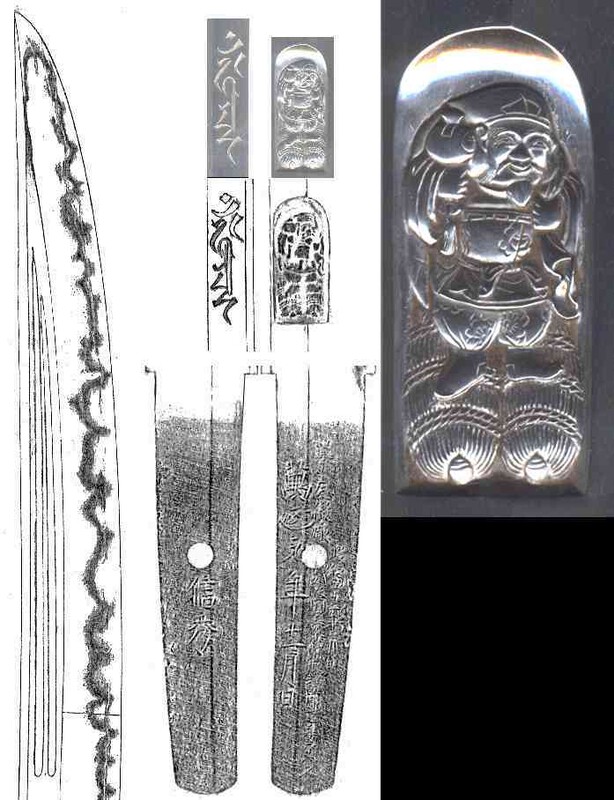

kunitaro Posted September 26, 2012 Report Posted September 26, 2012 And This is a work of Akidata on Kurihara Nobuhide's Osoraku-zukuri Tanto 信秀 Nobuhide 万延元年十一月日 Mannen Gan-nen 11 gatsubi 昭和四十二年三月日・虎徹底彫越後三条住昭忠彫之 Shouwa 42nen 3 gatsubi Kotesubori Echigo Sanjo (no) ju Akitada kore(wo) Horu Quote

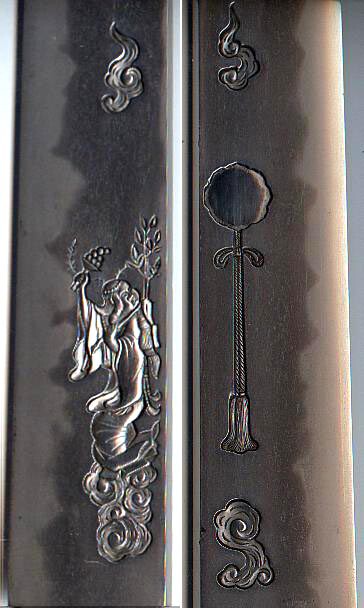

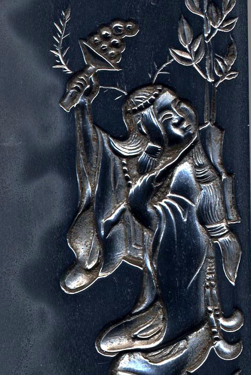

kunitaro Posted September 26, 2012 Report Posted September 26, 2012 This is a Nobuhide's work Ama no Uzume no Mikoto and Holly mirror on Hirazukuri Tanto, Osaka-uchi (made in Osaka) Nobuhide's Hori is very shallow, but, very sharp line and smooth surface. and He understood the reflection of the steel. This blade Bizen-den has Utsuri (as you see) with old Sashikomi-togi. His work is almost 3D. One of his master piece. This Tanto is staying in Sanjo/Niigata now. Quote

kunitaro Posted September 28, 2012 Report Posted September 28, 2012 Most of Nobuhide's sword with original Hori are Bizen-den or Nioi-deki. Which is meaning that doing Yakiire lower temperature for Blade with Horimono. so, we can think that Nobuhide was doing Horimono before Yakiire. (curving normal steel is much easier than after quenched ) He was doing Yakiire with lower temperature to prevent breaking the blade. Not He chose Bizen-den blade to give Hori-mono after sword is done. What do you think ?? Quote

kunitaro Posted September 28, 2012 Report Posted September 28, 2012 Thank you for your attention. I will discuss with mr.Toyama and more. Let us go deeper. Here is closer image for consideration Quote

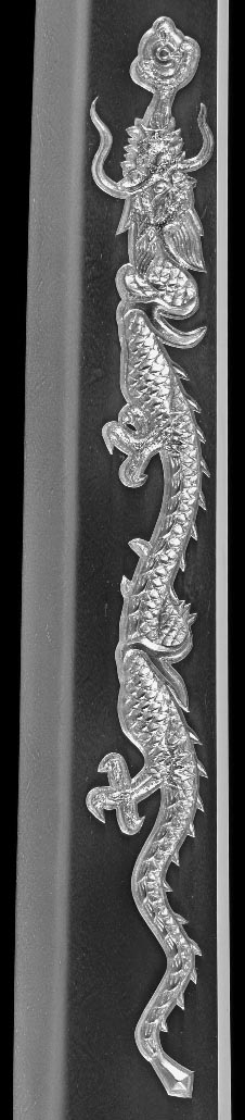

Eric H Posted September 29, 2012 Report Posted September 29, 2012 The photo of Fudo-myoo is the sword extant (preserved) at the stage before Ywkiire at Kurihara family's.He stooped carving at this stage, then do yakiire (Yakiba-watashi) Kunitaro, I‘m a bit confused, has this sword a tempered edge, or is it untempered? Comparing the Dragon Horimono by Nobuhide and Gassan Sadatoshi. Nobuhide and Yoshitane were the most skillful Horimonoshi in Shinshinto period. Sadatoshi is a contemporary smith who carves most excellent Horimono. Nobuhide forged swords in nioi-deki as well as in nie-deki. The close up of “Ameno uzume“ displays a nioiguchi tempered in nie-deki, that said, if he made Horimono before yakiire, and only on nioi-deki blades, this example speaks against the theory. Nobuhide‘s known dated blades are from 1855 -1878. Anyway if Nobuhide has carved Horimono before yakiire, and in succession of the theory only on nioi-deki blades, then it must be considered as unusual and a peculiarity of this smith. Eric Quote

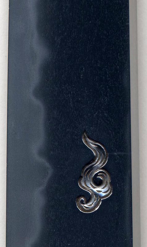

kunitaro Posted September 29, 2012 Report Posted September 29, 2012 This is a bit upper part of the blade, a few cm above Ameno uzume no mikoto, the cloud parts. There is almost no Nie, become more Nioi-deki, Quote
kunitaro Posted September 29, 2012 Report Posted September 29, 2012 more upper parts. more Nioi-deki, Which is meaning that Tempreture control is not 100% perfect... There we see Nobuhide's hesitation of Yakiire. There is many compete Nioi-deki long sword, but, not many complete Nie-deki blades. Quote
