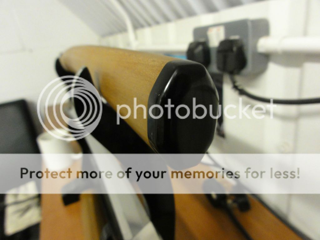

Hi, thought I would post pictures of the first attempt, it was on a new shirasaya, that was starting to split. They actually look better in real life than in the photos ! Sadly, both bits of horn had imperfections in them that did not become visible until after I had shaped them and reduced them in size, after they were stuck on to the shirasaya. But as i say, it looks better in the hand and I must say I am very pleased with the result. I put a new Koiguchi on the top and fitted a matching end tip to the saya:
It was very fiddly work and the horn is quite awkward to work accurately, _ I appreciate the craftsmanship of the people who do this for a living even more now..However, the next ones will be quicker and better I am sure.
