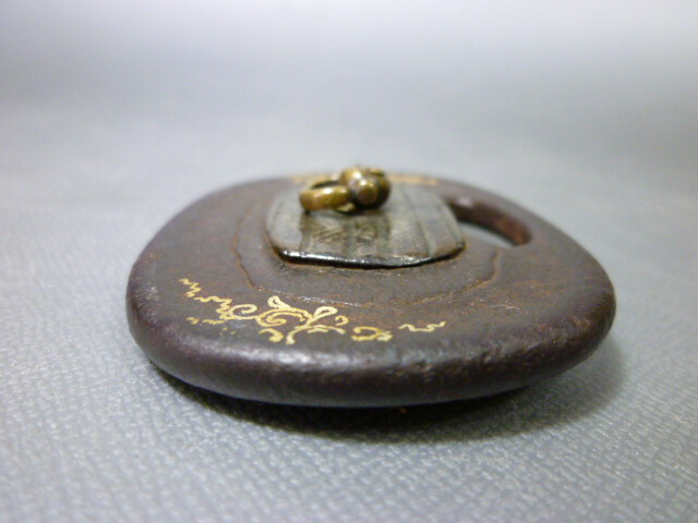

I would think the tsuba was an already existing item adapted to a new life as a netsuke. Whether the undulating carved line is original, I am inclined to think so. Different isn't it? John
Not 16th century. More like 19th century Edo Higo?
Tsuba came first.

Wavy lie probably added later. I have no idea why!?
Say what you want about this Edo Higo stuff, while the quality isn't top drawer- they didn't suck. Not my cup of tea, but is pretty in the opinion of most people not steeped in Nihonto education. The wavy line seems out of character for Edo-Higo work, which is usually professional and clean if not particularly highbrow. Sloppy wavy line was probably done later.

Leaving aside the quality of the Netsuke conversion, the owner tells me he had this tsuba checked by two leading Tsuba experts who took it in hand and pronounced on the Tsuba itself as "Very fine Higo school, dated Azuchi-Momoyama Period (1568-1600)".

I like it! Wavy line looks original..... Have no idea why, but no matter. Its a curio of indeterminate worth and I wish it were mine. :D (donations gratefully accepted since I have blown my budget for acquisitions for the rest of this year). :bang:

Well, if you don't know then I certainly don't. I have spent half the day reading up in Japanese and English and it is far more complicated than I ever imagined.... as far as I can gather several artists and styles (Hayashi Seibei, Hirata Shippo-ha) were brought together in the 1580s and 1590s by Hosokawa Sansai from Kyoto, Edo and Korea, etc., but what we know officially as Higo work does not seem to come together fully until early Edo. Still, it's been a good learning experience!!! :clap:

Options: (1) Our three mystery tsuba experts are all wrong or not that expert
(2) The owner reporting the 'three tsuba experts', is backing up his story with less that solid or true statments.
(3) I am wrong and this is a pre-Edo pre-Higo treasure with homogeneous iron and style to be found primarily in Edo Higo works.

I thought there was no doubt that the Higoryu was Edo period whether Hayashi, Shimizu, Nishigaki or Hirata branches and was influenced by Hosokawa Tadaoki Sansai and the chanoyu. As Sansai was mentioned before I remind us of him. John

As for the answer to the original question, it seems that we are all of the opinion that the chicken came before the egg, ie that the Tsuba, not a bad example of Higo work, came first, and the Netsuke was created later...

I was relieved when Currran stepped up to the plate to take a swing at the notion that this tsuba was alleged to be so early ie; pre 1600. The new date is suggested to be mid 17th cent. seems reasonable to me. I don't agree that the wavey line is sloppy nor that it may have been added later though. I think it's perfectly within the range of the aesthetic expression one see's in this school work.
A brief survey of the various gold nunome decorated tsuba illustrated in Mr Ito's excellent books on the Early Higo masters would lead me to suggest that the work under discussion is closely related to, or from, the early Nishigaki Kanshiro group. I've spent quite a bit of time this last year poured over these karakusa designs and replicating them myself so I think I may have developed a refined eye for the subtleties of the design pattern. :glee: The specific character of the tendrils, spirals and leaves is very similar to the work of Kanshiro II ( 1639 ~ 1717) and the iron texture and colour is perfectly consistent with that attribution also, in mnsho. ;)
I don't think that awful washer arrangement that's been bodged on to it helps in any way to fully appreciate it as a tsuba though :? I'd have that off in a jiffy! Bloody netssookie...daft trinkets anyway :roll:

Hello, I'm the owner of the tsuba netsuke.
Thank you for having transferred the photos here, we have a serious server bug in the netsuke forum and the photos keep vanishing.
I AM NOT tsuba or even a metal expert. When I bought this netsuke through Yahoo Japan it was because I thought that the quality was much better then the Meiji copies normally seen. When I received it, I realized that the tsuba was of high quality while the netsuke mountings had been done by an amateur.
I showed the tsuba to London expert and he told me orally: 'Very early Higo school'.
I researched the Higo school on the net and mostly found what 'Bugyotsuji' did: "as far as I can gather several artists and styles (Hayashi Seibei, Hirata Shippo-ha) were brought together in the 1580s and 1590s by Hosokawa Sansai from Kyoto, Edo and Korea, etc., but what we know officially as Higo work does not seem to come together fully until early Edo". I personally assumed that very early meant meant in this case 1600.
I showed the tsuba to a Swiss expert two days ago and he also confirmed early Higo school.

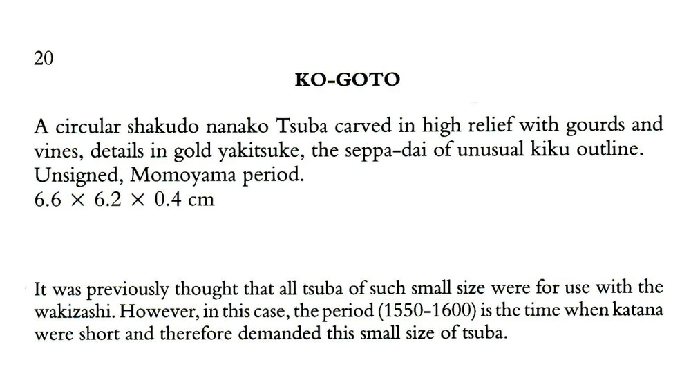

My friend's Piers question about the wavy outline was never fully answered. It is a 'seppa-dai of unusual kiku outline' already in use in Momoyama. This time I did my research a bit better and I join photographic proof even though it is of a Ko-Goto tsuba.

sporting of you to jump in. :D I'd be more than happy to examine the piece....and restrain myself from removing the offending part even ;) My opinion ought not to be taken as the final judgement but what I can do is examine and photograph the piece under very high magnification which will, at least, tell us quite a bit about the manufacturing of the steel.

If I would trust anyone's kodogu forensics on this board, it would be Ford's. I do disagree with him now and then, but Higo has rarely been my cup of tea. His knowledge of it most certainly exceeds mine. Other than Ford and Ito-san, there is one other on this board that I know can make a better judgement on this than me. I am not sure if Michael Cox is available at the moment, but he has quickly become a Higo encyclopedia and has hit me as being particularly good with Nishigaki.
Ford: The nidai put the wavy line on this tsuba? My biggest tsuba purchase of the past year was a nidai Kanshiro . What surprised me most about it is how obsessive he was with a very very fine chisel. It made me go back through the Ito-san books and look at the nidai works over and over again. This is not to say that I've had many nidai works to study, and he certainly has worked with a variety of carving as some of his wave tsuba can illustrate..... but he seems to have had a bit of Obsessive disorder in that everything has to be just so. The wavy line just does not seem to me like something he would do.

With regard to that "offending" line :D ; I would be hesitant to judge it yet as the apparent delicacy, or lack thereof, of chiselled lines can be hugely effected by grime and rust build up. Also, I get a slight impression this is not just an inscribed line but that there is a subtle height difference from seppa-dai area down. The actual line itself though, is not uncontrolled nor accidental at all. It's quite skilfully done in such a way as to appear effortless or unconcerned...imo anyway.
We'll see what further investigation and analysis can show us. This may turn out quite interesting.
