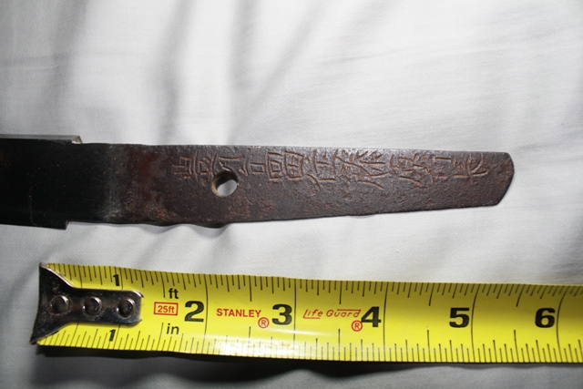

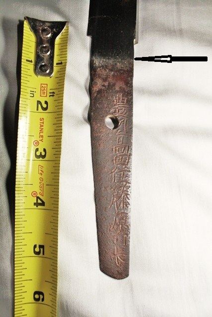

...I don't want to be paranoid...just noticed the darker area between the blade and the nakago....but I haven't seen what a add-on nakago looks like....just getting educated...

i can see what you mean about the nakago, it does seem a bit strange, but i don't see the upside of adding a tang from a Bungo sword, the Japanese did not think that highly of Bungo blades (do we rememeber Milt ), anyway, look closely at the nakago between the mei and blade, if it seems natural i am sure it is fine, if there is evidence of welding you should see it.
If you welded on a nakago, you'd screw up the hamon at hamachi - steel conducts heat and you're talking about melting steel at the welding site. That's with modern welding techniques. If you were forge-welding it, you'd have to raise both bits to white sparking heat - even more damage to the hamon - and bang it with a hammer. Chances are high in both cases that you'd have to do a bit of file work to get the surface of the weld flat with the surrounding metal. Draw your own conclusions.
Kevin
Doesn't mean it cant be done there is a failry definitive "line" on the nakago - welding and tang repatination is an art as well as a science. :dunno:
the Japanese can be quite "set in their ways" and the "traditional thinking" is the Bizen, Soshu, Awataguchi, and other groups are "art swords" and prized and Bungo, Kanabo and some other groups are "utilitarian" or to be used, not appreciated (as much as others). Not to say that is acurate as i have seen some nice Bungo swords.
I saw a line like that once, and found that it was from a non-traditionally trained, backyard polisher. He was hitting his stones against a masking barrier, creating a line. Not saying that is a cheap polish, but it could be a reason for the line.

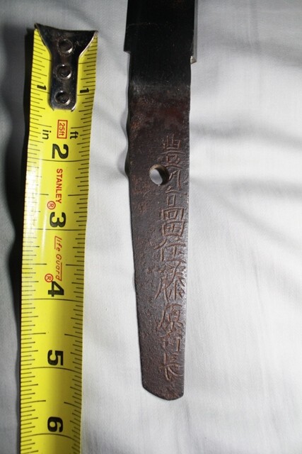

I received it and it's heaps better than I hoped....and I know now why you love these blades....cutting edge over 50cm wide blade and beefy as with no flaws (small surface scratches in approx 1x1cm at the point that is all) thought you might like some pics...
