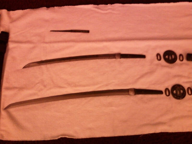

I am still relatively new to the Nihonto collecting world so please forgive me if this is a stupid question.
I have two swords that have a cutting edge of exactly 23.6 inches in length. I have heard that there was a time in Japanese history where the katana had a standard length of 23.6 inches and was later increased to 27 or 28 inches. Is this right? Others have told me that they are wakizashi's but i did not think wakizashi's were that long. Any help would be appreciated

It's a Daisho?
Yes. The Longer sword that is 23.6 inches has a companion Wakizashi that has an 18 inch blade. So that is what makes me think it was worn as a katana, but not everyone seems to classify it as such. Both swords have matching fittings.

May we see some pics?

interesting. That is pretty much what i thought. Probably intended for one handed use. I will try to get some pics uploaded for you to see.

Black-Hat (if I may call you that)
Though we cannot see the kojiri on the longer of the two swords it seems pretty obvious that this is the Dai for your Dai-sho and is a Katana, whatever the length.
Some things to keep in mind;
1.most folks were not that tall and their hands were only so big. Thus shorter katana like yours are not so uncommon.
2.the koshirae often makes the sword; a mumei blade in original tachi mounts would be referred to as a tachi. a mumei blade say 26-28 inches and not of great age would be called a katana for lack of other evidence. A tanto could be put into wakizashi mounts then it would be a wakizashi until you were looking at the blade alone. You can see yari mounted as katana and other examples of things like this. Therefore you need to learn to recognize length and blade geometry as indicators of how it might have been used if there is only shirasaya. Length is not the only criteria though.
3.Dai-sho are more an Edo period thing. So while your blade may have been a katate-uchigatana when made the longer handle suggests two handed use as you point out.
4.Katate-uchigatana not only had the short nakago but also had shorter handles, any sword though can be used for a katate-uchi strike...
Also I hope someone will tell the SFI folks that "Katte-uchi" sounds like mumbling and not a contraction of Katate - not a commonly used one anyway.
-t
PS it looks like your set is original and that sir is pretty rare, size not being everything ;)

Sounds pretty good to me. It is the only true original Daisho that i have ever found so i also thought it was quite rare. A persons height did occur to me as well because it seemed small for someone of my height(6'3). The Koshirae was my biggest thing on classifying it as a katana, so that helps too.
Thanks everyone for all the help! Any more comments would be greatly appreciated as well
