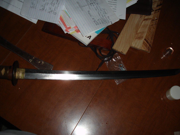

Andy - please post pics of the sword, including one or two of the tsuka. That will in answering your question about removing it. Also, you can search the forum and probably find the answer(s) to your question about removing the tsuka and maintaining the sword.
