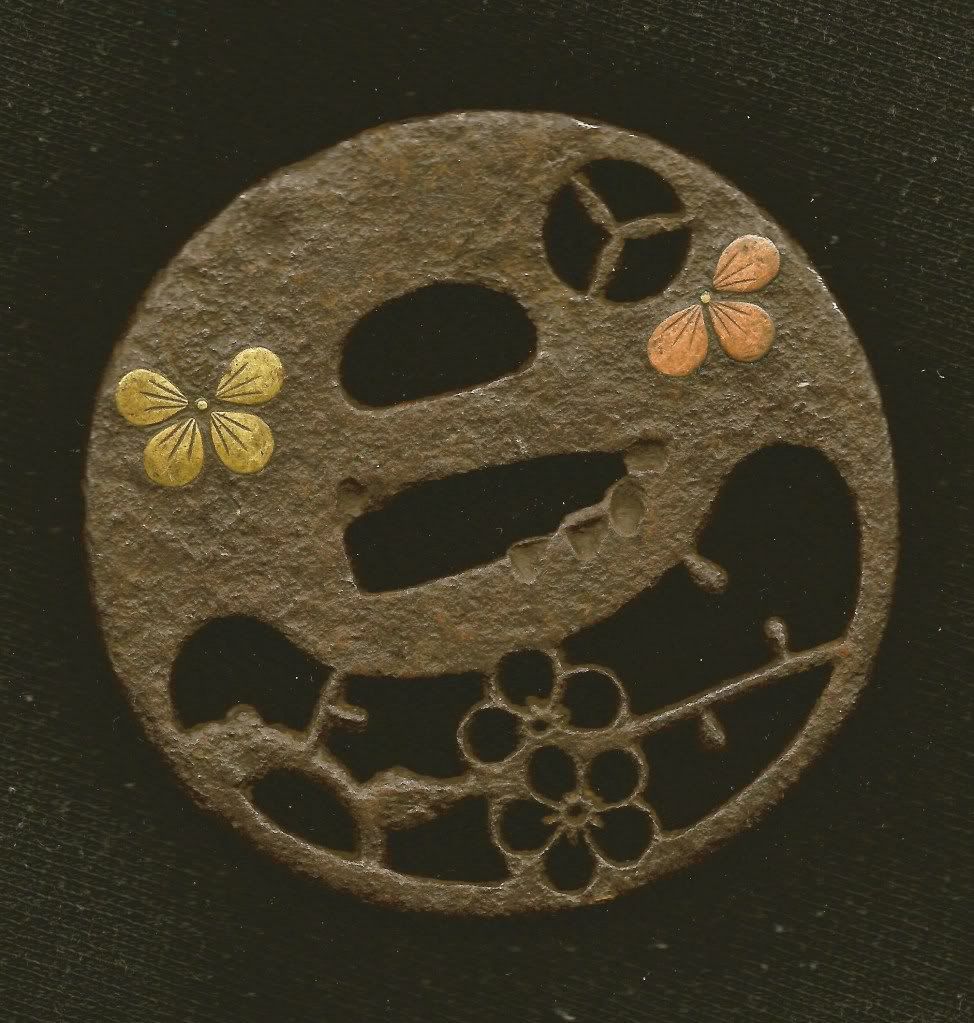

Give me your opinions on dates, and schools on this new tsub

Hi Jay,
Like the guys have said.
Great scans! :clap: not hard to see the damage of age, and sitting in the shed?
I do like the tsuba though. At one time, it must have been very nice. Seems like a good job was done on that inlay, to survive all these years of rust.
I think Jason is getting a clue about slowing down a bit.
We can all remember that passion! ;)
Hope to see you soon, for some study bro. :)
Mark G
I am actually quite fond of this one. It may have some wear but the patina is thick, and no red rust. That inlay is great and it seems to have had a lot of iron work done to it. I am still curious about what school or periods would have made a tsuba like this?
Jason.
Everybody is tippy toeing around this, so I'll simply make the statement.
If you are fond of this tsuba, thats fine. However, there is a difference between patina and rust. What you have on this guard is rust. There is no 'patina' as such that looks like rust. There is a patina that comes from very old oxidisation but it doesnt look like this.
On a close look, you can see where one of the flower petals inlay has fallen out. Unless my eyes are playing tricks, you can still see the outline of the petal in the iron.
I would think that it is likely a mid Edo, or later period tsuba. There were dozens of schools that worked in Sukashi. Less that added inlay. It is a very common theme. I look forward to seeing it in person Jason.
