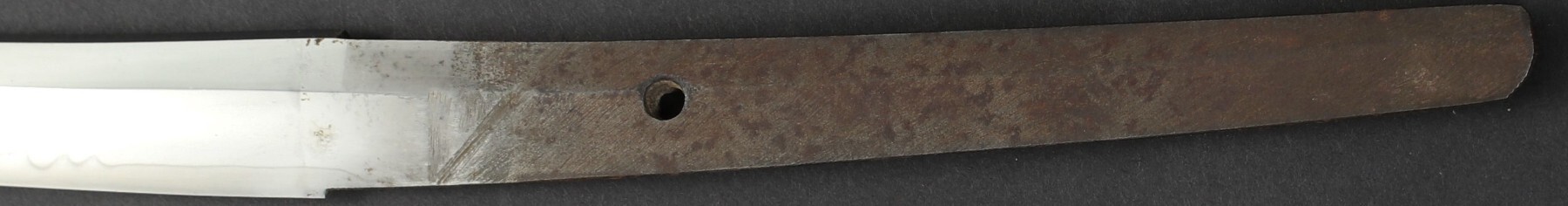

KKCook Posted August 25 Report Posted August 25 Hello All, I have come across a WW2 era Gunto Katana in a rare scabbard (according to a book I found) but the tang is unsigned. Was this common? Also the retaining pin hole appears to be punched instead of drilled. I've uploaded a few photos. Any insight would be very much appreciated. Kevin 2 Quote

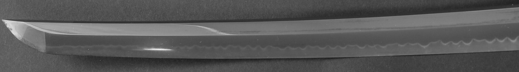

Ray Singer Posted August 25 Report Posted August 25 As far as the blade being unsigned, that is not unusual and it appears the blade is a oil quenched showato arsenal blade (with togari-gunome hamon). 2 Quote

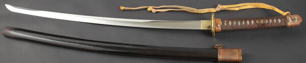

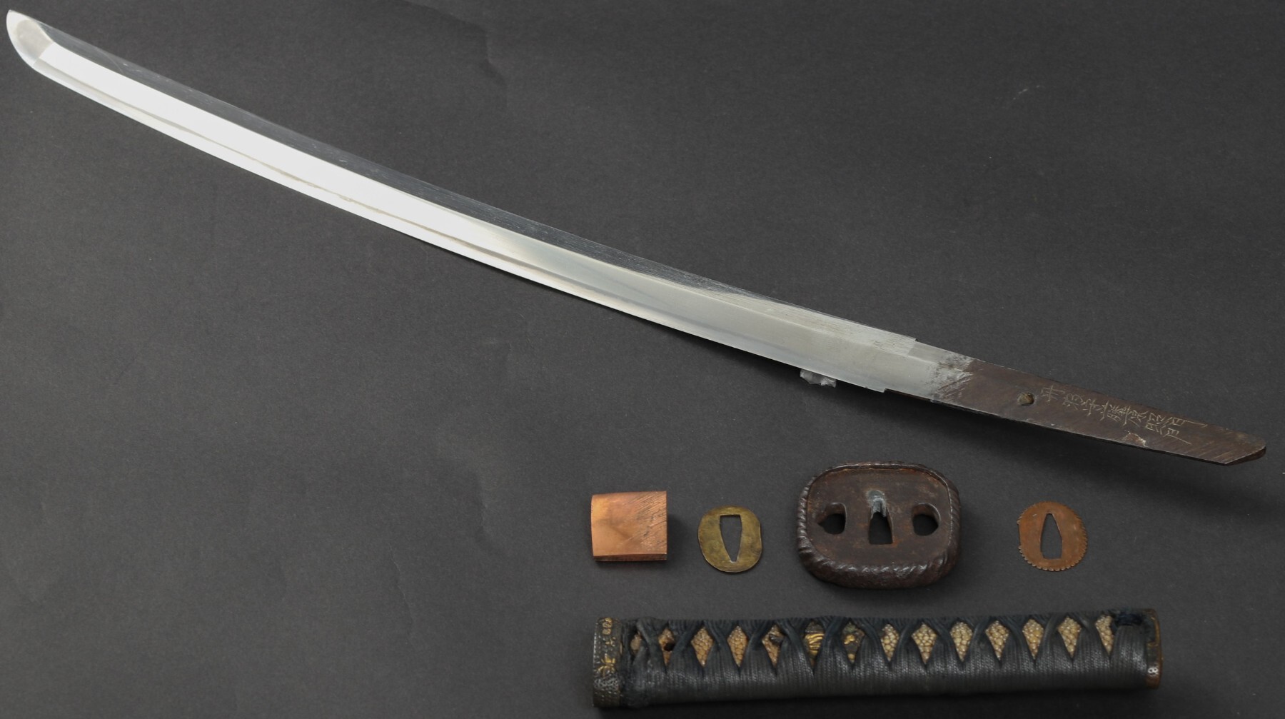

KKCook Posted August 25 Author Report Posted August 25 Thank you, Ray. I already have one seki marked Shin Gunto with an oil quenched blade so I'm now looking for traditional water quenched example for my collection. I believe the one pictured below is, and it is signed. Quote
ROKUJURO Posted August 25 Report Posted August 25 Kevin, the signatures are chiseled and read vertically blade-tip upwards, so orienting the images accordingly makes reading easier. This one is possibly TANBA no KAMI FUJIWARA TERUKADO. (Corrected following Jan's post) 2 Quote
xiayang Posted August 25 Report Posted August 25 34 minutes ago, ROKUJURO said: This one is possibly TANGO no KAMI FUJIWARA KANEKADO. Minor correction: it's 丹波守藤原照門 = Tanba no Kami Fujiwara Terukado 2 1 Quote

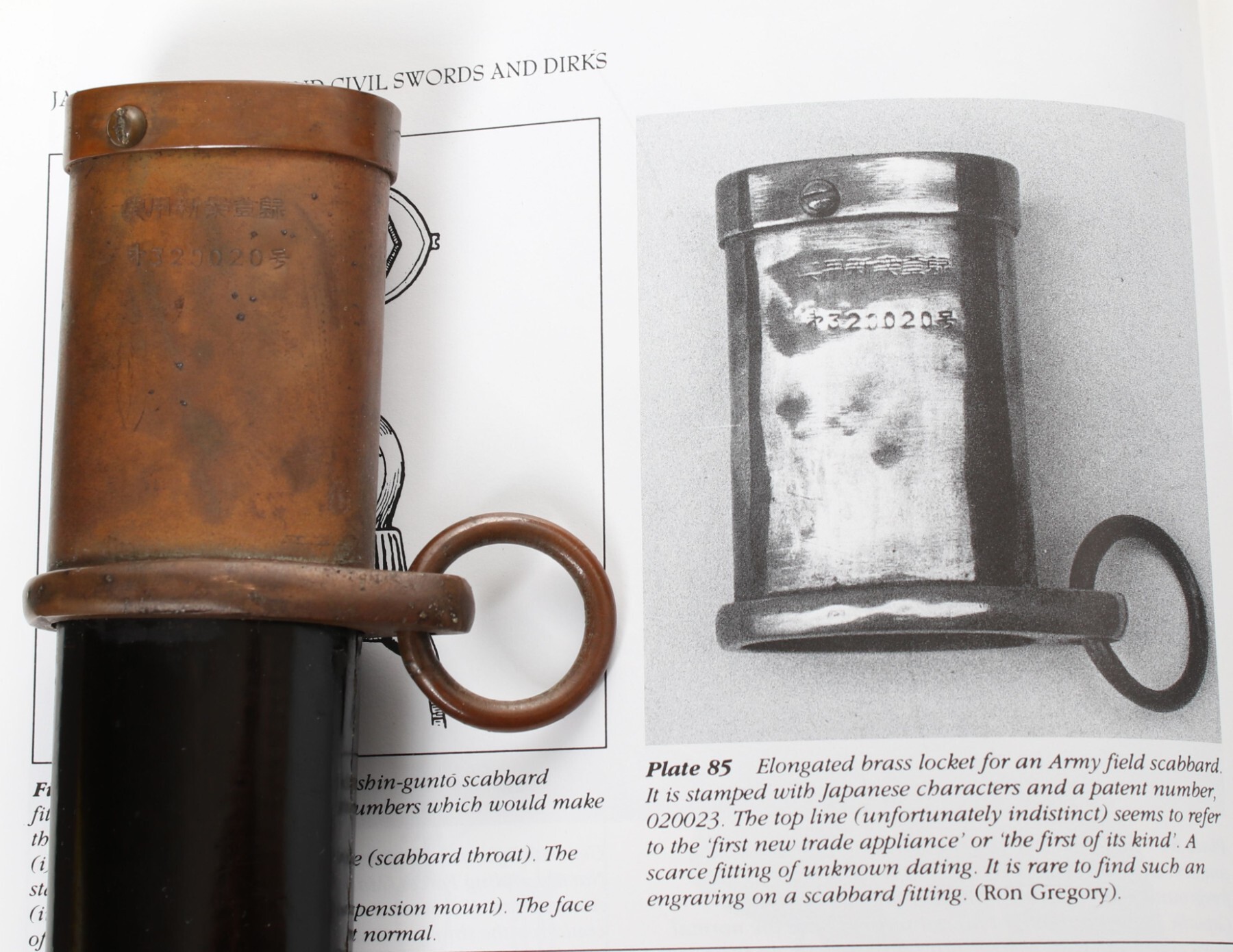

BANGBANGSAN Posted August 26 Report Posted August 26 Same sword- 実用新案登録第320020号 Registered Utility Model Registration No. 320020 2 Quote
Bruce Pennington Posted August 26 Report Posted August 26 2 hours ago, BANGBANGSAN said: Same sword Thanks Trystan! I've edited my post. Quote
KKCook Posted Wednesday at 05:44 PM Author Report Posted Wednesday at 05:44 PM Definitely appears to be the same sword. Thank you for all of the info, I'm likely going to pass on both. Quote
