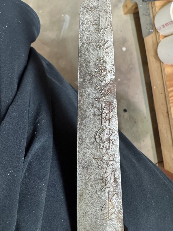

drowe98 Posted Saturday at 08:59 PM Report Posted Saturday at 08:59 PM Hello all, I’m hoping for help identifying and translating the signature on a sword my grandfather brought back from the Pacific theater in WWII. He took it from a Japanese officer during combat. It’s been in the family since, largely undisturbed, and I recently removed the tsuka for the first time to check the tang. What I’m hoping to learn: • A translation/reading of the mei (smith name, province, date if present) • Any thoughts on rank/unit based on the fittings and sword knot • General authenticity assessment (older blade in military mounts vs. wartime-made blade) Details: • Full mei on the tang, approximately 8-10 characters, last character appears to be 作 (saku) • Single mekugi, screw-type rather than bamboo peg • Tsuba: brass/gilt, scalloped edge, carved sakura (cherry blossom) motifs • Kashira/fuchi: matching sakura design, genuine same under the ito wrap • Sword knot (tō-himo): brown and blue braided cord — my understanding is this indicates field-grade officer rank, but I’d appreciate confirmation • Kurikata: carved animal-head design on the saya • Blade appears clean, no active rust, good polish Photos attached: full tang inscription, tsuba, kashira/sarute, kurikata, and the full mounted sword. I haven’t cleaned or altered the tang and don’t plan to. Any help — even a partial reading or general era/school assessment — would mean a lot, given the family history attached to this piece. Thank you in advance. Quote

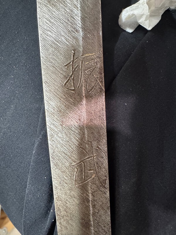

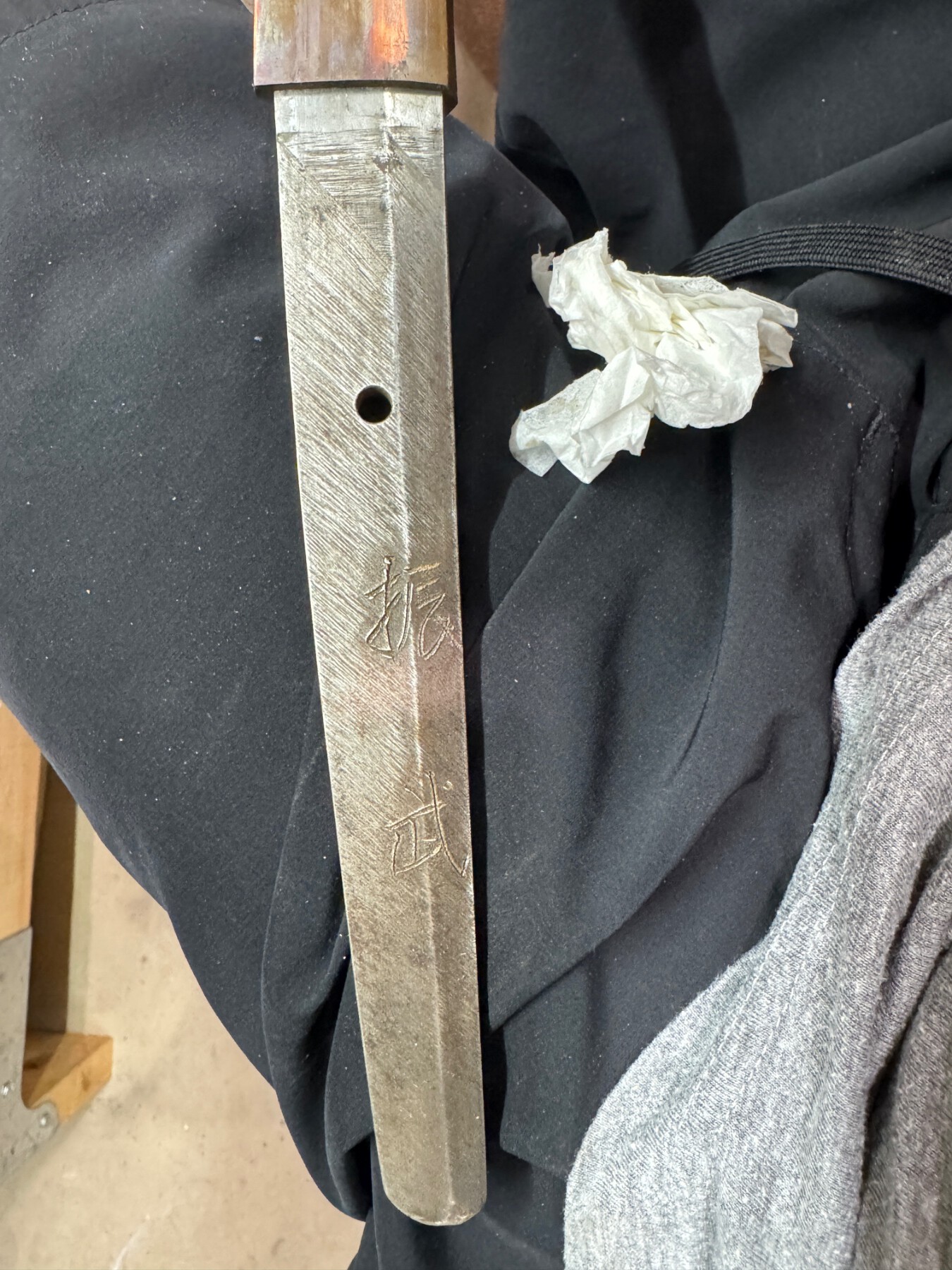

SteveM Posted Saturday at 10:19 PM Report Posted Saturday at 10:19 PM Two characters on the front: 振武 (Shinbu. Kind of a brand name) Nine characters on the reverse: 東洋刃物株式会社作 (Tōyō Hamono Kabushikikaisha-saku. "Made by Tōyō Blade Ltd. Inc.") This is a sword made with special cold-resistant steel, particularly for use in Manchuria and North China. I think it is a bit rare. You can read about it here (English at the bottom of the page). Mr. Ohmura, the author of that site, used some old English translation software to translate his text into English, and the end result isn't as great as what you can get from Google translate or AI nowadays, so you might want to run the whole body of text through an online translator to get a better translation. http://ohmura-study.net/207.html 7 1 Quote
Nobody Posted Saturday at 11:46 PM Report Posted Saturday at 11:46 PM As a side note, “東洋刃物株式會社” is a proper noun, and it has a specific English name. 東洋刃物株式會社 – Toyo Knife Co., Ltd. Ref. TOYO KNIFE CO., LTD. 4 2 1 Quote
PNSSHOGUN Posted Sunday at 03:19 AM Report Posted Sunday at 03:19 AM These are rather uncommon, it's possible the Japanese officer originally served in China. As an aside, the order of the seppa is incorrect, there should be three of equal size on each side of the Tsuba. 1 Quote
