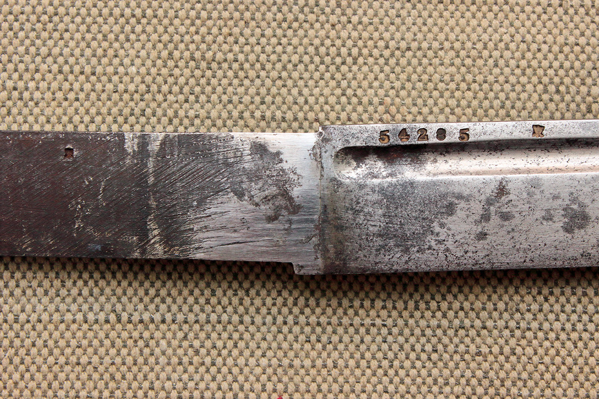

Did you happen to take any photos of the nakago when all the fittings are removed? Those of us who would never dare to disassemble a Type 95 for fear of it not going back together the same, like to see these types of pictures. It should have a 東 “To” stamp.
  • Love 1
Indeed, would love to see the nakago for my notes.
Many nakago I have seen on Variation#3 swords are not stamped; so do not worry if yours is unmarked. Although, every Variation#1 copper nakago that I have seen has the 東 stamp.

Sure, there they are. Nakago is stamped with  東 “To” stamp and also has number 2 stamped on mune side.
  • Love 2
Fascinating, thank you for sharing those.
A couple firsts for me! Never seen a number on the nakago-mune, or paint like that.
Very interesting,
-Sam
  • Love 1

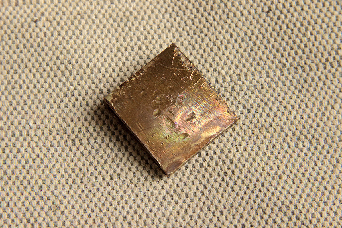

Next part might be a bit controversial, but I had to do it. The only thing I didn't like about this sword was habaki. Someone at some stage tried to remove tsuka. This person unscrewed the mekugi nut, removed the mekugi bolt and tried to pull tsuka off. The hatome was still in its place, so no wonder the attempt was unsuccessful.  So this person just tried to pry tsuka off and put something metall and sharp  between habaki and foremost seppa. Some hammering was applied too. Seppa was lucky enough to get away with only minor scratches while habaki received a lot of damage.
And if it was only about scratches, I could put up with them. However,  I couldn't stand those  unnatural vivid colours habake was featuring. Either someone applied the heat to it (yet I found no signs of heat on other components or tsuka wooden core) or these colours are the result of some chemicals applied to cover fresh scratches.
There was no way to remove those scratches and dents without altering habaki greatly. So I only removed protruding ridges with a small file. I was careful and I was working only along the lines of the original habaki finish. Then I put some patina on habaki. What I learned from working on WWI brass belt buckles is that there are  no two brass alloys alike when it comes to reaction to "aging" chemicals.  Therefore they all have to be treated differently and with great care. I believe I have more or less succeeded with the aging of this habaki.
