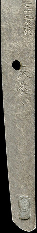

Bruno Posted April 17 Report Posted April 17 (edited) Hello, Posting here on behalf of a friend. It has inscriptions on the blade, nakago and shirasaya. Any help with translation would be greatly appreciated. Thank you very much. Edited April 17 by Bruno 1 1 Quote
ROKUJURO Posted April 17 Report Posted April 17 Hi Bruno, interesting KIRI HA ZUKURI blade, signed AMAHIDE. You have already been interested in AMAHIDE in 2012, but this blade looks older than WW II to me. As you may know, date and smith's name are chiseled and read vertically, so it is a great help to orient especially the NAKAGO images accordingly. The NENKI is not quite clear to me. It looks a bit like ANSEI 7 but that would not make much sense, so I don't know. 1 Quote

oli Posted April 17 Report Posted April 17 AMAHIDE (天秀), Bunsei (文政, 1818-1830), Musashi – “Amahide” (天秀), “Suishin´ō Amahide” (水心翁天秀), “Suishin-rō Amahide” (水心老天秀), “Suishinshi-rō Amahide” (水心子老天秀), this was the name of Suishinshi Masahide (水心子正秀) with which he signed from the first year Bunsei onwards after giving the name “Masahide” to his son Sadahide (貞秀), it is said that this name actually reads “Masahide” (天秀) and not “Amahide,” in other words, he kept the reading of his name but changed one character Big name.....interesting blade 1 Quote
SteveM Posted April 17 Report Posted April 17 刀剱造法其理明而不畏古之冶工雖然亦不侮是唯以鍛錬去 鈍滓全鐵氣而不泥刄文陰陽相和鉾刄清利難折難撓無所疑 According to the site below, the meaning is: The principles of swordsmithing are well understood, and although I do not believe it is impossible to surpass the old masters, I cannot say that I am better than them. The most important thing in swordmaking is to continue forging (folding) the steel until all the impurities are removed, preserving the essence of the iron, and to not become preoccupied with the shape of the hamon. The blade will become pure and sharp when the yin and yang are in harmony, and it will doubtless become difficult to break, and resistant to bending. https://www.touken-world.jp/search/38586/ 7 1 2 Quote

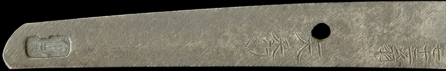

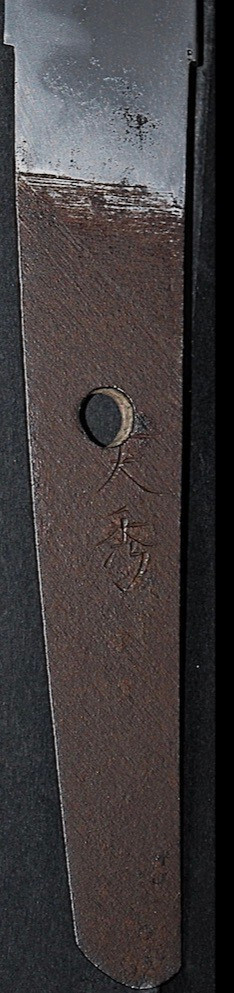

lavigne Posted April 19 Report Posted April 19 Hello, I've named this wakizashi "testamentary blade." The nakago (handguard) is signed and dated, as is the shirasaya (handguard). Ama Hide, 8th month of Bunsei 7. Suishinshi Masa Hide passed away on the 27th day of the 9th month of Bunsei 8. Here is a modern translation of the engraved text: The principle of sword making is clear, and I am not afraid to measure myself against the swordsmiths of old, but that doesn't mean I despise them. This art simply consists of bringing the iron to a perfect state by eliminating impurities through forging, and there's no point in obsessing over the temper line (the hamon). There is no doubt that the harmony of Yin and Yang makes the blade pure and sharp, and difficult to break. I've attached another photo found online of his signature, Ama Hide, placed in the same spot and truncated by the mekugi ana (handguard). It would be interesting to learn why he made this (these) blade(s).. 1 Quote
ROKUJURO Posted April 19 Report Posted April 19 Bonjour Michel, NAKAGO (= tang/la soie) photos should be oriented straight vertically (blade-tip upwards), so a signature can be read. NAKAGO, SHIRA-SAYA, and MEKUGI-ANA are not handguards; you got something mixed up. A TSUBA is a handguard. Quote
lavigne Posted April 20 Report Posted April 20 Hello Jean, thank you for the comment. However, I'm using automatic translation, so I'm not linking this translation, which added "(handguard)" on its own. I'll reiterate my question: why did Masa Hide create this wakizashi (apparently in two or three copies, to my knowledge)? Here is the mei (dark color) on my wakizashi and another mei found online (gray color) placed in practically the same position. Quote
ROKUJURO Posted April 20 Report Posted April 20 Michel, one of our experts will tell you more about it, but generally said: It is easier to fake a signature than a blade, so in comparing your sword with a certified example, you have to look at the work itself. All features of a blade have to be considered, and the MEI (signature) is the last factor of evidence. A "good" faker would perhaps have had an original at hand to copy, but many just had an OSHIGATA (if at all) as template. Quote
