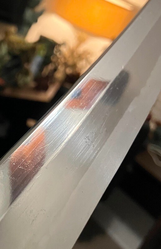

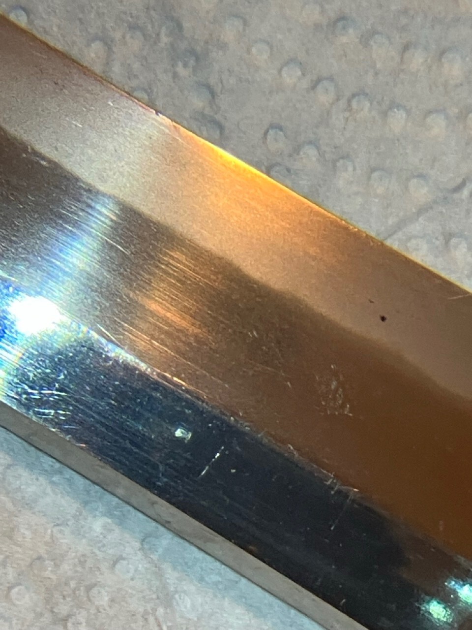

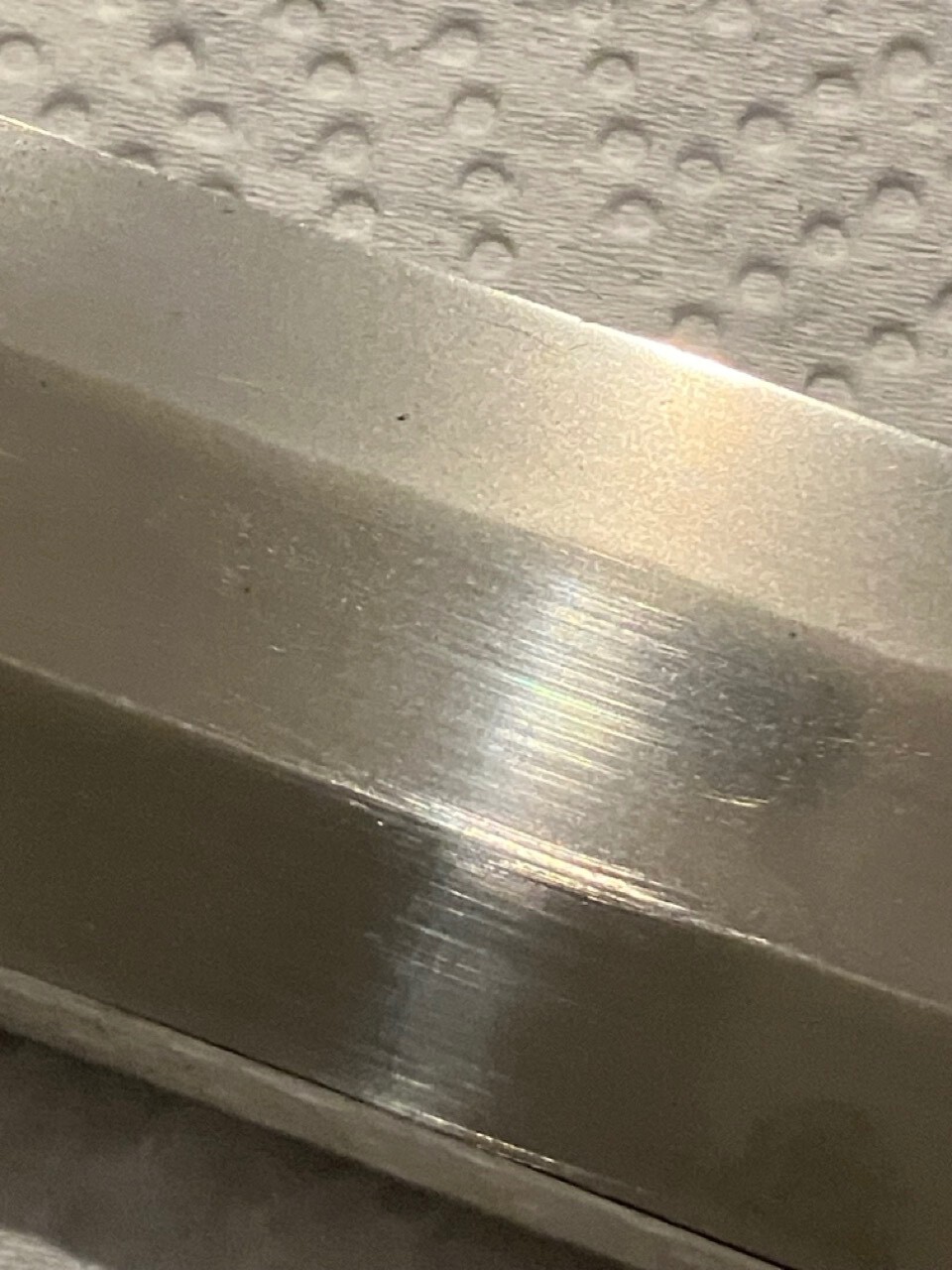

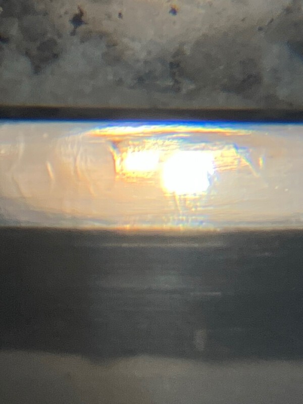

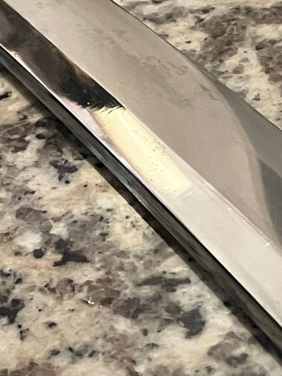

Jnuzzo Posted February 22 Report Posted February 22 Noob to nihonto, and not fully understanding what causes a ripple effect of a mirror polished ji in certain light? I get that the folding could give you waves, but wouldn’t the polishing take that out? … or does differential hardening remain as a slight topological pattern on the ji post-polish? Sorry if it’s a dumb question, I just don’t want to self-educate incorrectly so I thought I’d ask you guys. Photos aren’t great but should give you an idea of what I’m talking about. thx, Jeff Quote
Shugyosha Posted February 22 Report Posted February 22 Hi Jeff, They may be caused by a bent blade having been straightened and are called shinae. https://www.japaneseswordindex.com/kizu.htm 5 1 Quote
Jnuzzo Posted February 22 Author Report Posted February 22 6 minutes ago, Shugyosha said: Hi Jeff, They may be caused by a bent blade having been straightened and are called shinae. https://www.japaneseswordindex.com/kizu.htm That makes perfect sense, thank you! And thanks for the link. I’m guessing when it’s on both sides of the blade it could stem from the forging or tempering bend in that axis? Quote
Jnuzzo Posted February 22 Author Report Posted February 22 (edited) 8 minutes ago, Jnuzzo said: That makes perfect sense, thank you! And thanks for the link. I’m guessing when it’s on both sides of the blade it could stem from the forging or tempering bend in that axis? Knowing the terminology really helps with knowing what to search for, thx again! Edited February 22 by Jnuzzo Quote

ROKUJURO Posted February 22 Report Posted February 22 SHINAE are superficial cracks in the steel after a bend on the stretched side of a blade, and of course they are not beneficial to the structural integrity of it. What we see in Jeff's blade was correctly described as ripples, and they are something quite different. They can develop when the preliminary work in a BOHI left out a stage or two of fine grinding lengthwise which is tedious work. The final polish with a MIGAKI-BO 'compresses' the surface to a very small extent, and using only a pointed MIGAKI-BO can then produce these ripples. With differently dimensioned tools, these can be avoided as you can see on many good swords. But I will add that some sword construction methods also might provoke the occurrence of these ripples. I would not consider them negative in technical hindsight at all. Looking at this feature with a microscope/high magnification will clear that up easily. 4 Quote
eternal_newbie Posted February 22 Report Posted February 22 27 minutes ago, ROKUJURO said: The final polish with a MIGAKI-BO 'compresses' the surface to a very small extent, and using only a pointed MIGAKI-BO can produce these ripples. Very interesting, thank you for the insight! Quote

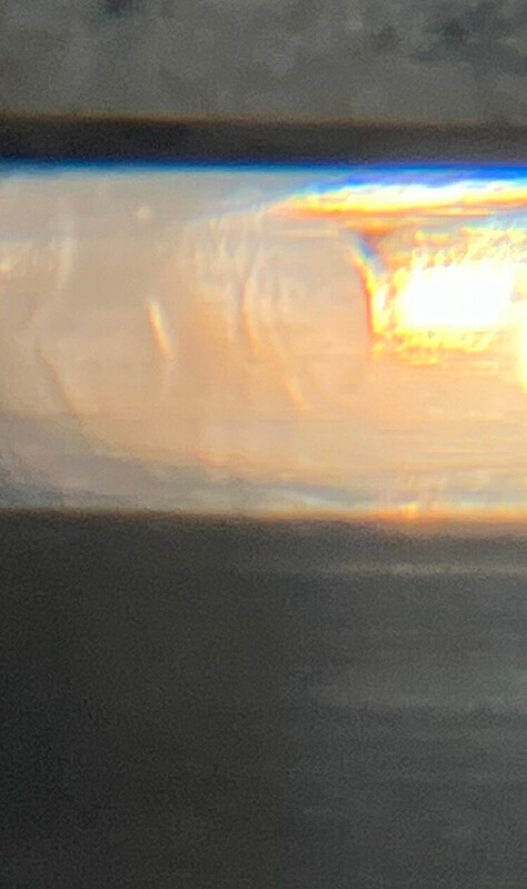

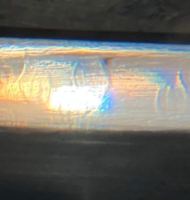

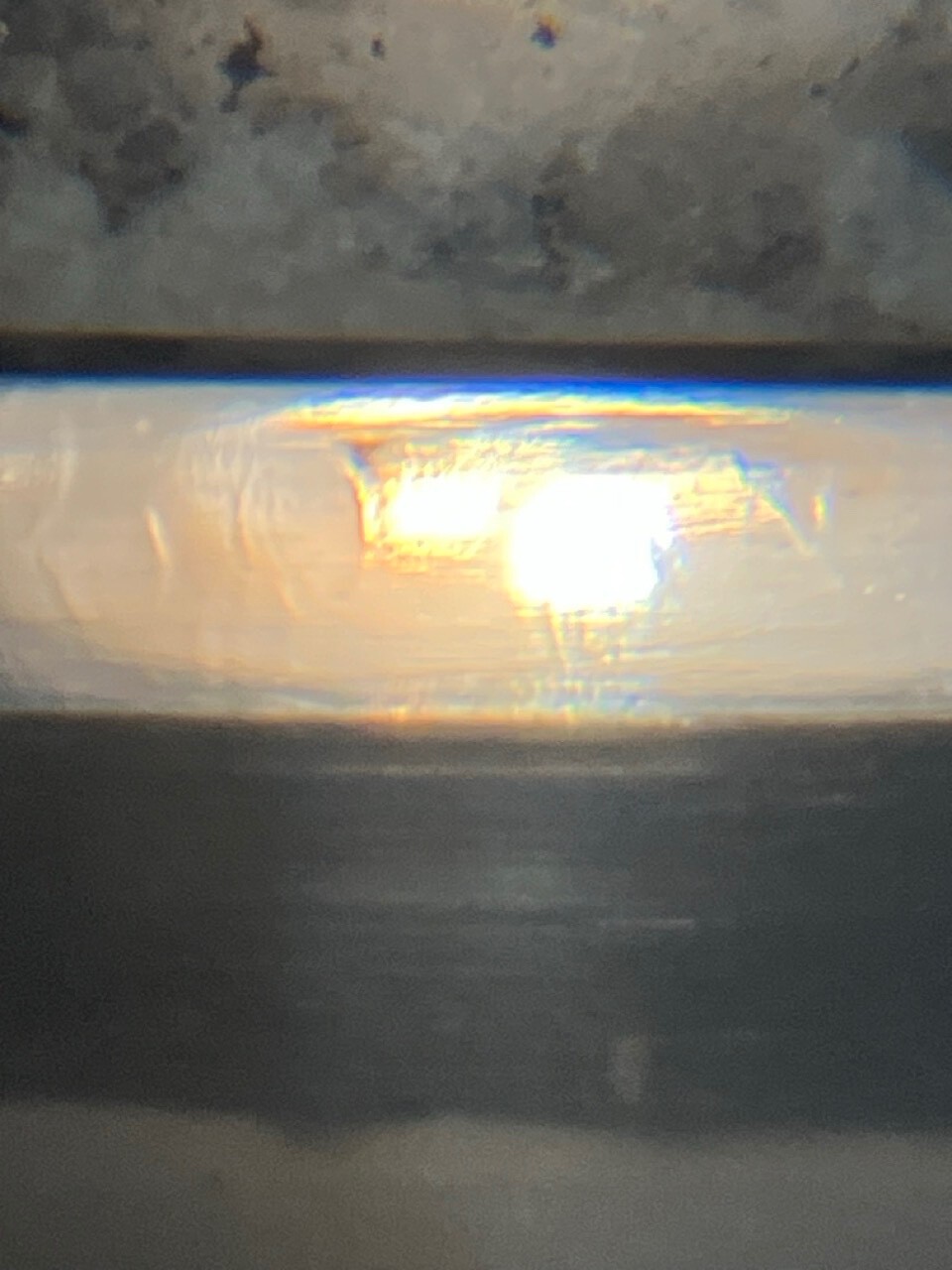

Jnuzzo Posted February 22 Author Report Posted February 22 (edited) On subject blade it’s not cracks at all, but the mukade-shinae wrinkles could be a culprit, though I’m having a tough time finding clear photo examples for comparisons. I’m finding some areas that have a rounded / circular pattern of it as well, and it looks to be somewhat present throughout the Ji on both sides of blade to varying degrees. It’s hard to clearly see even with a magnifying glass (and my eyesight lol), but I’ll get some better magnification and keep inspecting it / reading about it. Couple photos of the circular ones just for the heck of it as well as a non-magnified shot. Edited February 22 by Jnuzzo Quote
ROKUJURO Posted February 22 Report Posted February 22 Jeff, now it is clear that the phenomena are not cracks or SHINAE. I have a question to another feature: Is there a real HAMON? Even in your magnified photos I don't see traces of NIOI or NIE. What kind of blade is this? Can we see the NAKAGO please (oriented vertically tip-upwards without HABAKI). So in case this was a machine-made blade, we could suspect the SHINOGI-JI was mirror-polished with a machine which would explain the above pictured phenomena. 1 Quote
Jnuzzo Posted February 23 Author Report Posted February 23 (edited) 6 hours ago, ROKUJURO said: Jeff, now it is clear that the phenomena are not cracks or SHINAE. I have a question to another feature: Is there a real HAMON? Even in your magnified photos I don't see traces of NIOI or NIE. What kind of blade is this? Can we see the NAKAGO please (oriented vertically tip-upwards without HABAKI). So in case this was a machine-made blade, we could suspect the SHINOGI-JI was mirror-polished with a machine which would explain the above pictured phenomena. It looks like a real and active hamon to me, and looks like a hand polish as the polisher marks are there under habaki. It’s definitely a hand made blade though. The light n focus angles I had to use to try to get the shinogi-ji texture might have muddled the hamon a bit. Looks edo to me, and is an Okimasa gimei. Large and meaty, with a 29 1/4” nagasa and 1 3/8” width. I mainly grabbed it because the size was pretty cool and it had a full set of nice Kikuchi Tsunekatsu fittings with interesting properties. Really pretty mottled lacquer saya as well. WW2 trophy and pretty clean / well-kept, so I thought it would be a nice piece to learn more on (my others aren’t that great and not in good enough polish to really see the things I want to learn about). I’ll take some pics when home later tonight. Thank you for the guidance. Edited February 23 by Jnuzzo 1 Quote
Jnuzzo Posted February 23 Author Report Posted February 23 5 hours ago, ROKUJURO said: Jeff, now it is clear that the phenomena are not cracks or SHINAE. I have a question to another feature: Is there a real HAMON? Even in your magnified photos I don't see traces of NIOI or NIE. What kind of blade is this? Can we see the NAKAGO please (oriented vertically tip-upwards without HABAKI). So in case this was a machine-made blade, we could suspect the SHINOGI-JI was mirror-polished with a machine which would explain the above pictured phenomena. Photos. I’ll get better at capturing hamon in time lol. I haven’t learned enough to know what I’m talking about with hamon yet, but it looks at least true to me … 1 Quote
ROKUJURO Posted February 23 Report Posted February 23 Hi Jeff, correct, it is there. The photos are mostly bad, but they show a NIOI-based HAMON. 2 Quote
