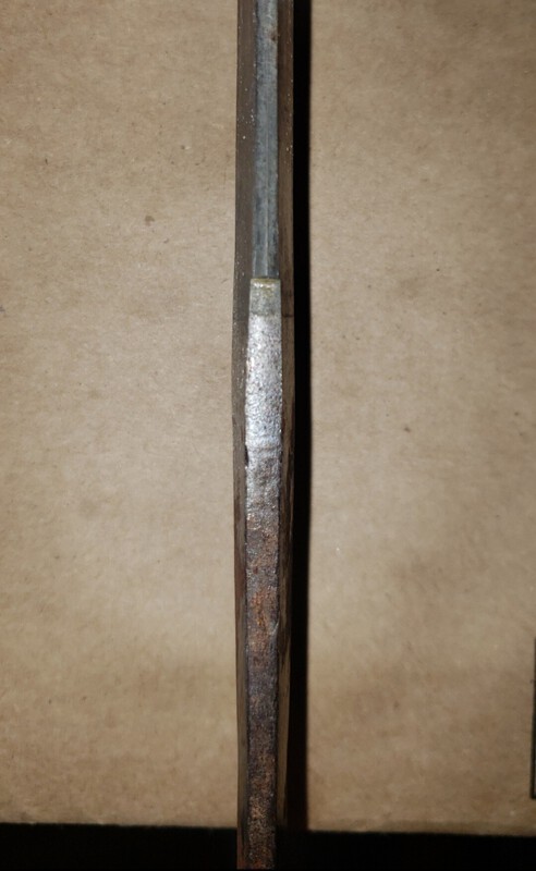

Hi everyone, here is a blade I recently picked up that I think is a naginata naoshi. The nagasa is 40cm or 16" and is 52cm or 20.5" overall. The positioning of the naginata-hi on the nakago relative to ubu naginata leads me to believe that the length we see here is possibly roughly 4"/10cm(?) shorter than when ubu, making the original nagasa possibly ~60-65cm or ~24" long - is this a fair assessment? As grain or hamon sadly can't be deciphered at all in your experience how old do you think this piece may be? Blade profile is shobu-zukuri I believe. Other than the above I think it has some lovely koshirae (although the saya is pretty battered) and the blade has quite a lot of battle scars to it, or so I believe.

I plan to send it to a togishi for proper restoration yes, how old do you think it might be if you had to give a rough ballpark? Mid/late muromachi?

I am not an expert on these, and I am only looking at images, but considering the patina of what is now the NAKAGO, and the shape, I think it might be KOTO indeed. But in this condition (in addition to the damaged edge, it has been ground/sandpapered, and I don't see the HAMON in the KISSAKI) the age does not play a role in hindsight to value (if you are thinking of that).

Here you go Jussi, measurements are on the images, hopefully this helps! Do you know why the naginata-hi may have only been on the one side?

Thank you for the measurements they clear up things to me a bit. I must say I would have thought the curvature was much stronger and blade is thinner at the (current) nakago than I thought it was. To me both of those are good things. I think you have a cool item
The hi on just one side is bit peculiar one, likewise as it seems there is not a direct profile shift near the end of hi.
This is of course the common type of profile shift that we have in naginata the mune is thick over the hi and radically tapers very soon after the hi. Picture of my Yoshikage naginata. in this the tapering is extreme going from 8,5mm on top of hi end to about 1mm on the blade portion.
Now this second type is quite uncommon but as I do have a naginata that has the gradual taper I can post a picture. This Ko-Uda naginata goes from 6mm on top of hi to 4mm on blade portion.
I think I have seen some naginata that have just horimono on one side but on top of my head I cannot remember an example that would just have a hi on one side. I like naginata as there is so much variety among them, they are very interesting. To me the majority of Japanese katana and tachi just seem nearly identical with tiny variation and it is kind of boring, then in comparison there is huge variety in polearms with all kinds of interesting forms and oddities.

Thank you Jussi for the in-depth reply! It's exciting to me there aren't any other examples you can think of with the hi only on one side! And just to be clear the measurements I took for thickness are at the mune, not the thickest part - that's more like 6 and 4mm like your ko-uda naginata. Do you think they both might be ko-uda? It's a shame it's out of polish in it's current state!
You did measure correctly on the mune. Unfortunately only guess I could dare to make is that to me it would feel like a Kotō naginata like others felt above too. If it would be in polish people who have expertise could make an identifying guesses, focusing on small details is not my forte but of course it would help in general guesses about the age.
