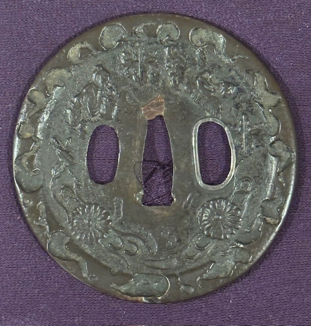

Kanenaga Posted November 24 Author Report Posted November 24 Here's the tsuba. It doesn't photograph well, if I had time I'd enhance the images. I particularly like the "rotten wood" design on the rim. 2 Quote
Iekatsu Posted November 24 Report Posted November 24 A really nice example Les, I recognise it from the DTI. There is quite a lot of variation in Kagamishi Tsuba, something I hope to write about in the future. Quote
Curran Posted November 24 Report Posted November 24 2 hours ago, Kanenaga said: So different... Yep. It is more pleasant than obvious in the photo. The patina is particularly nice. I'd rather own this one. 1 Quote
Iekatsu Posted November 25 Report Posted November 25 4 hours ago, Curran said: Yep. It is more pleasant than obvious in the photo. The patina is particularly nice. I'd rather own this one. That is an amazing example, I can see why you like it. 1 Quote

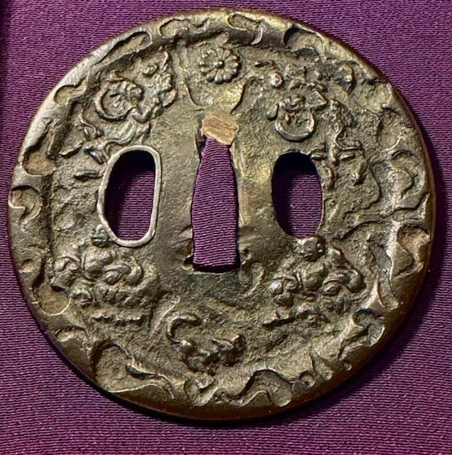

Curran Posted Wednesday at 03:28 PM Report Posted Wednesday at 03:28 PM Better images of my one example. Not sure why it rotates like that. I've always enjoyed the Korean influence and nanako on this one. I'd date it to 1600-1615? Naturally, I prefer the pre-1600s ones. The earlier the better. Those like Les' don't seem to appear very often. The last Muromachi one I saw, a few guys ended up in a bidding war at the end of the auction. Though under the radar of a lot of people, they are still very hard to catch. 2 Quote

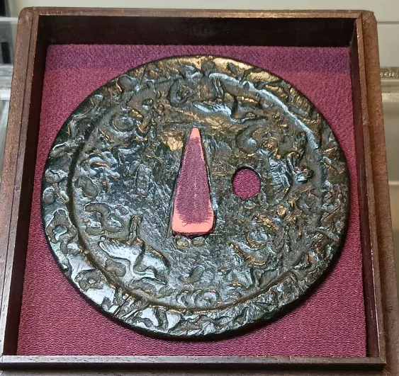

Kanenaga Posted Wednesday at 09:41 PM Author Report Posted Wednesday at 09:41 PM Took another photo of my new addition, brings out the figures more clearly. I can make out seated sages (?) at 5:00 and 8:00, a fox at 6:00, kikumon at the top, perhaps a genie figure in profile at 11:00. I cannot identify the figure at 1:00. These early tsuba are not seen very often, and I've found very little written about them (in English). There was one other at DTI, asking 1M yen. They are bronze castings, and the designs tend to be crude compared to the contemporaneous mirrors, which leads some to argue that they were likely not made by mirror-makers as the name implies. There have been prior discussions on this forum in the 2010-15 time frame, several started by Marius. 2 Quote

Iekatsu Posted Thursday at 10:53 AM Report Posted Thursday at 10:53 AM (edited) 13 hours ago, Kanenaga said: They are bronze castings, and the designs tend to be crude compared to the contemporaneous mirrors, which leads some to argue that they were likely not made by mirror-makers as the name implies. I agree, Kagami-shi is a misnomer, there is no evidence of a link to mirror makers. I have coined my own terminology to categorise this variety. It is just another NBTHK category that needs to be revised. Here is the other Kagami-shi from the DTI that you mentioned. Edited Thursday at 10:55 AM by Iekatsu 1 Quote

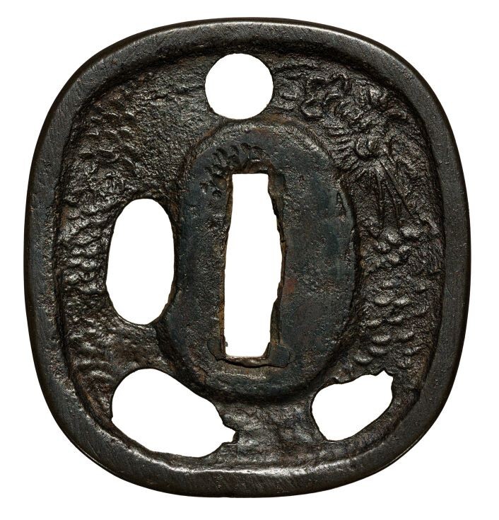

Tim Evans Posted Thursday at 11:35 AM Report Posted Thursday at 11:35 AM Here is another that is ascending and descending dragons. The plate is only about 1mm thick in spots. I think the two holes at the bottom were casting flaws modified to look like bottles. I see some similarities to #10 in Sasano's book. 2 Quote
