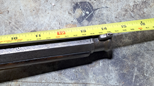

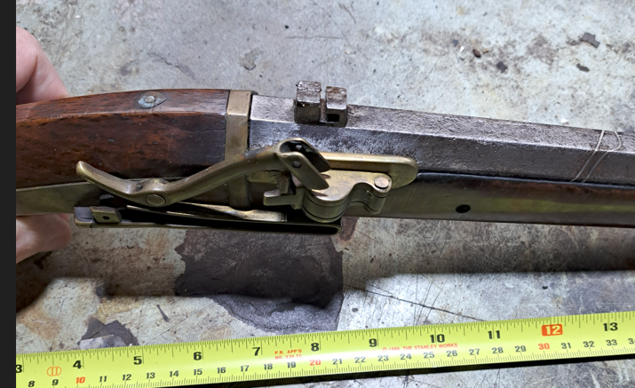

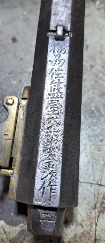

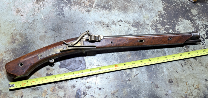

Kmad Posted October 19, 2025 Report Posted October 19, 2025 Hi All, I never saw a Teppo for sale in Ireland before so I decided to but this one, paid just under 500 dollars which hopefully is an OK price? Came out the gun collection of one of General D Mac Arthurs staff who had a castle in Ireland, Col Sean O Driscoll was the officers name. The gun collection was siezed by the Irish police on his death in the 90's and only sold a few weeks ago. I know absolutely nothing about this gun so I would be very much obliged if someone could tell me anything about it, calibre is 15cm so around 5/8 of an inch overall length 23 inches and barrel is 14 inches. I have attached a picture of the writing on the barrel so can anything be told about where and when it was made and would this be a military gun or civilian? Best regards Ken 2 1 Quote
Brian Posted October 19, 2025 Report Posted October 19, 2025 Hmm. Pistols are considerably more sought after than long guns, and this one appears correct and not shortened. I think that's a great deal. 1 Quote

Bugyotsuji Posted October 20, 2025 Report Posted October 20, 2025 Yes, agreeing with Brian. Super űber crazy cheap for a ‘bajōzutsu’ carbine pistol like that! Lucky 🍀 find! This was made by a smith in the House of Kagoya in Sesshū (Sakai, Osaka). Mid to late Edo period. (We have a hand cannon from the same collection.) 2 Quote
Bugyotsuji Posted October 20, 2025 Report Posted October 20, 2025 PS the name is corroded, but I’ll work on getting the smith’s personal name. 1 Quote
Bugyotsuji Posted October 20, 2025 Report Posted October 20, 2025 Yes, it says: ‘Sesshū Jū Kagoya Rokubei Kanetsugu Saku’ 摂州住籠谷六兵衛金次作 Sadly no dates given for this smith, but Edo period for sure. 1 Quote
Kmad Posted October 20, 2025 Author Report Posted October 20, 2025 Many thanks for the information Piers I got a rifle also in the same auction but have yet to get the pins out to remove the barrel. I was more attracted to the rifle but decided to pick up the pistol/Carbine while i had the chance, can i assume that the lack of decoration and relatively large caliber indicates this is a military item as opposed to civilian? Kind regards and as usual I will update my gold membership as a thanks for the information pay back, I drop in here whenever I need info on a purchase and don't contribute any knowledge so I might as well pay for the pleasure. Regards Ken 1 Quote
Bugyotsuji Posted October 20, 2025 Report Posted October 20, 2025 Ken, military, yes. Once again, congratulations! Several of the byō 鋲 pins, (or ‘nails’ as they are called in English gunsmithing, apparently) are missing and will need replacing. Almost everything else seems to be present. When you say ‘rifle’ you may be referring to a Tanegashima Hinawajū smoothbore long gun. (?) They didn’t get any true rifles until the Bakumatsu period, from abroad. Quote
Kmad Posted October 20, 2025 Author Report Posted October 20, 2025 Hi Piers, The byo are present I just took them out of the bajōzutsu when taking the pictures Mechanism works perfect and the timber has no cracks or bits missing overall in v v good condition I think. Sorry yes I meant a smoothbore long gun (not a rifle) some nice decoration on it Ill get some pictures in the next week or so once i remove the byo I just made the 30 $ payment to Brian but it is on you and thanks again. I am not selling but approx what sort of money would this go for as a matter of interest Regards Ken 1 Quote
