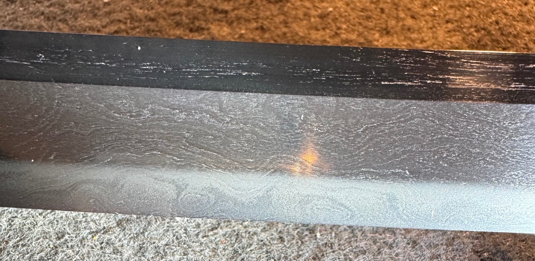

Toki Posted Wednesday at 10:22 PM Report Posted Wednesday at 10:22 PM Hello everyone :D As mentioned in my previous post, I had the pleasure to receive my first Nihonto last week. It´s been bringing me so much joy and motivation to learn more about those beautiful pieces of art. Naturally, as a hobby photographer, I always wanted to try taking pictures of them and now that I got a blade of my own, I can finally try my luck. It is a whole new field of photography for me, one that I am, quite frankly, unprepared for. Usually I shoot Landscape and Nature, with the occasional plane spotting trip to nearby military air bases. Macro photography however is completly new to me and my lacking equipment (I don´t even own a tripod. Foolish, I know). Reading all the resources and past posts here on Nihonto Message Board, especially Darcy`s PDF file about this topic, really helped me getting started and giving me a rough idea what to do and what to avoid. While it´s not exactly the setup mentioned in that article, I tried to copy it with what I had. I went with the following setup (will leave a picture below). For the enviroment I used the wooden box usually used for painting model planes with an airbrush. I hung up some dark cloth in it to have a proper background and placed a daylight LED-Panel on the Plexiglass roof of the box for the lighting. I used a secondary lamp for some diffusing background lighting and to set accents in the pictures. Since I do not own a tripod, the camera was fixed to a music stand using a cable tie. For the camera I used a Sony a6400 with the Tamron 17-70mm f2.8 lens. I chose it over the Sigma 30mm f1.4 for its lower minimum focus distance of 0.19m at wide angle of 17mm (~25mm if we take the 1.5x factor for APS-C into account) and 0.39m at maximum focal lenght. In terms of settings I chose a focal lenght of 25mm and apeture of F4.5 since I found that as a sweetspot where it is the sharpest in the past. I wanted to keep the ISO at 100, even though the a6400 has good noise control up until around 1600 ISO, as I worried it would interfere with the Hada and other details in the blade. Shutter was set at 1/15s since I was shooting on a stationary position anyways and not handheld. Personally, I would say for the second try ever at this the pictures are quite okay. Compared to the pictures in the last post I find the current ones a big upgrade. I found a big spot without Hada which I suspect is core steel (marked in red, correct me if I am wrong) that I somehow overlooked when inspecting it at the shop. Also, some little rustspots, scratches, and a few nicks in the mune, but I was already aware of those as the seller mentioned them in the listing. Overall, I find the blade quite nice to look despite those things listed. I will post a few of the better pictures below. All the pictures are cropped and compressed to JPG so I can do them all at once. If anyone wants the full sized ones, let me know. Also, any tips for better pictures are of course welcome! Thank you for listening my Ted Talk Have a nice day/night everyone 1 Quote
Mikaveli Posted Wednesday at 11:10 PM Report Posted Wednesday at 11:10 PM Try some incandescent light sources, as well as LED and fluorescent lights. (Auto) Focus can be tough - but looks like you've handled that well. 1 Quote
Toki Posted Wednesday at 11:20 PM Author Report Posted Wednesday at 11:20 PM Great Idea, thank you! Quote

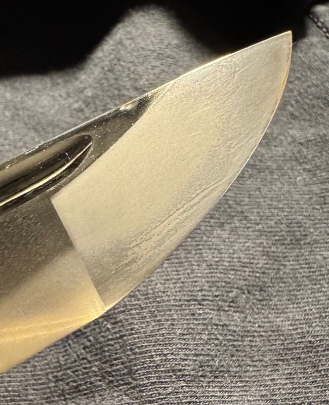

atm Posted Thursday at 06:57 PM Report Posted Thursday at 06:57 PM I am always impressed with the good photos of nihonto that some people are able to take. I’ve tried playing around with it a bit, but it seems like the fancier I try to get, the worse the photo. So I’ve resorted to just using my iPhone. Dust, reflections, lighting—all so frustrating. Just when I think I have a decent photo, I notice something is off. And good luck capturing a boshi! 2 1 Quote
ROKUJURO Posted Thursday at 07:18 PM Report Posted Thursday at 07:18 PM Adam, some images are really good in my opinion. It is as you say: TRy different angles and lighting, use a dark background for good contrast, and find the perfect focus. Your results will guide you! 2 Quote
Toki Posted Thursday at 09:05 PM Author Report Posted Thursday at 09:05 PM Those are some beautiful photos Adam. Especially the one of the Boshi. May I ask where you had the light come from for that one? So far, my pictures of the Kissaki always have been either out of focus or with bad lighting, so it´s needless to say making out the Boshi is impossible. I´ll post two regardless, one with my phone and one with the camera yesterday. Quote
atm Posted Thursday at 09:57 PM Report Posted Thursday at 09:57 PM 16 hours ago, Toki said: Those are some beautiful photos Adam. Especially the one of the Boshi. May I ask where you had the light come from for that one? Thanks. If I remember correctly, I had a naked bulb on the mune side and within a couple of feet of the sword. I held the nakago of the sword and kept adjusting its angle relative to the lens as I took photos. That's probably one out of 20+ I took in that position. Photos of the other side of the sword were also good for showing the activity in the boshi, but it shows the reflection of the phone. 3 Quote
