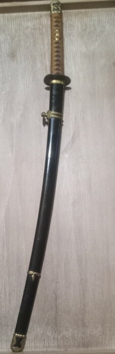

Rebeccacran Posted September 30 Report Posted September 30 (edited) I’m looking for info on the sword. I’ve been told is a World War II Japanese naval sword of some sort can anyone help me? Edited September 30 by Rebeccacran Improve picture quality 1 1 Quote

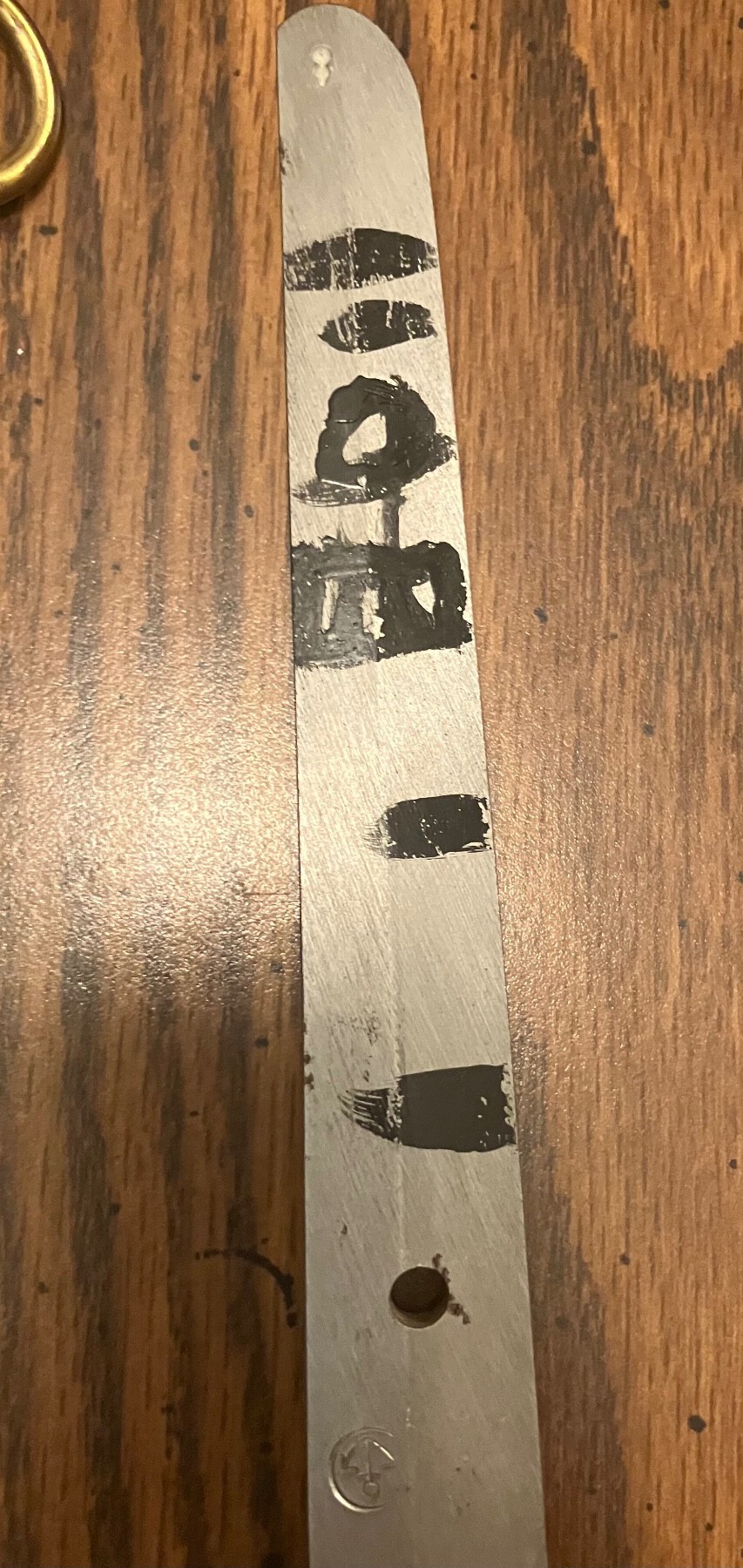

Bruce Pennington Posted September 30 Report Posted September 30 Hi Rebecca! What you have there is a Navy blade made by the Tenshozan sword company in the last days of the war, but mounted in souvenir fittings. Tenshozan contracted with the 8th Army PX (military version of Walmart) to sell over 8,000 of these souvenirs from 1946 to 1950'ish. The painted number - 11402 - tells us the blade was likely made before the war's end, but never used in combat. Many surplus blades were re-fitted for the souvenir contract and sold through the PX in Japan and later in Korea. Value? When honestly sold as souvenirs, they normally run about $450 USD. Navy kaigunto (Navy blades in proper Navy fittings) can go as high as $2,000 plus/minus. You can read about the souvenir operation in this article - The Mysterious NLF Gunto - A Souvenir PS: Could I possibly get a full length photo of the nakago (tang) for my records? I file and track these. 5 1 Quote
Bruce Pennington Posted September 30 Report Posted September 30 @BANGBANGSAN @Kiipu The painted number seems to have a "40" more freshly painted over " 1 1 ? 2". Can you make out the number underneath? I'm thinking the "40" was a number put there, over the wartime number, while assembling the souvenir. 2 1 Quote

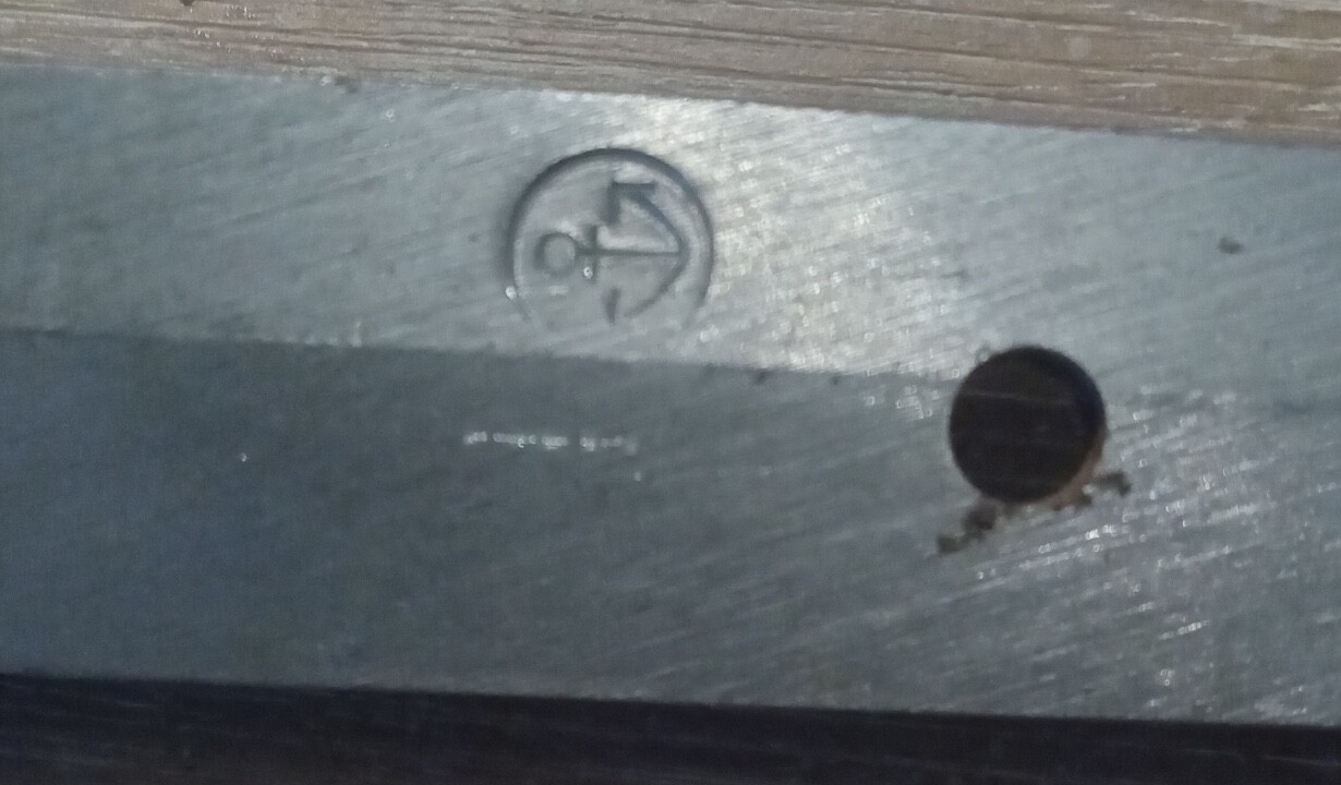

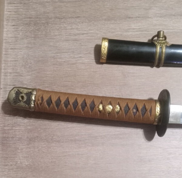

Rawa Posted September 30 Report Posted September 30 (edited) Worthy adding is: -its steinless steel blade, -saya lacquered wood not rayskin wrapped. -tsuba consists of one element [dunno if its brass/copper] For comparison full toyokawa 265 [fuchi and tang marked too] https://www.militaria.co.za/nmb/topic/52795-affordable-kai-gunto/#comment-554951 @Bruce Pennington anchor in circle is toyokawa right? Tenzoshan used anchor without circle. Edited September 30 by Rawa 2 1 Quote

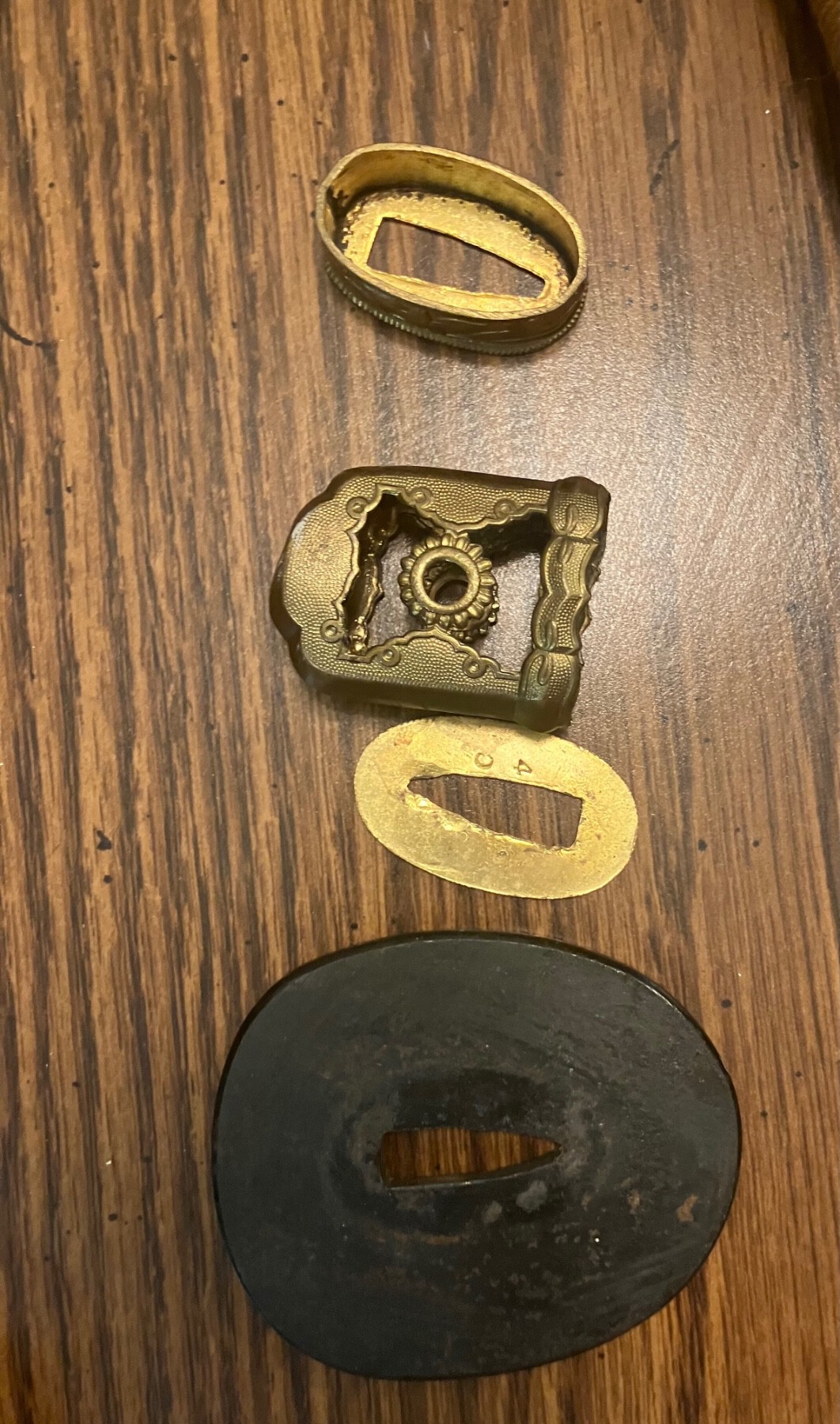

Kiipu Posted September 30 Report Posted September 30 Hi Rebecca, the various small parts will have a one or two digit number stamped or written on them. For example, the tsuba (crossguard) will have this number. Take a picture of this number and post it. This number will match to one of the combination of numbers painted on the nakago (tang) of your sword. When time permits, below is a link to an article about postwar souvenir swords that will answer most of your questions. The Mysterious Naval Landing Forces Sword And finally, many thanks for sharing pictures of your sword. 3 1 Quote

Rebeccacran Posted October 1 Author Report Posted October 1 5 hours ago, Bruce Pennington said: @BANGBANGSAN @Kiipu The painted number seems to have a "40" more freshly painted over " 1 1 ? 2". Can you make out the number underneath? I'm thinking the "40" was a number put there, over the wartime number, while assembling the souvenir. Quote
Kiipu Posted October 1 Report Posted October 1 23 hours ago, Bruce Pennington said: I'm thinking the "40" was a number put there, over the wartime number, while assembling the souvenir. Agree, 40 is the souvenir subassembly number. See the picture of the seppa (washer) above. 四〇 = 40. 2 Quote

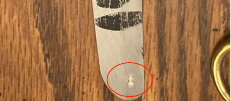

John C Posted October 1 Report Posted October 1 @Bruce Pennington Did you notice the hyotan mark on the nakago jiri? John C. 1 Quote

Bruce Pennington Posted October 1 Report Posted October 1 9 hours ago, John C said: @Bruce Pennington Did you notice the hyotan mark on the nakago jiri? John C. Good catch, John, thanks! I only had 4 others on file, and they are all on Navy stainless blades - 3 mumei (now 4); one signed by Kiyomichi; all in kaigunto fittings. This supports the idea that this blade was surplus, made for the war but not used until afterwards in the souvenir. 1 Quote
Bruce Pennington Posted October 1 Report Posted October 1 17 hours ago, Rawa said: @Bruce Pennington anchor in circle is toyokawa right? Tenzoshan used anchor without circle. Marcin, Thomas (Kiipu) recently figured out that this circled anchor was a generic, all purpose Navy inspection/acceptance stamp. Turns out that the Toyokawa Navy Arsenal had nothing to do with swords. The more elaborate circled anchor was the Naval inspector assigned to the Tenshozan factory, so still a Naval stamp, not a shop stamp. Quote

Kiipu Posted October 1 Report Posted October 1 15 hours ago, John C said: Did you notice the hyotan mark on the nakago jiri? I had to look that one up! 瓢箪 = hyotan The Gourd Canteen See also the story "Tengu no Hyōtan 天狗の瓢箪 The Tengu's Gourd." A little homework assignment for those that just gotta know what I am talking about! Another indicator of an early souvenir blade is that the bottom of the tang is finished versus cutoff. And finally, thank you for the additional pictures Rebecca. We track these souvenir blades by the subassembly number. If you look carefully at the tang, you will see the following two characters have been painted over the older number. As you can see, the parts on your sword match this number. I zoomed in on one of your pictures and also saw 40 stamped on the crossguard. 四〇 = 40. 3 Quote

Kaigunto230 Posted Sunday at 08:02 PM Report Posted Sunday at 08:02 PM On 10/1/2025 at 10:04 AM, Bruce Pennington said: Marcin, Thomas (Kiipu) recently figured out that this circled anchor was a generic, all purpose Navy inspection/acceptance stamp. Turns out that the Toyokawa Navy Arsenal had nothing to do with swords. The more elaborate circled anchor was the Naval inspector assigned to the Tenshozan factory, so still a Naval stamp, not a shop stamp. @Bruce Pennington and @Kiipu Could you please point me towards the thread with this information? I'd love to learn more. Thanks! Quote
Bruce Pennington Posted Monday at 02:14 AM Report Posted Monday at 02:14 AM Michael, The majority of the conversation took place via PM. I announced our conclusion and summary of the issue on this post: Quote
Kaigunto230 Posted Monday at 08:59 AM Report Posted Monday at 08:59 AM 6 hours ago, Bruce Pennington said: Michael, The majority of the conversation took place via PM. I announced our conclusion and summary of the issue on this post: Thank you very much @Bruce Pennington! Quote
