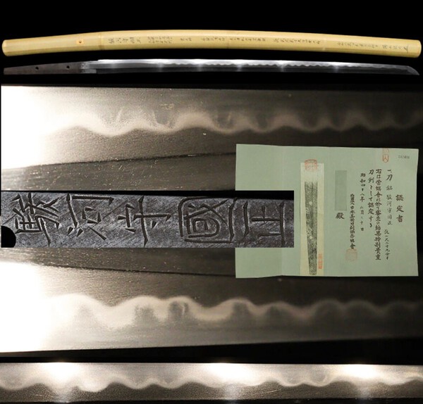

Guest When Necessary Posted August 25, 2025 Report Posted August 25, 2025 Hoorah! I managed to tick all the bad boxes with this one! Yahoo Auction ✔️ Cheap - $1,500 ✔️ Suriage✔️ Kanbun Shinto ✔️ Very shallow sori ✔️ Dodgy old green paper ✔️ And yet it just passed Tokubetsu Hozon. 🤔
Rawa Posted August 25, 2025 Report Posted August 25, 2025 11 minutes ago, When Necessary said: Hoorah! I managed to tick all the bad boxes with this one! Yahoo Auction ✔️ Cheap - $1,500 ✔️ Suriage✔️ Kanbun Shinto ✔️ Very shallow sori ✔️ Dodgy old green paper ✔️ And yet it just passed Tokubetsu Hozon. 🤔 Congratulations! But it can't be submitted for juyo as being suriage right? And how much it was shortened?
Guest When Necessary Posted August 25, 2025 Report Posted August 25, 2025 14 minutes ago, Rawa said: Congratulations! But it can't be submitted for juyo as being suriage right? And how much it was shortened? Who even wants dumb old Juyo papers? They don't have a cool photograph stuck on them.
Scogg Posted August 25, 2025 Report Posted August 25, 2025 34 minutes ago, Rawa said: Congratulations! But it can't be submitted for juyo as being suriage right? It could be submitted. It would be very unlikely to be awarded Juyo just because it's shinto and suriage. But suriage alone does not rule out the possibility of Juyo, and many suriage and osuriage blades achieve Juyo and beyond. I believe there is a shinto suriage katana that has achieved tokubetsu juyo from Nanki Shigekuni. Never say never or always, and there are exceptions to many 'rules'. All the best, -Sam 1

Gerry Posted August 25, 2025 Report Posted August 25, 2025 4 hours ago, When Necessary said: Hoorah! I managed to tick all the bad boxes with this one! Yahoo Auction ✔️ Cheap - $1,500 ✔️ Suriage✔️ Kanbun Shinto ✔️ Very shallow sori ✔️ Dodgy old green paper ✔️ And yet it just passed Tokubetsu Hozon. 🤔 Congrats on finding a diamond in the rough on Yahoo Auctions Japan! This goes against the general consensus that all dealers on Yahoo Auctions Japan sell dubious swords. This particular dealer that you bought your sword from is very prolific in sales, and it'll be curious to know why he/she didn't send the blades for updated origami.
Hokke Posted August 25, 2025 Report Posted August 25, 2025 16 minutes ago, Gerry said: This particular dealer that you bought your sword from is very prolific in sales, and it'll be curious to know why he/she didn't send the blades for updated origami. Good question, perhaps it was a simple matter of volume. Or maybe because someone told him kanbun shinto, suriage blades with shallow sori were "paperweights". 1 2

Guest When Necessary Posted August 26, 2025 Report Posted August 26, 2025 4 hours ago, Rayhan said: I cannot thank you enough! On behalf of the community new and old I say a huge thanks for removing this paperweight from the market and making sure no new collectors fall victim to the temptation. You've done everyone a huge favour, Arigato. So let's analyse exactly what you've really just said in that comment. You are stating, quite clearly, that the NBTHK (the most respected organisation in sword appraisal) - when giving the status of Tokubetsu Hozon (extraordinarily worthy of preservation) to a sword, which through being suriage will be unable to proceed to the next level of Juyo - are vis-à-vis declaring that item to be a "paperweight" and thus not worthy of collecting at all. Ergo, anything lesser than Juyo are inherently inferior - whatever the NBTHK judges them to be or whatever their owner feels them to be. You really are a self-fullfilling prophecy, aren't you Rayban old son? Sneering and belittling and undoing whatever good you hoped to achieve by starting this thread. You just can't help yourself. It's rather sad really.

R_P Posted August 26, 2025 Author Report Posted August 26, 2025 8 hours ago, When Necessary said: So let's analyse exactly what you've really just said in that comment. You are stating, quite clearly, that the NBTHK (the most respected organisation in sword appraisal) - when giving the status of Tokubetsu Hozon (extraordinarily worthy of preservation) to a sword, which through being suriage will be unable to proceed to the next level of Juyo - are vis-à-vis declaring that item to be a "paperweight" and thus not worthy of collecting at all. Ergo, anything lesser than Juyo are inherently inferior - whatever the NBTHK judges them to be or whatever their owner feels them to be. You really are a self-fullfilling prophecy, aren't you Rayban old son? Sneering and belittling and undoing whatever good you hoped to achieve by starting this thread. You just can't help yourself. It's rather sad really. No no, let's not start interpreting my statement incorrectly. What i said is that particular sword is a paperweight, your sword. Not every sword below Juyo. Realistically a sword must go Hozon, to Tokubetsu Hozon before going Juyo so your statements are nonsensical. Its just the particular sword that you now own (hopefully for a very long time). Keep it safely off the market please.
Guest When Necessary Posted August 26, 2025 Report Posted August 26, 2025 20 minutes ago, Rayhan said: No no, let's not start interpreting my statement incorrectly. What i said is that particular sword is a paperweight, your sword. Not every sword below Juyo. Realistically a sword must go Hozon, to Tokubetsu Hozon before going Juyo so your statements are nonsensical. Its just the particular sword that you now own (hopefully for a very long time). Keep it safely off the market please. You should be in standup Rayban - you crack me up, you really do! 😂
