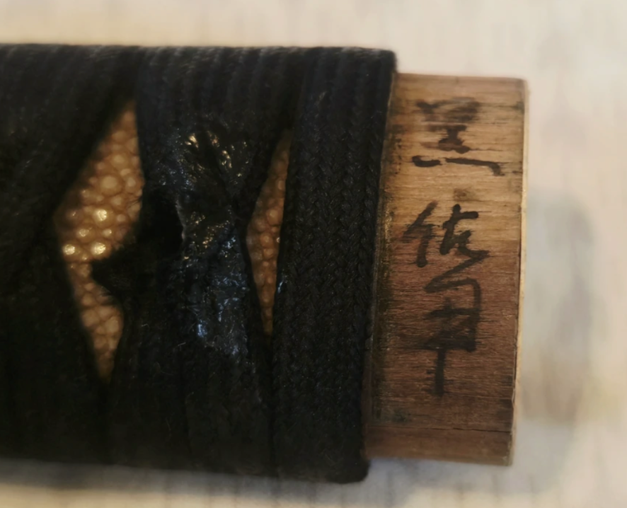

Kratos Posted July 30, 2025 Report Posted July 30, 2025 Sukesada sword full pictures and videos Just got my first sword. Paid up for it and got killed by tariffs. Any thoughts on value? There is also signatures under the tsuba if anyone can translate. https://imgur.com/gallery/RrH6EWf Quote

SteveM Posted July 30, 2025 Report Posted July 30, 2025 Signature on the fuchi reads 壽家(花押)Toshiie (monogram). Writing on the wooden part of the koshirae that is normally under the fuchi looks like it reads 黒 (black) then 佐 + something, maybe 佐中 (Sanaka, a surname). I think this bit is just a note written by/for the koshirae maker, or maybe for the ito-maki shi. 1 Quote
