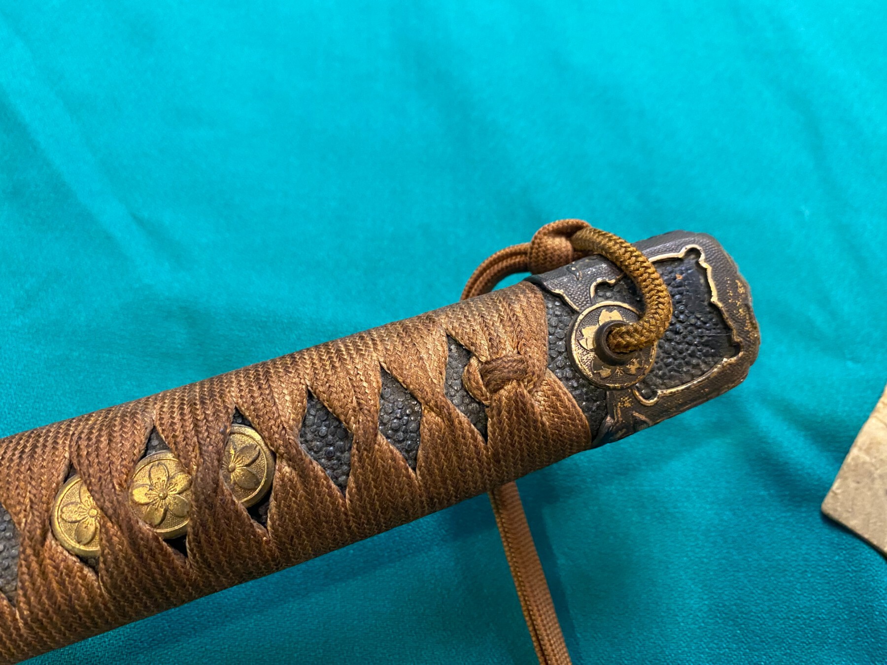

The thin cord tied to the haikan (belt hanger loops) has a name which I cannot remember ( @PNSSHOGUN could tell us), and is properly attached like so:
or
Very nice sword!
