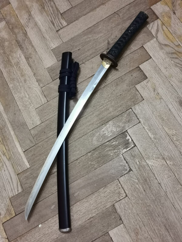

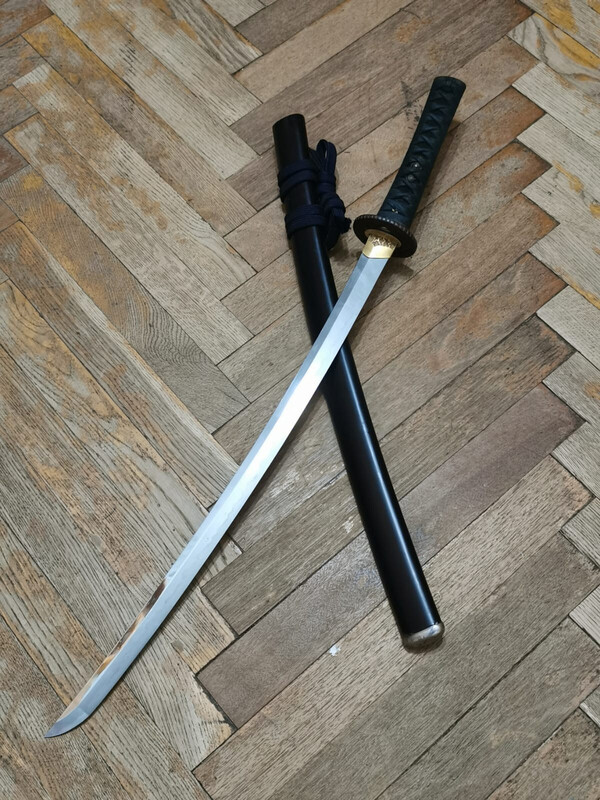

Yesterday night one local seller approached me offering this Wakizashi.  The price he asks is USD 3850.  Seller states total length is 80cm, length of blade 57cm.
He sent me a bunch of photos along with some photos of  Tokubetsu Kicho Origami.  And Origami became my main concern. I figured that it was issued in 1970, and found the article on how to read it. Yet, I found the section where description has to be confusing to read. The section where mei has to be does not match mei on photos of nakago in Origami.  Also I noticed that photos of nakago stamped with a round stamp that looks like a stamped seal from Tokubetsu Hozon papers. I went through some Tokubetsu Kicho Origami  pictures and none of them have round stamped seals. They all have identical rectangular stamps on areas with pictures and with writings.

Ater Jean's words it all clicked together.  The papers turned out to be tampered.  As you may see, the photos of Nakago were made on the  graph paper. It intrigued me from the start since such kind of paper was (and is) popular here. I used it as a student and later on I used it in my workshop to make blueprints for some complicated shapes. Meanwhile, photos for Green Paper Origami usually have a plain paper for background. I was taking a closer look at the stamp on photos when I noticed something so obvious that it's a shame I didn't notice it earlier. There is +38 and part of 0 visible on the blank edge of graph paper. It's an international code for Ukrainian phone numbers. Obviously it's part of a phone number printed by the manufacturer of graph paper that was used by some local "geniuses" for the background of nakago photos. And sure, after that one may spot the remains of the original picture/photo and the red rectangular seal in between photos of nakago.

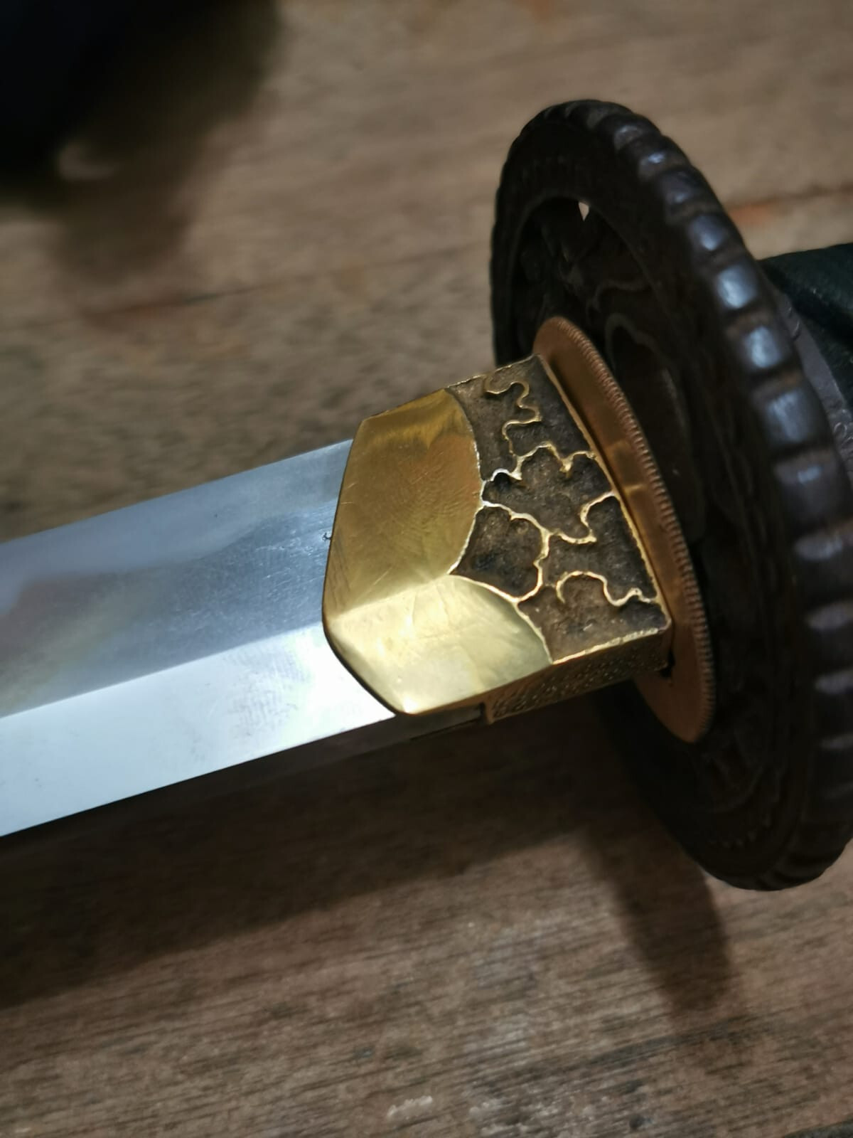

However, I like this wakizashi and its fittings, especially habaki. So I am interested in the opinion of this community on this sword.

I'm sorry but someone has switched the photo on the papers: the description relates to an Echizen Shimosaka blade and not the one you have or are looking to buy.
If you haven’t bought it already, please don’t.

Marcin, as I said, I liked this wakizashi. So if it was not gimei I'd consider buying it even with no papers (with some negotiations on price, sure).
Thank you, John! Thank you for the information! Yes, I figured out that photos were replaced by some local persons.  Will not buy this sword.
This whole story may be sad for the seller, but I believe he will worm his way out with this wakizashi. For me it was very educational, so thanks once more to all who participated in this topic!
Easy to spot scam, and never mind it is gimei. The sword is signed Bitch no Kami Tachibana Yasuhiro.  The papers say Echizen Shimosaka.
