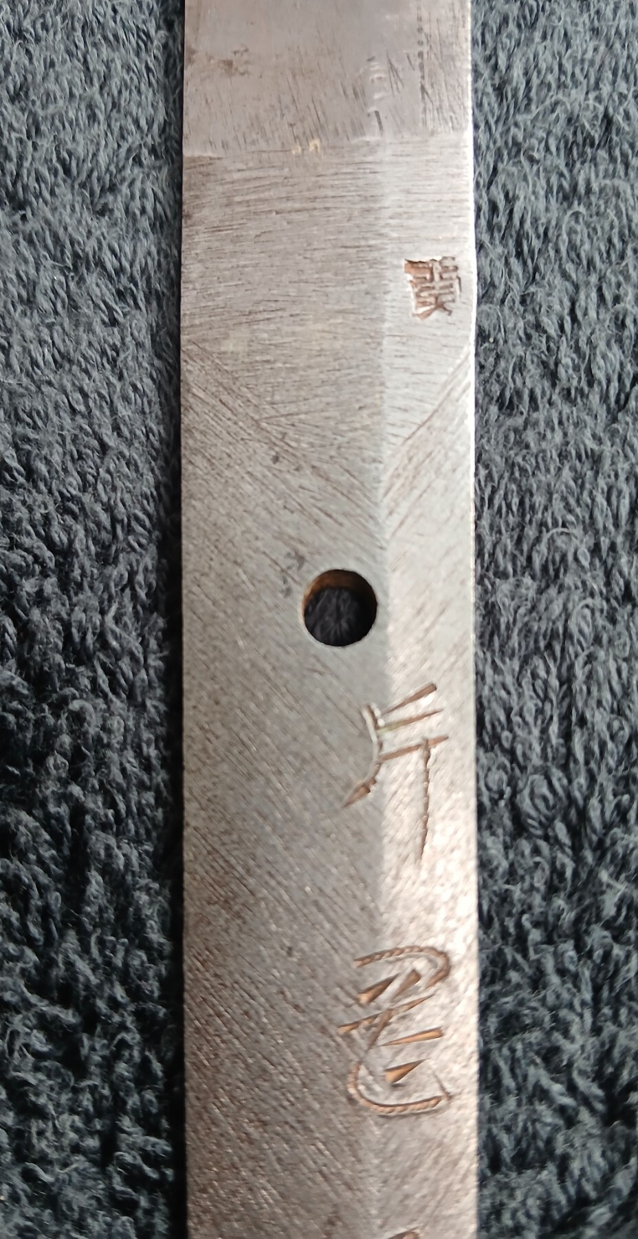

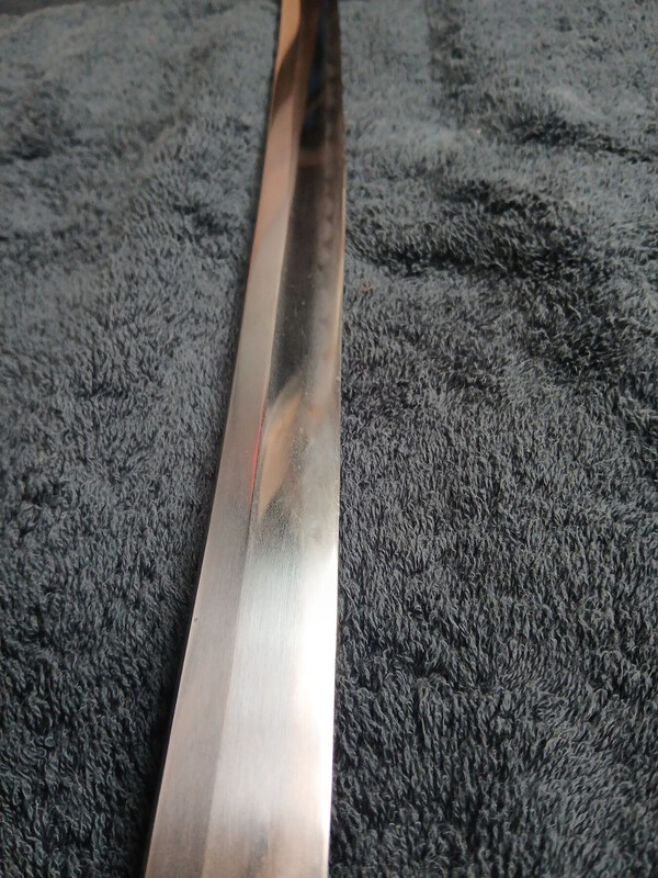

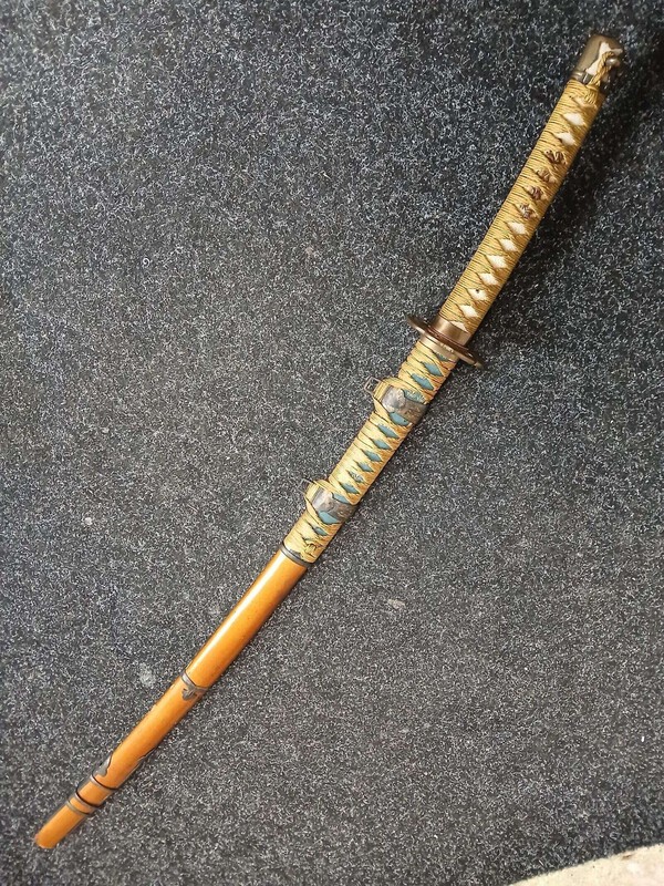

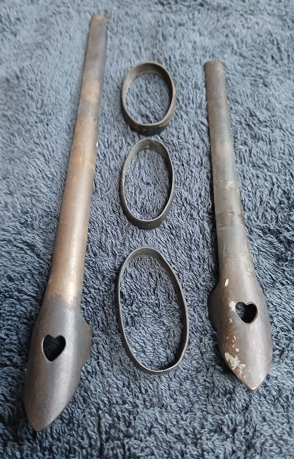

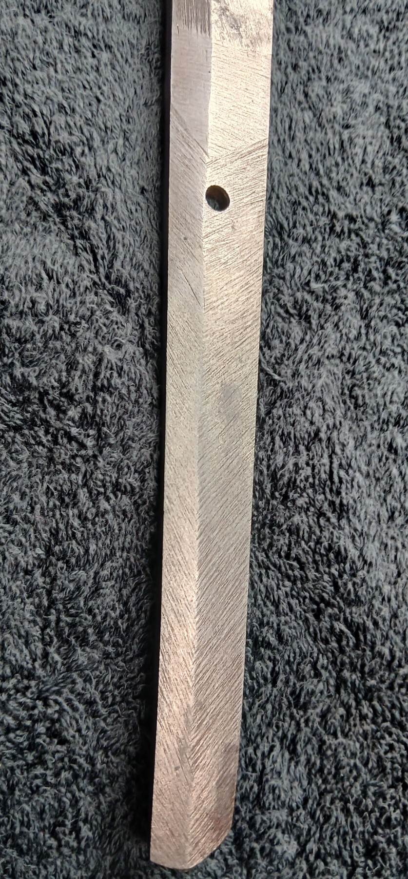

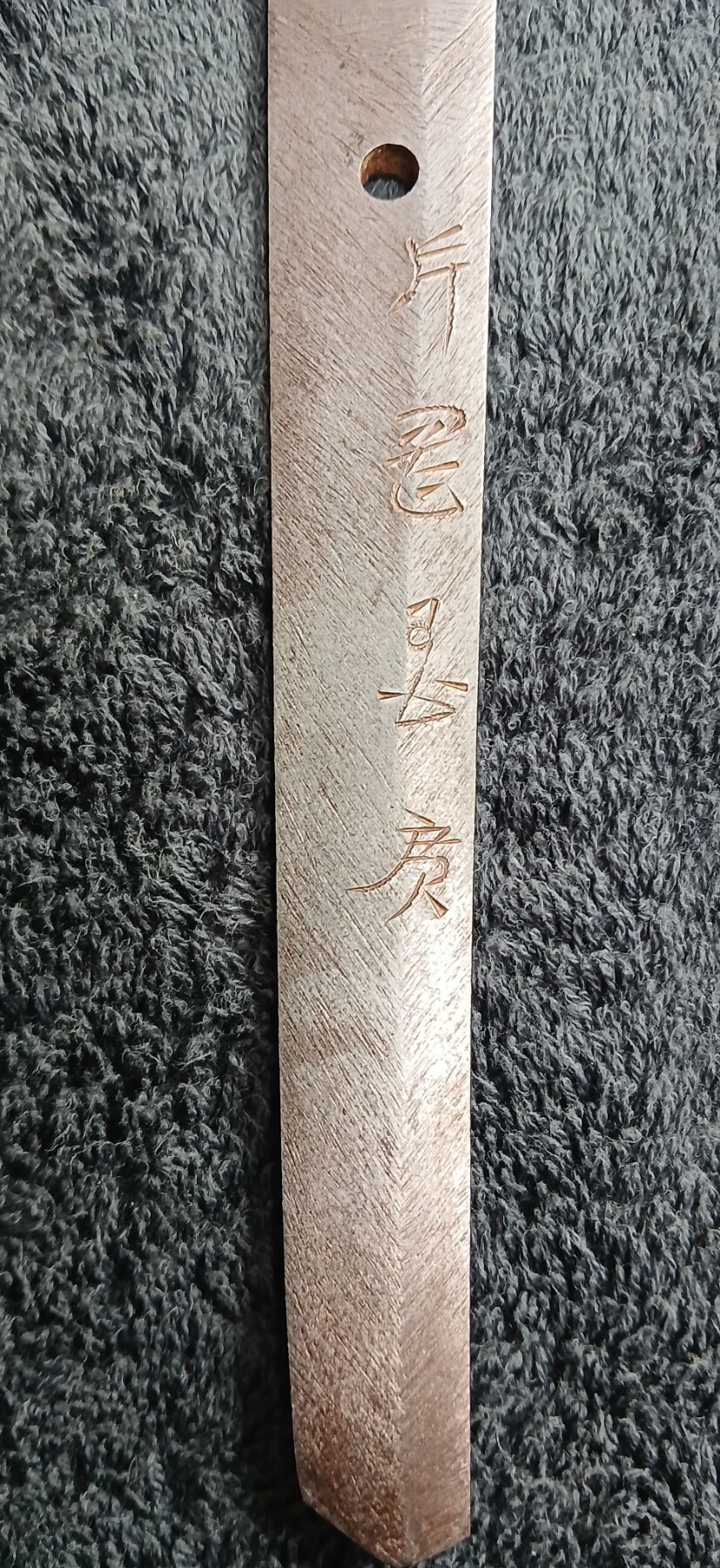

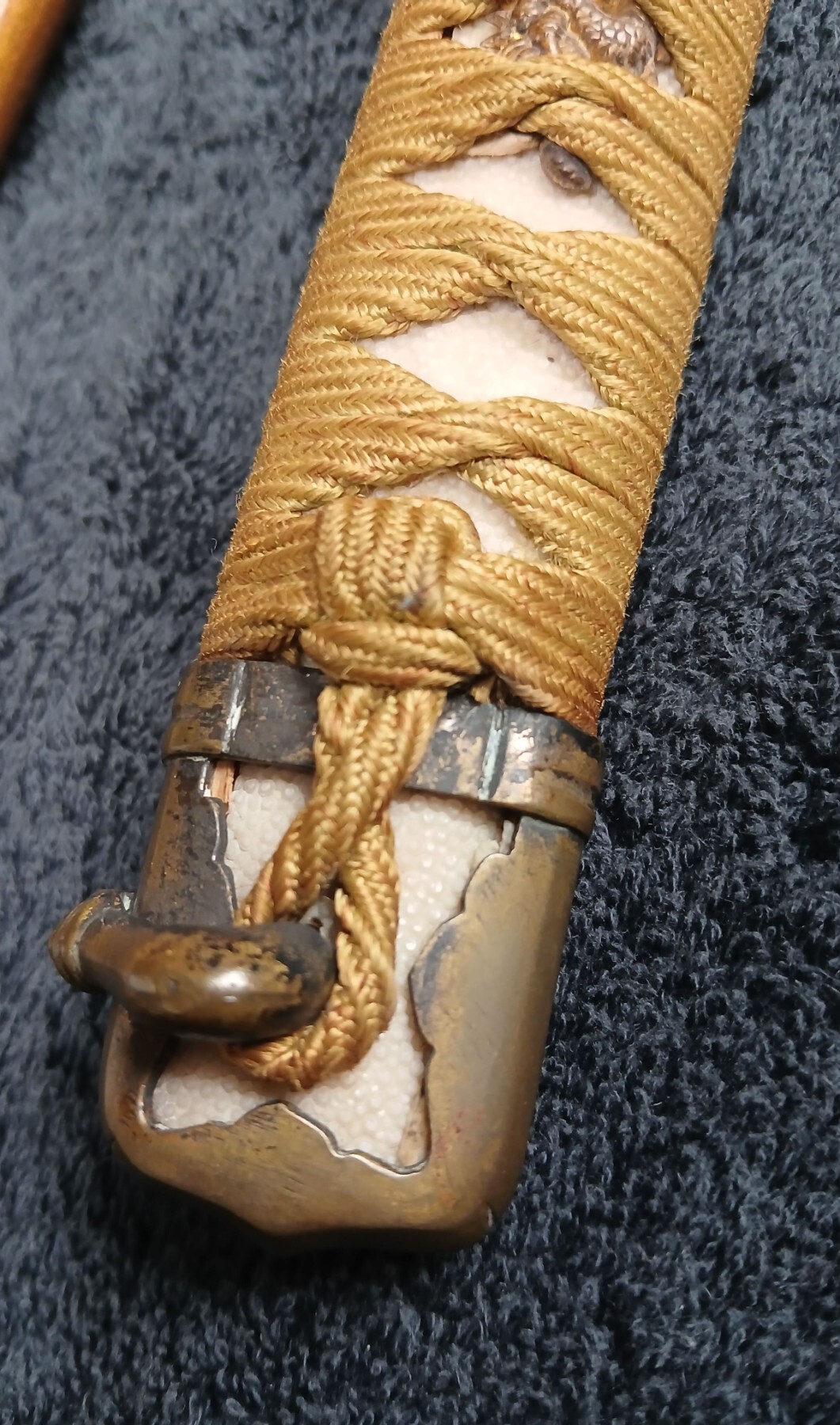

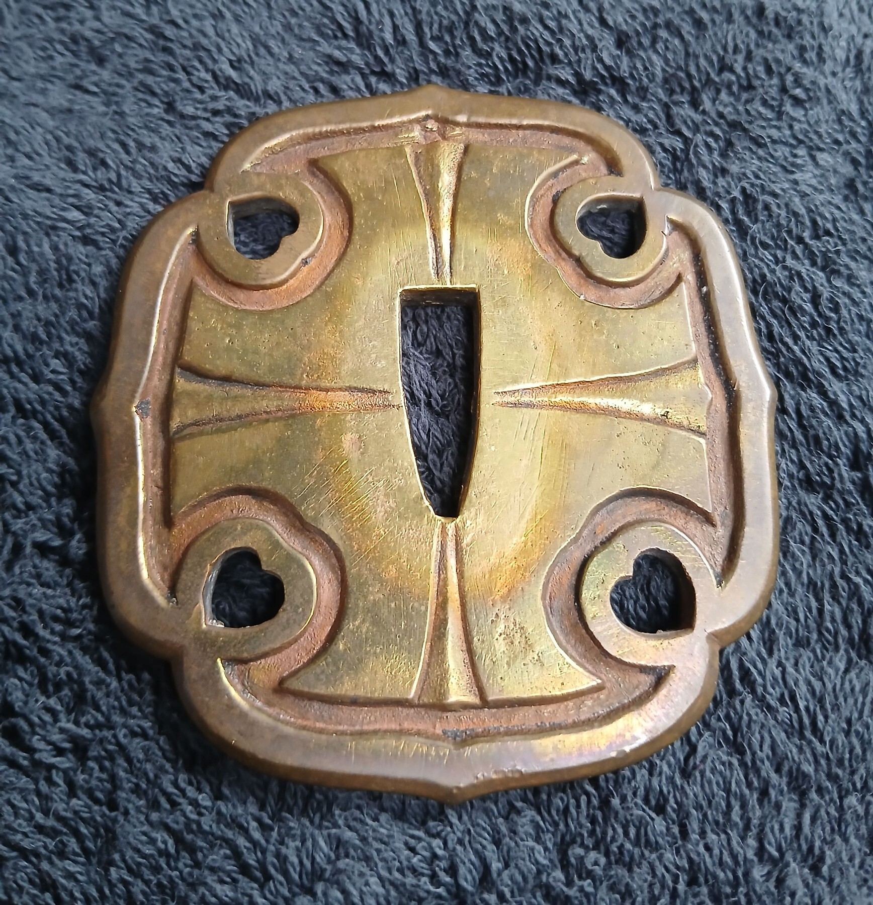

Hey folks, somehow i've got my hands on what seems to be a tachi mounted seki blade? The saya has some paint chipping also wrap and hardware is coming loose, and sadly missing the endcap. Tsuka is mint but very loose and ill-fitting but mekugi lines up. Habaki was a worthless cast brass pos, replaced that with a 2 piece copper habaki that fits like a glove. Tsuba is a single solid cast brass piece?? (Always thought tachi koshirae had multi-piece tsubas) also included to shim the whole thing, 1 generic brass seppa and 2 gunto seppa stamped 52. Blade is clean with no chips or cracks, not very sharp, hamon barely visible. Seki stamped and looks like the nakago has been cleaned. Mei not yet translated. Nagasa is 65 cm. Paid 600 bucks for the thing. Keen to hear your thoughts.
They both could be right, Showa era tachi, missing parts or bad shape, restored by a recent collector.
I just recently saw that mei in my files, but have forgotten who it was.  Maybe @SteveM can helps us out?
  • Love 1
13 hours ago, SteveM said:
Hi guys, looks like Kataoka Kunihiro 片岡国廣
Yep!  Matches the mei style of the others in my files.  Just couldn't remember who it was.  Thanks, Steve!
