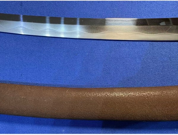

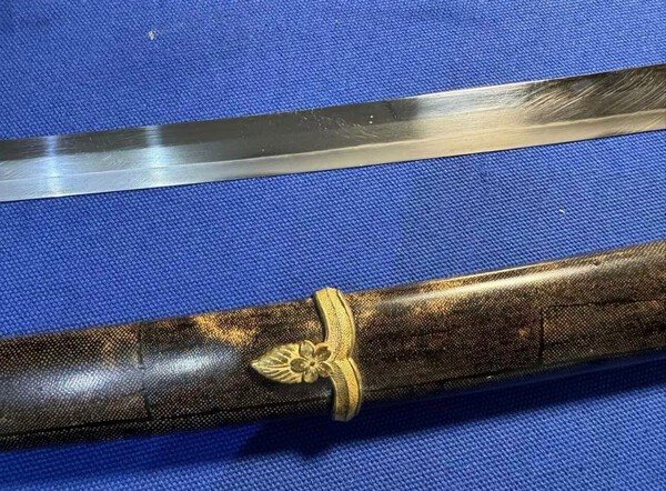

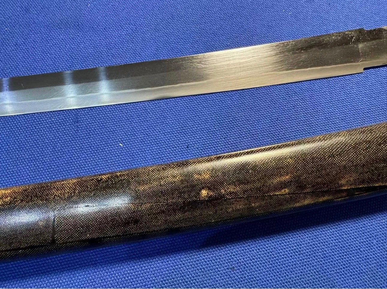

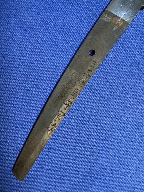

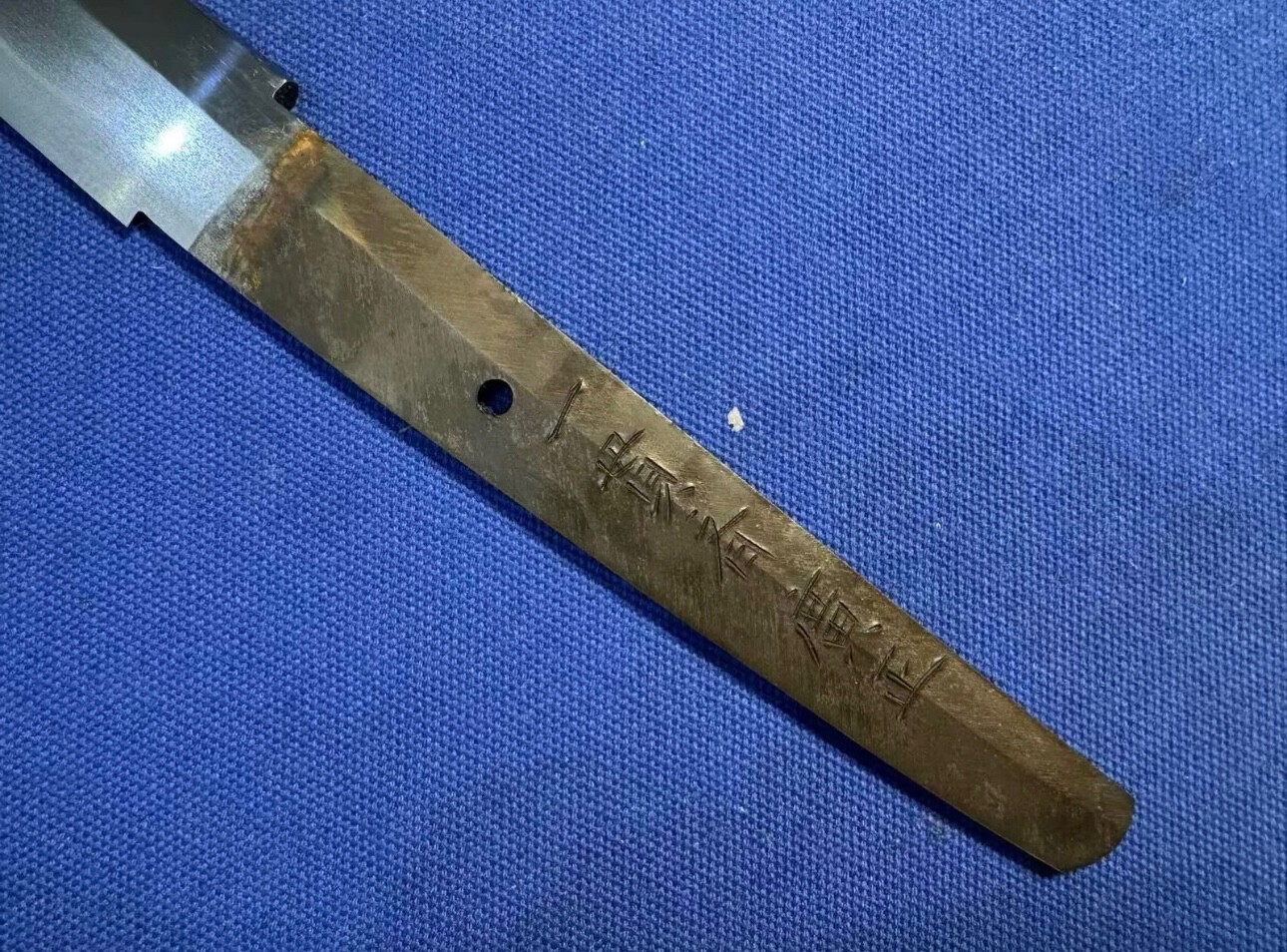

Swords Posted June 16, 2025 Report Posted June 16, 2025 I saw this and thought it was a good price it said old polish but to me the hamon doesn’t look right I want to get other opinions Signed :一貫斉廣正(Ikkansei Hiromasa) The scabbard is wood, no lacquer loss, no dent, no bend and in mint condition. The handle is tightly fit with family mon, tsuka-ito wrapping has no cuts, no loose, no cut and in mint condition.Lock mechanism works not fine. Tsuba, lock pin and seppa are matched number 111 stamped. In old Polish, Sold as is . Nagasa:49cm. Sori:1.8cm Moto-haba:3.25cm . Saki-haba: 2.2cm Moto-gasane: 0.7cm . Saki-gasane:0.4cm Quote
Ray Singer Posted June 16, 2025 Report Posted June 16, 2025 This looks much like a Komonjo-type gimei. 1 1 Quote

eternal_newbie Posted June 16, 2025 Report Posted June 16, 2025 5 minutes ago, Swords said: Seems every thing I see is a gimei how about the hamon? Some worthwhile insights on buying gimei blades by the late, great Darcy Brockbank: https://web.archive.org/web/20201201114903/https://blog.yuhindo.com/gimei/ Quote
Ray Singer Posted June 16, 2025 Report Posted June 16, 2025 13 minutes ago, Swords said: Seems every thing I see is a gimei how about the hamon? I should clarify, when I gave the feedback above I was not just saying gimei but indicating that the blade itself does not look Japanese (typical for Komonjo and similar sellers). What type of feedback are you looking for on the hamon? It is notare, and appears to be vacant of hataraki from what I can see in the photos. 2 Quote

Brian Posted June 16, 2025 Report Posted June 16, 2025 Agree with everything Ray said. Odd and consistent how they get these flat, lifeless hamon (acid enhanced) with zero activity or anything else showing. 1 Quote
