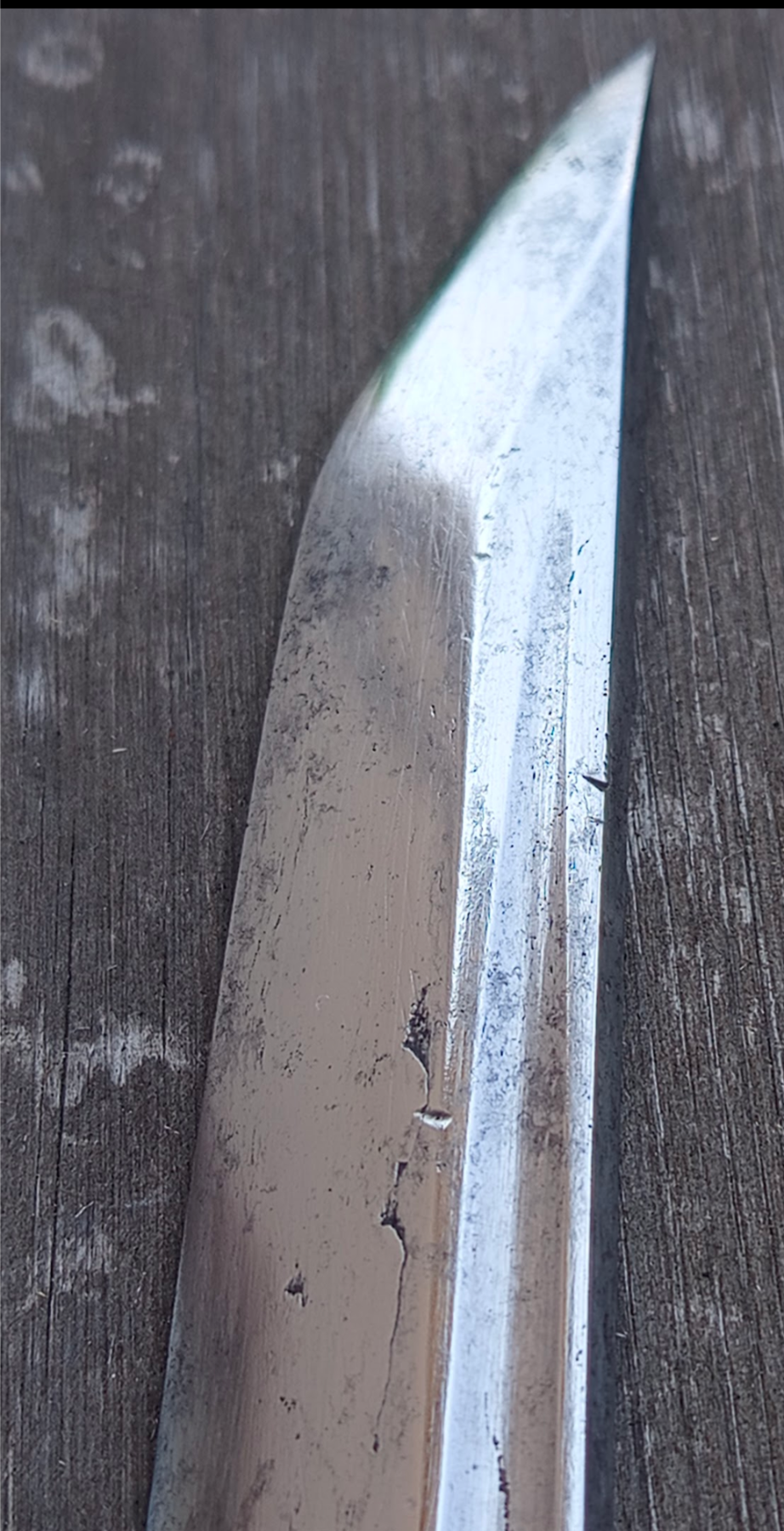

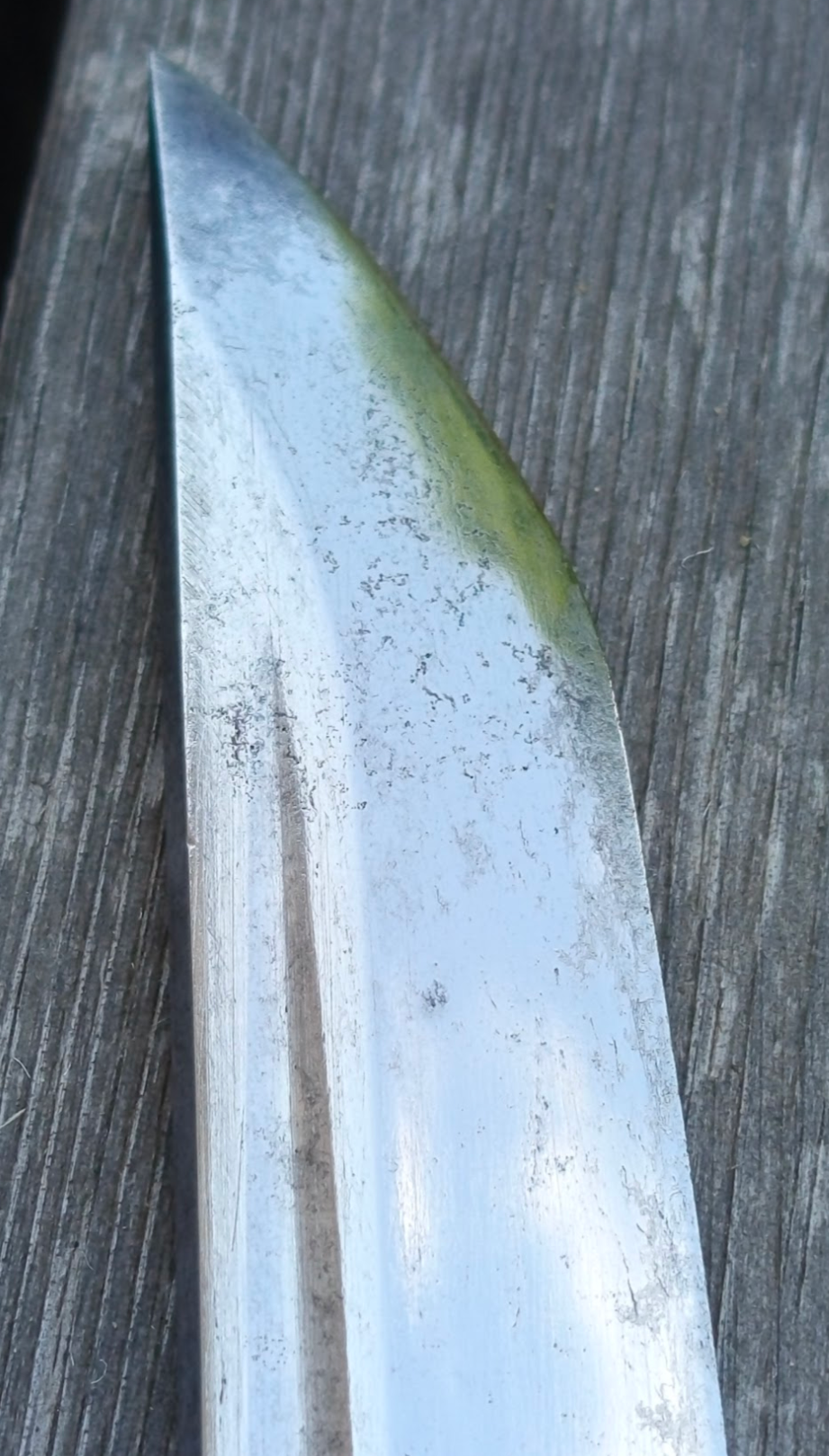

domi88 Posted June 13 Report Posted June 13 Hello everyone. I had published an article on an old katana some time ago and I finally managed to buy it, because the seller sold it at a really low price and it seemed to me that it was worth it. I know that the blade is not perfect, with a few tasks and blows on the edge, but overall, I am satisfied. I would like to know the age of this katana and others. I put as many photos as possible. THANKS https://photos.app.goo.gl/A9d53Hdd7CiGSBQJ8 Quote
Rawa Posted June 14 Report Posted June 14 Nakago O-suriage, no yokote. Nagamaki naoshi? Blade is in a bad shape but dsn't look to be vintage. Quote
Rawa Posted June 14 Report Posted June 14 Sugata looks kinda similar. Double habaki, tsuba with real sekigane. Maybe tsukamaki, fuchi, kashira are not great but overall would say muromachi [15/16c] or older [koto sword era]. Don't polish it. 1 Quote
Rawa Posted June 14 Report Posted June 14 Are you able to see on nakago 2 parts with different old rust patina? Quote

Ray Singer Posted June 14 Report Posted June 14 It is very likely that the sword is fatally damaged, the kissaki has been very crudely reshaped, the natural fukura (curvature of the kissaki) removed completely and most probably the boshi is gone at this point. I don't see any indication of a naginatanaoshi here, this appears to be a o-suriage mumei katana (Shinto or earlier) but with likely fatal issues due to the amateur reshaping of the kissaki combined with non-fatal forging flaws. 6 1 1 Quote
Rawa Posted June 14 Report Posted June 14 Seeing this kissaki it wasn't temptation for profit. Blade still have good vibe. 2 Quote

domi88 Posted June 15 Author Report Posted June 15 10 hours ago, Ray Singer said: Il est très probable que le sabre soit mortellement endommagé, le kissaki ayant été grossièrement remodelé, la courbure naturelle du kissaki ayant été complètement supprimée et le boshi ayant probablement disparu à ce stade. Je ne vois aucune trace de naginatanaoshi ici ; il semble s'agir d'un katana o-suriage mumei (shinto ou antérieur), mais présentant probablement des défauts mortels dus à la remodelage amateur du kissaki, combiné à des défauts de forge non mortels. Thank you Ray.ce Katana I acquired it like that, so if I understand correctly, he was shortened ?? Sincerely Quote
Rawa Posted June 15 Report Posted June 15 Yes o-suriage means shortened. I thnk you didn't overpaid. You can tell us how much it costed you? Quote
