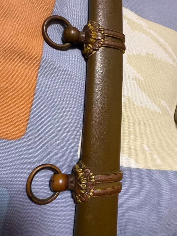

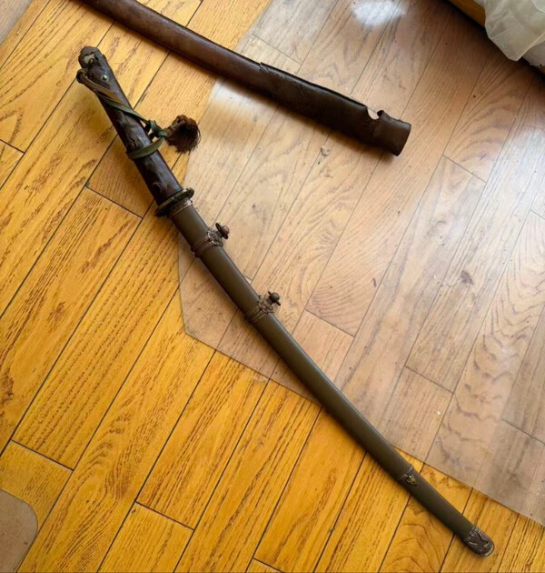

Wangzi Posted June 9 Report Posted June 9 Hello fellow militaria collectors, I’d appreciate your expertise on this Japanese Army Type 94 Guntō featuring exceptional Wakase-style Koshirae. Seller told me the second suspension ring is a genuine one,but does not belong to this Koshirae set. Thank you for sharing your knowledge. Quote
Wangzi Posted June 9 Author Report Posted June 9 2 hours ago, PNSSHOGUN said: Is the leather cover cut for the second hanger? no,this gunto comes with the leather cover and only one hanger,the seller took off the cover and put another hanger onto it. 1 Quote

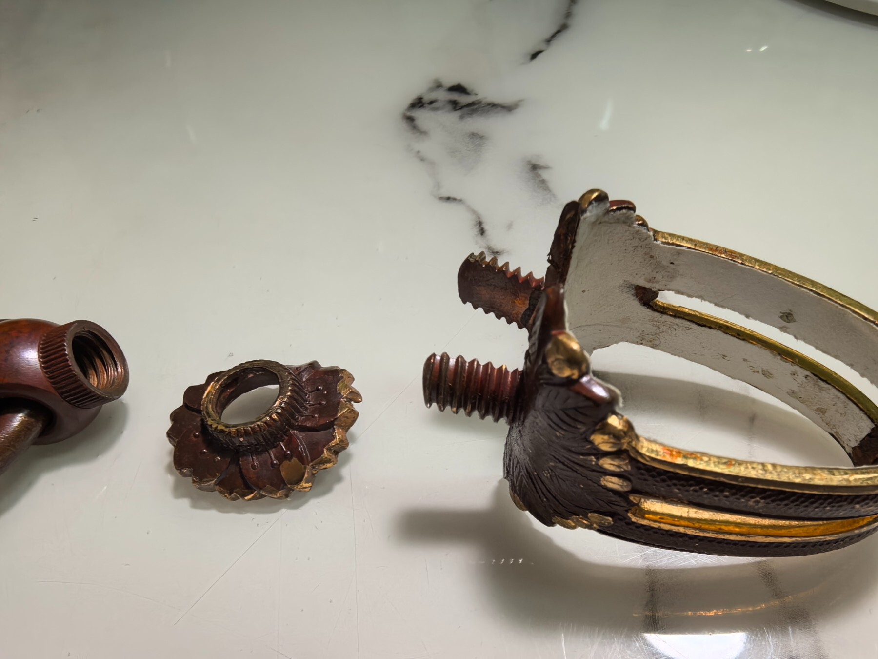

Bruce Pennington Posted June 9 Report Posted June 9 By the look of the paint underneath, I'd agree the haikan was not original. Nice set of fittings, though. Would you mind displaying the second haikan, and showing how it comes apart? We had a discussion about these and the various ways they were built: Quote

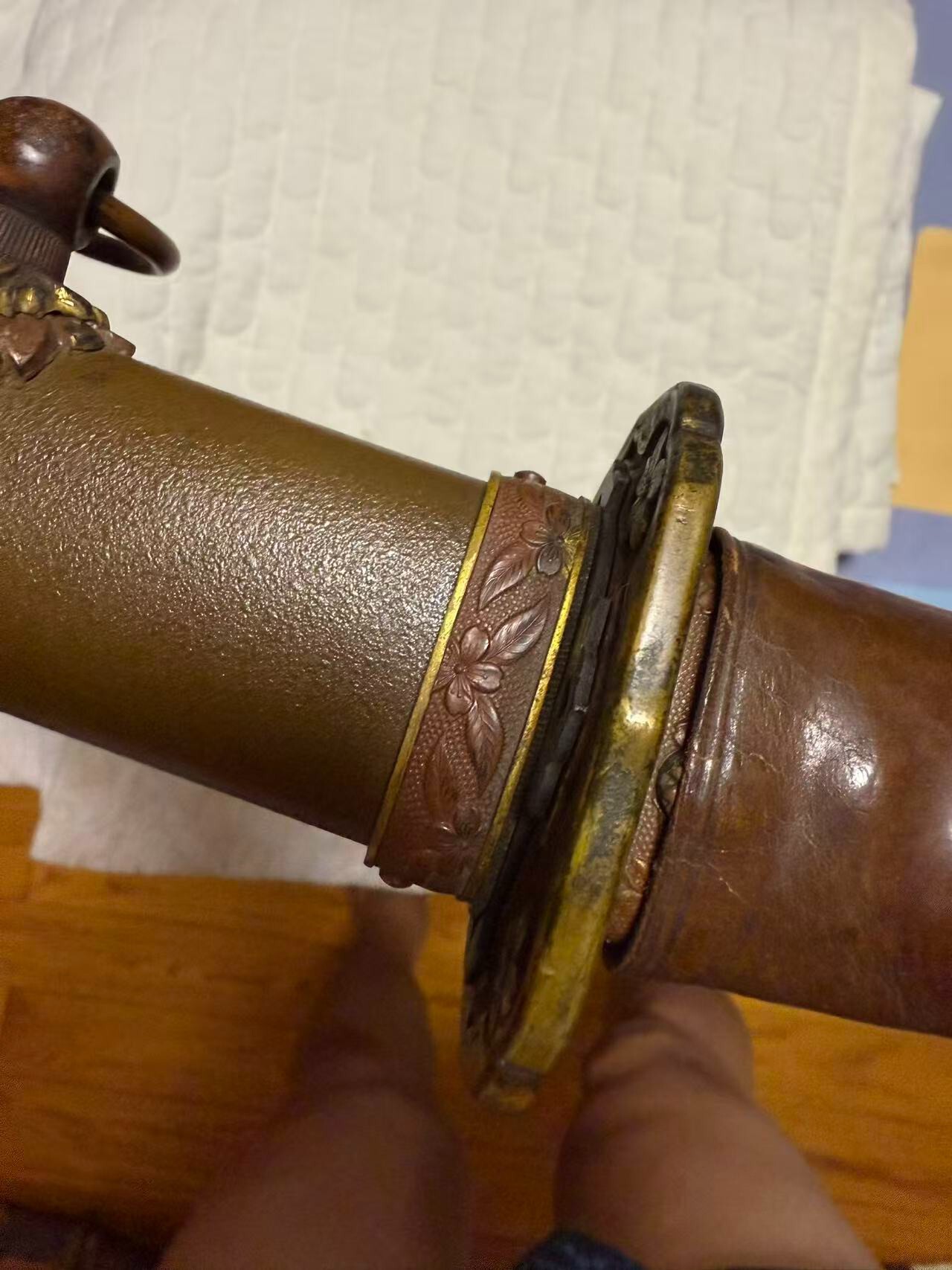

Navy Posted June 9 Report Posted June 9 Am I wrong or usually the 94's have the pierced tsuba? 1 Quote
rebcannonshooter Posted June 9 Report Posted June 9 I have an absolutely original, high end 94 and it does not have a pierced tsuba. But, I don't how prevalent they were on 94's or if pierced were more common. Tom M. 1 Quote
PNSSHOGUN Posted June 9 Report Posted June 9 Wakase fittings are one of the makers that introduced the solid Tsuba early on, there have been a few Koshirae over the years from Wakase that have two original hangers. Certainly an exception, not a rule. 1 1 Quote
Wangzi Posted June 10 Author Report Posted June 10 21 hours ago, Bruce Pennington said: By the look of the paint underneath, I'd agree the haikan was not original. Nice set of fittings, though. Would you mind displaying the second haikan, and showing how it comes apart? We had a discussion about these and the various ways they were built: Bruce, sorry that the gunto showed above is owned by a sword dealer. But I can show you another hanger of mine. To my knowledge, there should be three variations of the hanger, I hope this could help. Zi 1 1 Quote
Wangzi Posted June 10 Author Report Posted June 10 18 hours ago, Navy said: Am I wrong or usually the 94's have the pierced tsuba? I think the Wakase koshirae is characterized by a solid and slim tsuba and a special ishizuki. Quote

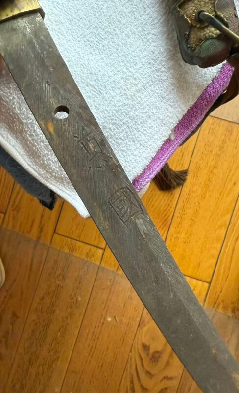

Wangzi Posted June 11 Author Report Posted June 11 Actually it has a blade inside with a Mei "兼國". I just ignored the blade becoz I do like this Koshirae.😅 You guys are right, it is too expensive even with a whole blade. 1 Quote
