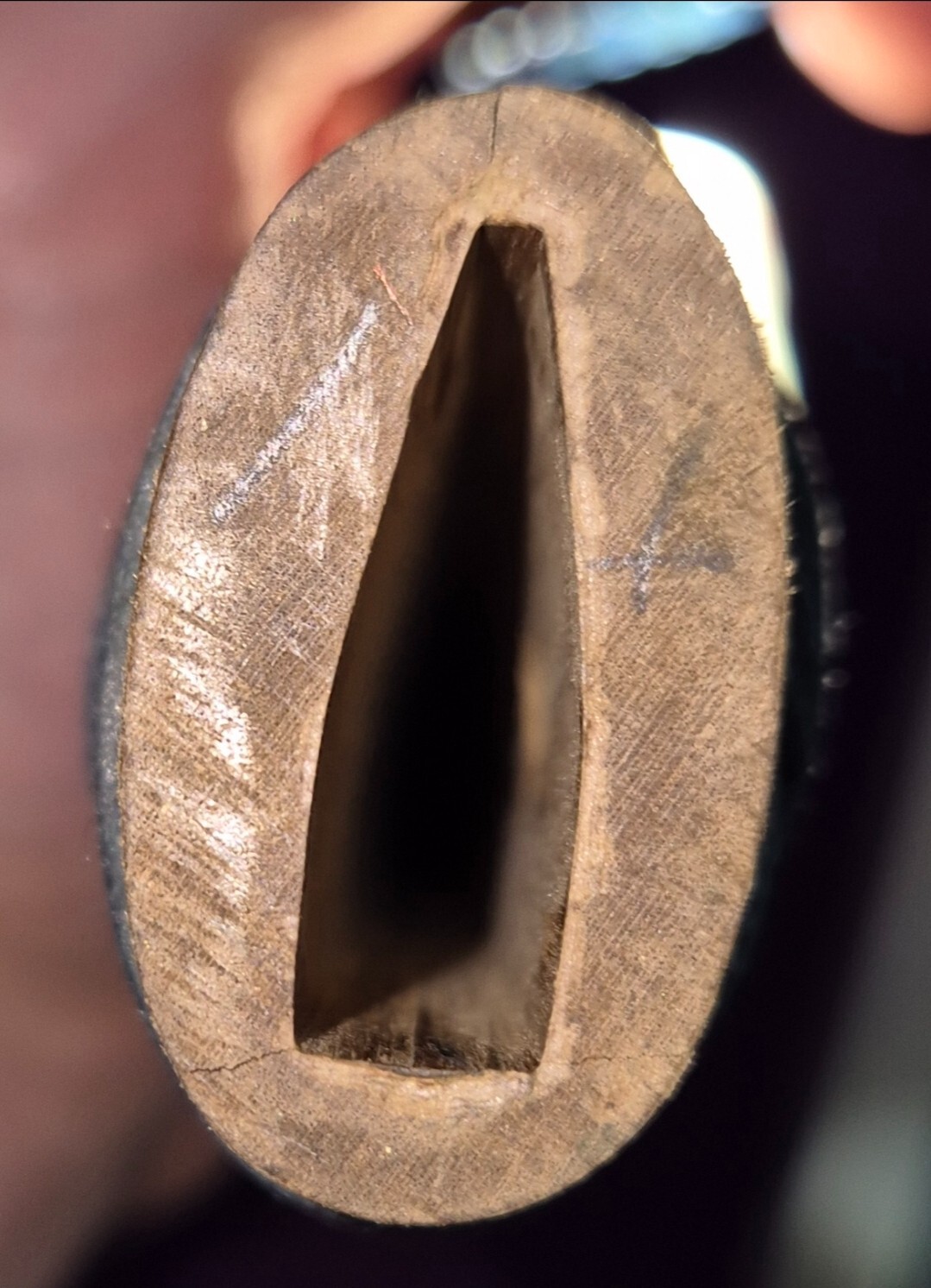

Emil Posted June 3, 2025 Report Posted June 3, 2025 Since purchasing this katana in Tokyo, it has now experienced all four seasons here in Scandinavia. Even from the start, the tsuka has always been overly tight. While it's slightly more manageable in the dry winter months, the fit is still too tight year-round, and it worsens noticeably in the humid summer. The mekugi it came with is aggressively tapered, which hints that it was a long time ago the mekugi ana aligned well. The shirasaya tsuka surprisingly fits perfectly all year round. The blade is a Showa-era military piece that was used for tameshigiri in Japan, which is why it’s mounted in uchigatana-style koshirae. Unfortunately, sending it back to Japan for professional adjustment isn’t an option. Would it be too risky to attempt a careful adjustment myself? At this point the tsuka risks getting damaged from just mounting it in Koshirae, potentially worsening the cracks in the tsuka. Quote

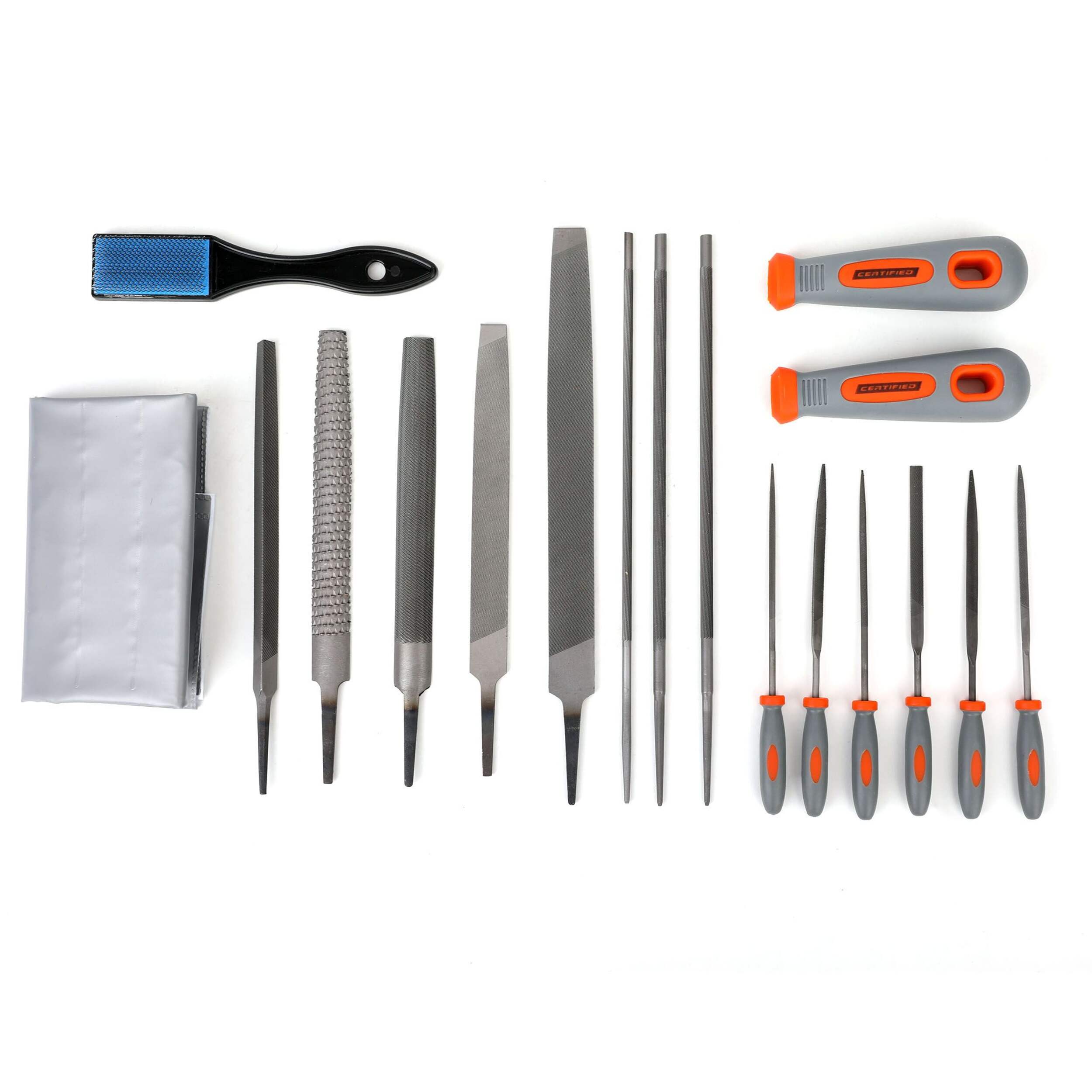

The Forest Ninja Posted June 4, 2025 Report Posted June 4, 2025 I used tiny files to dig out 2 Japanese knife handles for 2 Kitchen knives I made. I purchased these locally and the 5 tiny files on the bottom right were what I used. Certified Metal File Set with Convenient Carrying Pouch, High Carbon Steel, 17-pc 1 Quote
Tohagi Posted June 9, 2025 Report Posted June 9, 2025 Hello Émile, As a suggestion, do not mount tsuka without fuchi, it will crack! Use à little dilued wood glue or rice glue in water to fix the two cracks before any cutting mouvement. Best, Eric 1 Quote
