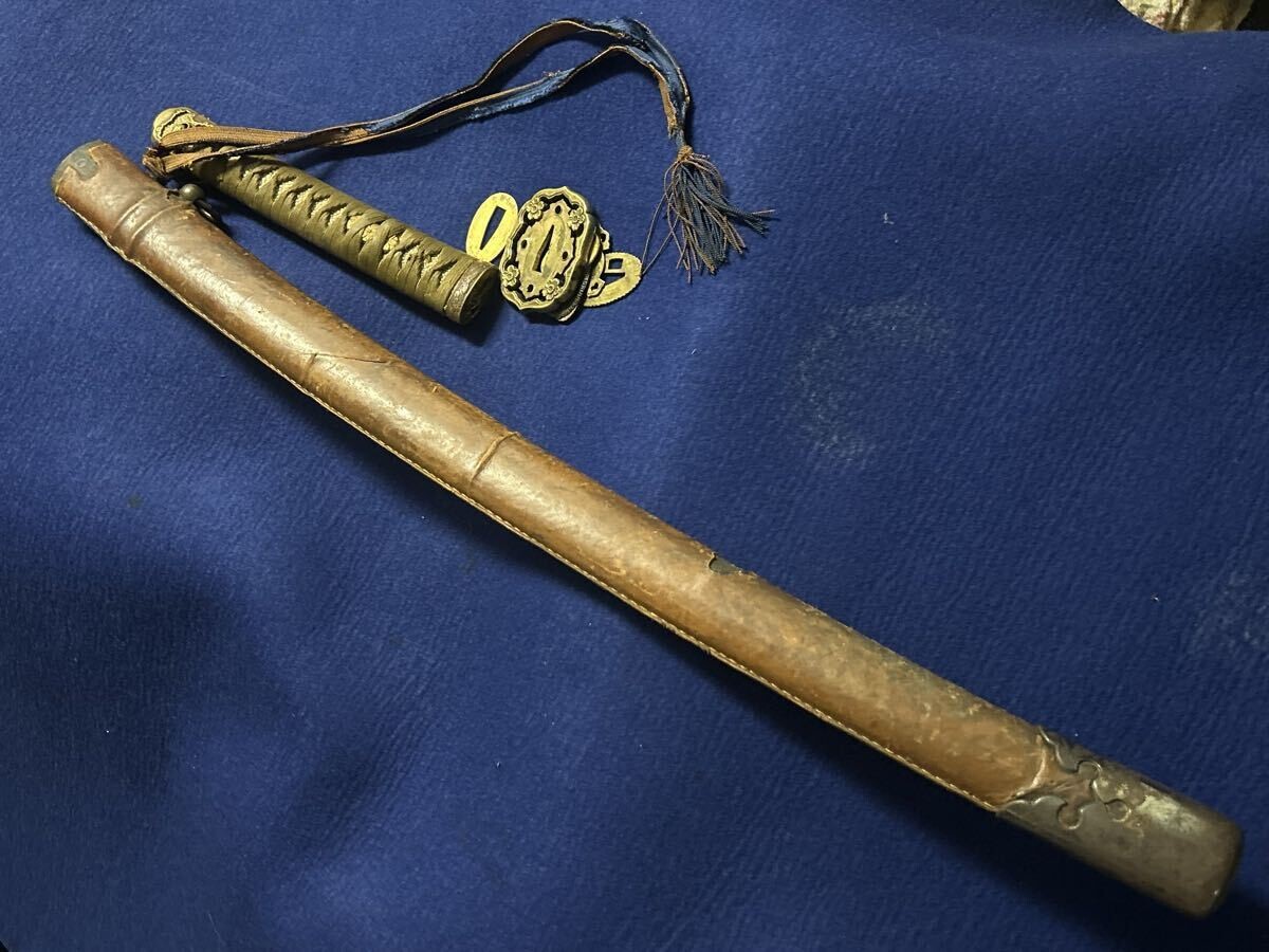

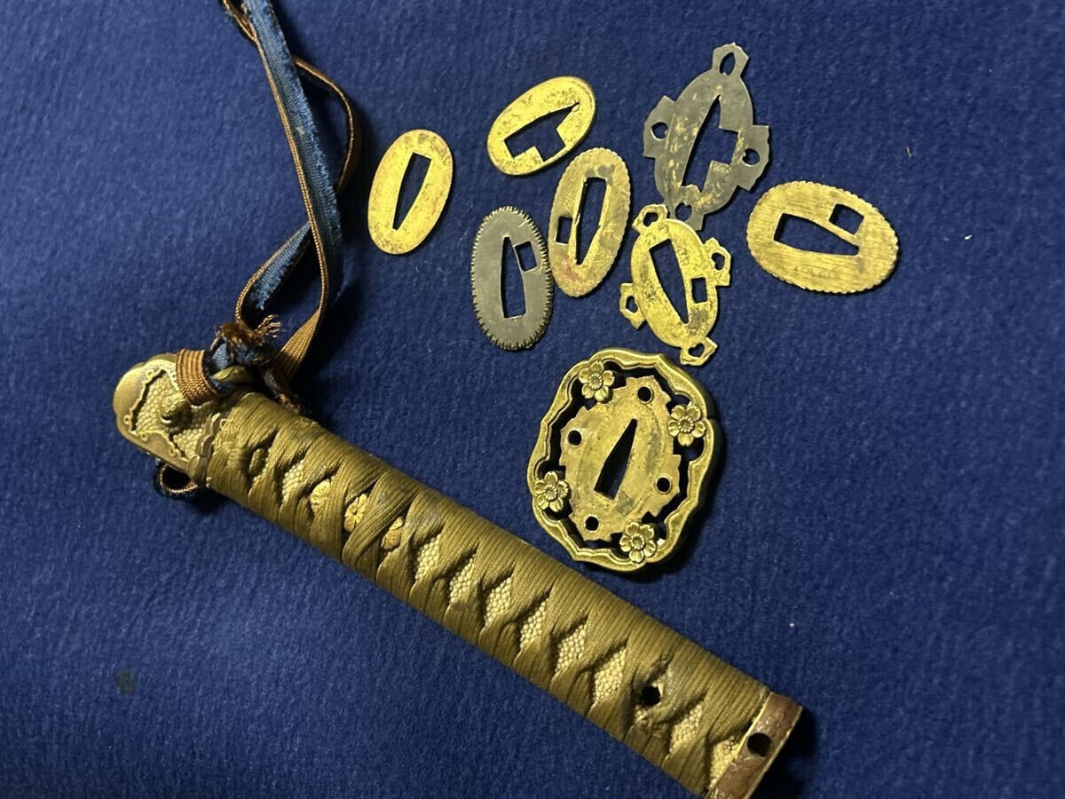

Marcin Posted July 23 Report Posted July 23 (edited) Droping open tsuba with drill holes in boar nose spot. Saya is also modified with iron kojiri. Clear put-together mix [chuso hole] yet tsuba shows signs of wear made by biggest seppa. Edited July 23 by Marcin Quote
