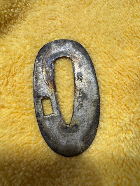

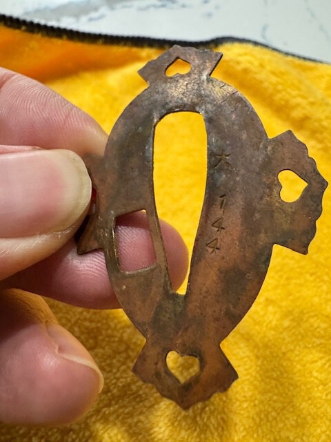

Bradenrn Posted May 27 Author Report Posted May 27 Hey Bruce, Thanks for the article. Here is a better image. Looks like 144? Sword is in relatively good shape. Tsuka is intact with only a small crack in the ray skin. I’m missing the mekugi. Only thing broken is the (chuso) the lock for the saya. Not sure there is a lot of resources in Ohio but happy I found this forum. Trying to decide if I want to try to repair myself or see if there is someone close to me to help restore. Quote

Bradenrn Posted Wednesday at 08:20 PM Author Report Posted Wednesday at 08:20 PM On 5/27/2025 at 12:50 PM, Bruce Pennington said: Thanks for the added photos, Braden! Your gunto is full of stuff that I track! Serial number is "NO 474" on the mune (back edge of nakago). That "144" is probably put there by a fittings shop. Are the other fittings, tsuba, seppe, etc, stamped with the number? The "W" is a mid-way inspection mark found on several blades of 1942 and '43. The 2 stamps on the kabutogane are unknown shop stamps - @Kiipu. Thomas may correct me, but I don't think we've seen those before. The single one on the other side is the inspector mark of the Tokyo 1st Army Arsenal. Yes all the fittings have the 144 on them. They also have a stamp next to the number. 1 Quote
Bruce Pennington Posted Thursday at 02:15 PM Report Posted Thursday at 02:15 PM Thanks Braden. In charting the stamped numbers on blades the practice started in the second half of 1941 on RJT blades and they all fit a distinct pattern through the years to 1945. On non-RJT blades. They also fit a pattern and begin in 1942. The pattern is different than RJT blades, in fact opposite, But the fact that they distinctly fit a pattern rather than be randomly placed around the nakago, implies to me that it was a regulated army practice, not just sword shops. You will see stamped numbers on navy blades, but they are pretty random on placement, implying to me again that this time it is sword shops, doing it on navy blades. Now, it could be the navy doing it and they just didn’t have an organized system, but at least for the army stamped numbers. It is very organized. I personally believe that the sword shops just piggybacked onto the numbers that were already there and used them on their fittings. 1 Quote
