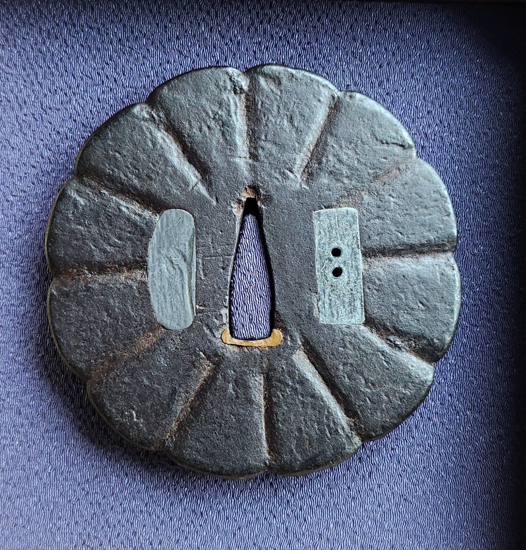

Sometimes the signature is faint, like on this Yamakichibei below.
I was excited to finally land a signed Saotome the other week.
It is probably the last thing I will buy out of Japan for a while, until the tariff and related shipping issues get minimized.
Will post an image of the signed Saotome when I get it.
  • Like 5
  • Love 2
  • Wow 2
Superb tsuba, Curran.  Many thanks for posting it.  So great to see a Juyo-class Yamakichibei, and to see it well-photographed.  Congratulations on this brilliant sword guard, my friend.  :clap::thumbsup:  And looking forward to seeing the Saotome, too.  Which Saotome smith is it, if I may ask?
  • Love 1

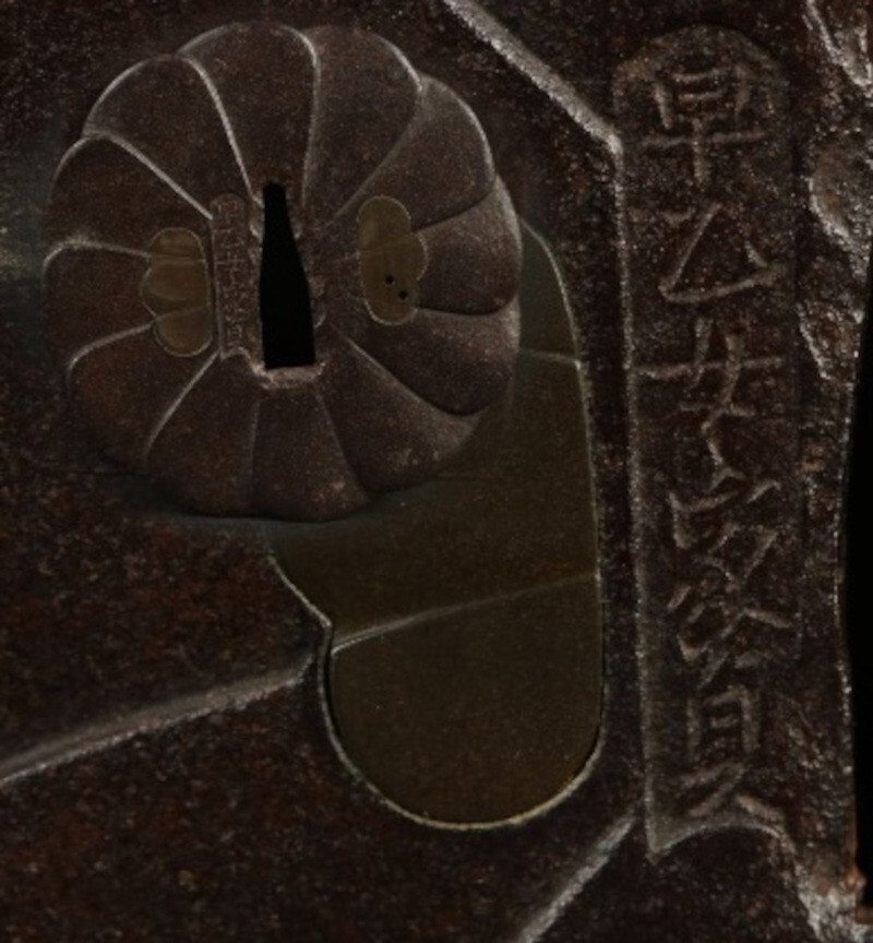

Saotome Iesada.
I'd like to think the 2nd gen fellow circa 1600-1650 who supposedly also made armor. We'll see once I have it hand.
A screen grab should be attached.
Given the design, I thought it might be a nice compare-contrast with the Yamakichibei.
  • Like 5
  • Love 1
Wow.  Great tsuba.  Fantastic pair of sword guards here.  The iron in these pieces is just killer.  Any reason this couldn't be first-generation Iesada?  Congrats again, Curran. and nicely done.  :clap:
According to Haynes Index, the first generation was 1550s'ish and didn't sign.
That aside, I would have guessed 1625-1665 by various points. Perhaps later given how wide the hitsu-ana are from the nakago ana.
Still, i like the signature being to the left in a column format similar to the way we see armor maker signature on helmets.
