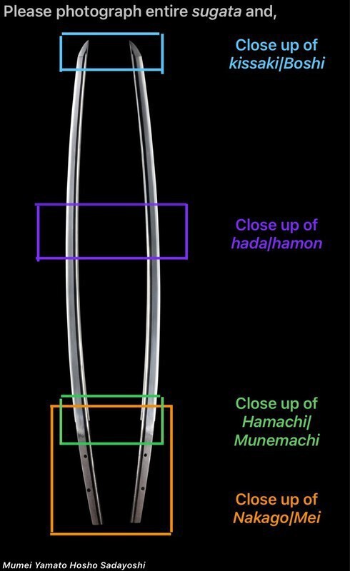

I made this guide recently to help folks take informative pictures of their swords. Taking photos against a dark and nonreflective background works best. As clear as you're able to.
Also take a photo of the entire sword without fittings, centered from above - so the general profile of the blade can be seen from tip to tang. Tip north, and tang south.
If you can get a good clear photo of all these things, it will help with identification. But keep in mind, that even perfect photographs might not be enough to definitively identify a blade, and expert in-hand assessment may be required (especially if condition is poor).
But with the right pictures, the experienced people here can provide info and steer you in the right direction.
