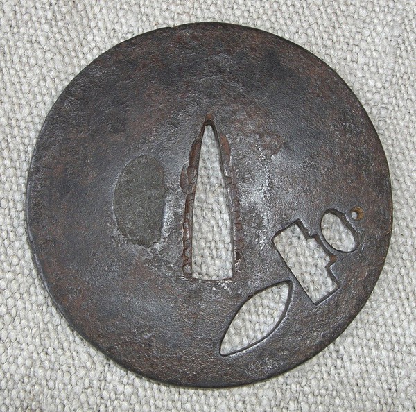

ROKUJURO Posted December 19, 2024 Report Posted December 19, 2024 8 hours ago, OceanoNox said: .....The roughness of sekigane in general seems to confirm this assumption. I assume it is the same for umegane, but the finish is quite much cleaner for umegane in general..... Arnaud, when mounted, SEKIGANE are not visible, while UMEGANE are exposed and can add to the overall beauty/looks of the respective TSUBA. By the way, UMEGANE are not always made from metal. I have one KO-TOSHO TSUBA with a lacquer UMEGANE (this would not be the correct term as it is not "GANE" = metal) 3 Quote

ROKUJURO Posted December 20, 2024 Report Posted December 20, 2024 KO-TOSHO TSUBA with lacquer HITSU filling: 1 Quote
