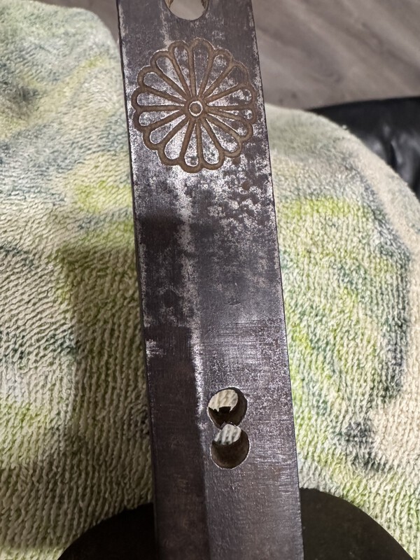

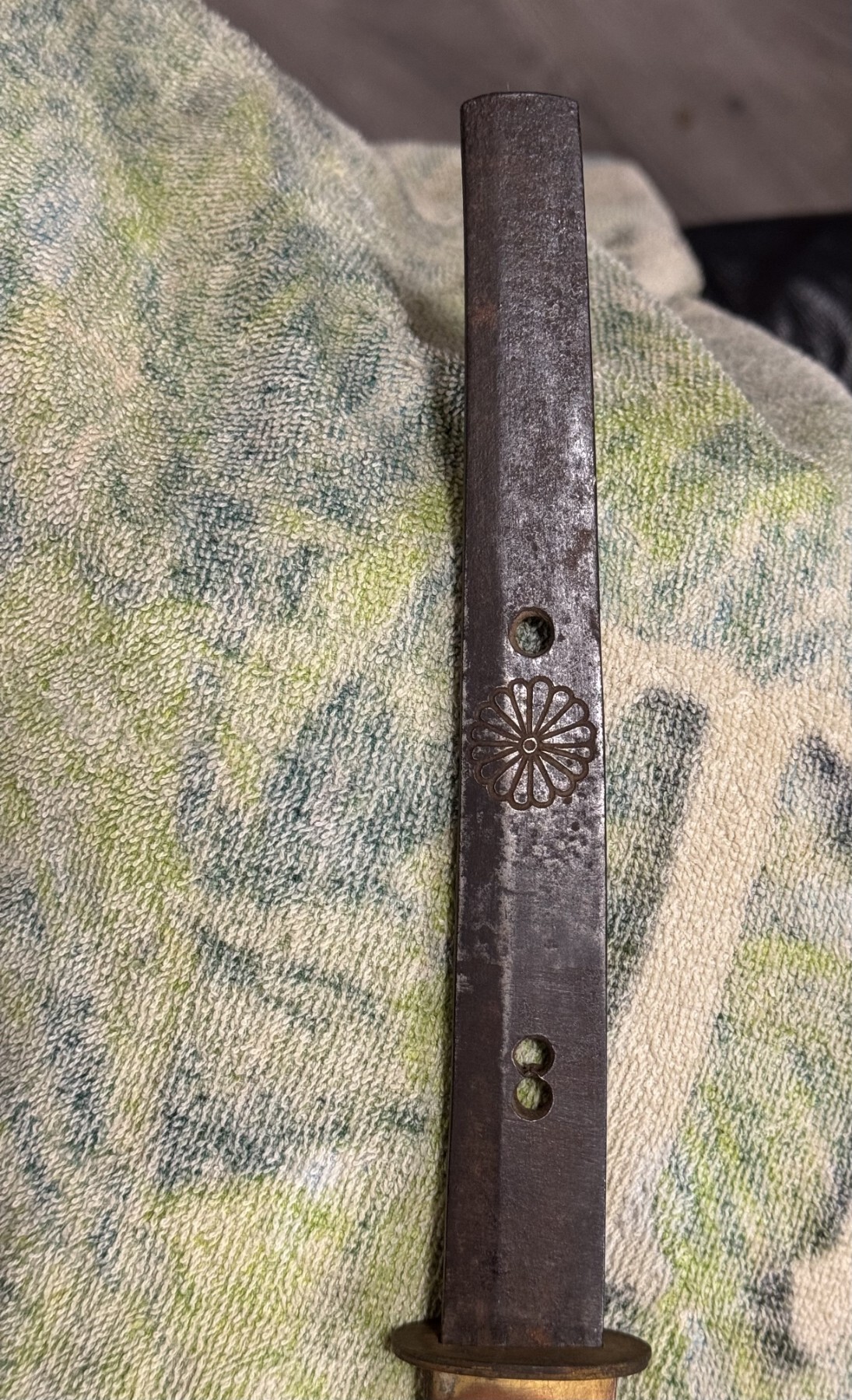

katonk66 Posted December 6, 2024 Report Posted December 6, 2024 Hello everyone. Here is an interesting wakizashi I own. Interesting that it doesn't have a mei, with a supposed kiku on the nakago. 1)Can I make an assumption that the kiku was added after the sword was made? 2)Is this sword early Edo? https://imgur.com/ga...ry/wakizashi-EkLCyXj Blade length:58.78cm/ 23.14 inches Curvature: 1.21cm / 0.47 inches Total length: 89.0cm/ 35.03 inches Blade Weight: 650.0g Total Weight: 1092.0g Thank you Henry Quote
Toryu2020 Posted December 7, 2024 Report Posted December 7, 2024 Very interesting. Perhaps you'll be able to match this to a known artist... -t Quote
Rivkin Posted December 7, 2024 Report Posted December 7, 2024 Most likely it is early Edo, but boshi would be helpful and hadori is so heavy one can't see the hamon unless its photographed at an angle, not from the top. Kiku mon was likely added at about the same time as when the sword was made. I don't feel its a great sword so it might be there is no perfect explanation why its just kikumon and no signature. Quote
katonk66 Posted December 7, 2024 Author Report Posted December 7, 2024 1 hour ago, Rivkin said: Most likely it is early Edo, but boshi would be helpful and hadori is so heavy one can't see the hamon unless its photographed at an angle, not from the top. Kiku mon was likely added at about the same time as when the sword was made. I don't feel its a great sword so it might be there is no perfect explanation why its just kikumon and no signature. Can you imagine, if groups like the NBTHK were able to take a time machine to the land of my ancestors back in the Edo period. Basically judge various swords and tell the swordsmith, "Yeah, not a great sword". I wonder what their reactions would be. LOL Quote
lonely panet Posted December 7, 2024 Report Posted December 7, 2024 i dont like that nakago at all, warning bells, alarms, peaple scrambling for cover..... i think that nakago has be put on after the fact Quote
Pincheck Posted December 7, 2024 Report Posted December 7, 2024 I can’t imagine why someone would go to the trouble of carving a kiku mon and then not sign it, but anything is possible. It could be that someone has removed what they thought was a gimei signature and repatinated the nakago. It looks like there might be a slight divot, a different texture and maybe a change in colour where a signature might have been. But that is pure speculation. Whatever it is, I like it. Quote

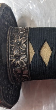

Bruce Pennington Posted December 7, 2024 Report Posted December 7, 2024 That's pretty cool, Henry! Don't know if you know, the the sakura pattern on the tsuba and seppa are of the Gunzoku. So a member of the civil branch of the military carried this during the war. Quote
katonk66 Posted December 7, 2024 Author Report Posted December 7, 2024 2 hours ago, Bruce Pennington said: That's pretty cool, Henry! Don't know if you know, the the sakura pattern on the tsuba and seppa are of the Gunzoku. So a member of the civil branch of the military carried this during the war. Thank you. For me at least, I don't want to make any assumptions, but yes...with the exception of the menuki, the theme of the day was sakura. Quote
katonk66 Posted December 7, 2024 Author Report Posted December 7, 2024 6 hours ago, Pincheck said: I can’t imagine why someone would go to the trouble of carving a kiku mon and then not sign it, but anything is possible. It could be that someone has removed what they thought was a gimei signature and repatinated the nakago. It looks like there might be a slight divot, a different texture and maybe a change in colour where a signature might have been. But that is pure speculation. Whatever it is, I like it. Thank you. Someone else I know that deals in in nihonto, said it "appeared" to be repatinated, after a possible gimei was filed off. But that is just speculation. Quote

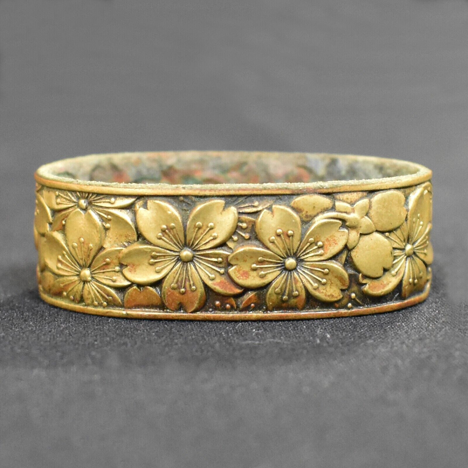

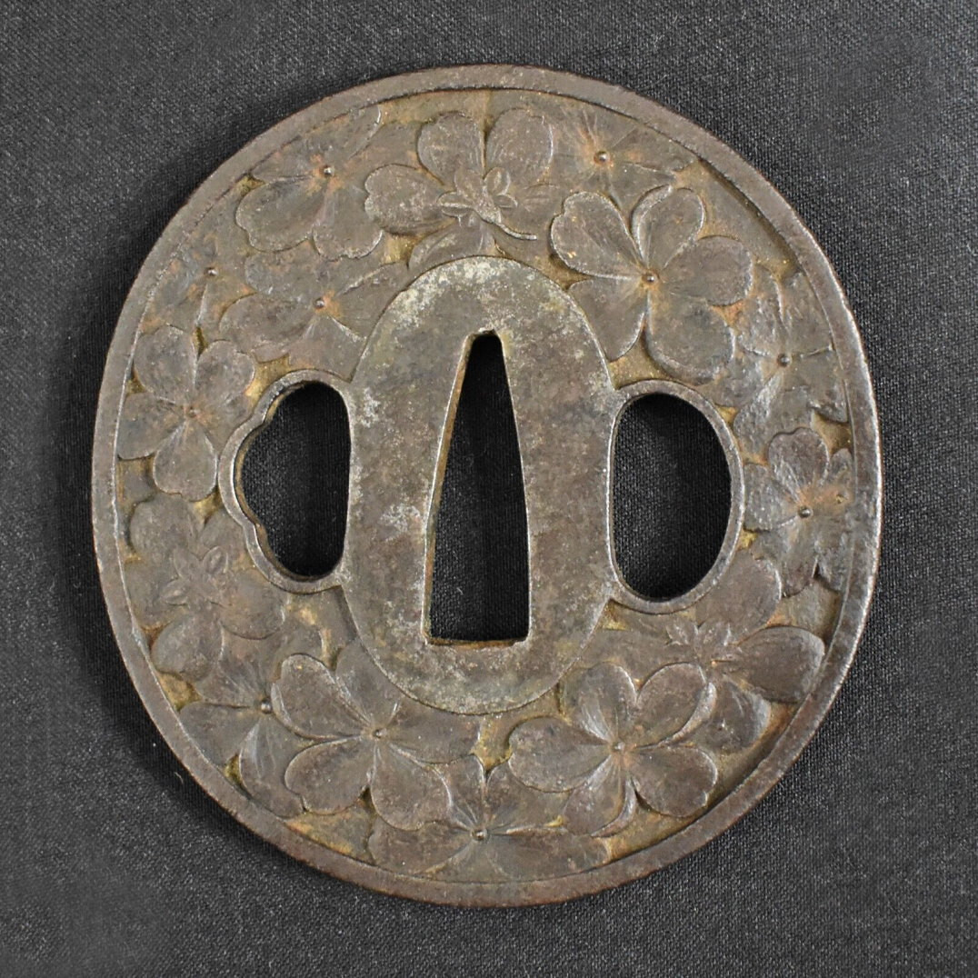

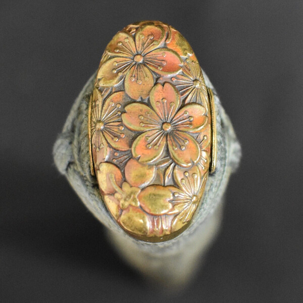

Bruce Pennington Posted December 7, 2024 Report Posted December 7, 2024 2 hours ago, katonk66 said: but yes...with the exception of the menuki, the theme of the day was sakura. Wow, that tsuba is unique! The kabutogane and fuchi are normal fare for Gunzoku though: The tsuba normally look like this: Quote
lonely panet Posted December 7, 2024 Report Posted December 7, 2024 can peaple seriously look past that weilded on nakago?? Quote
Bruce Pennington Posted January 23, 2025 Report Posted January 23, 2025 Posting photos, in case the imgur link goes dead in the future: Quote
Bruce Pennington Posted January 23, 2025 Report Posted January 23, 2025 Found another on this Gunboards thread. Quote
2devnul Posted January 24, 2025 Report Posted January 24, 2025 That cut on Nakago looks interesting. Like a cut through Tsuka all the way into Nakago. If there ware fingers/hand on the Tsuka then you can imagine what happened. Based on what I see (Kenjutsu techniques) and read/hear (historians) attacks on writs/hands/Tsuka was pretty common. Quote
Jacques Posted January 24, 2025 Report Posted January 24, 2025 Nakago looks to have been artificially aged Quote
