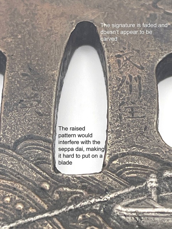

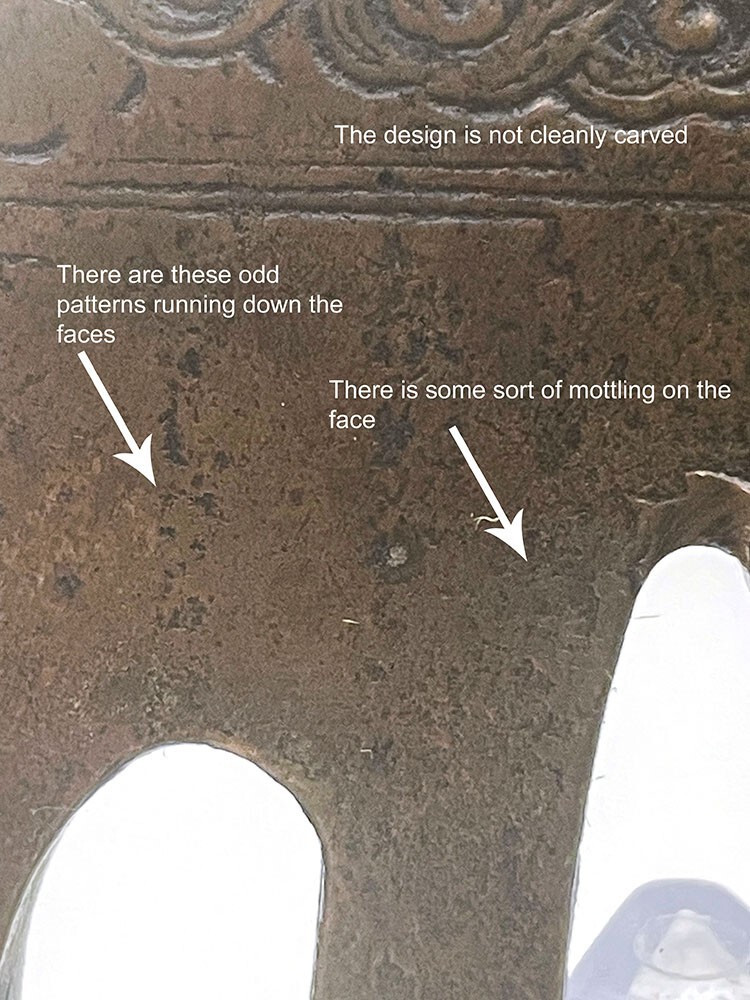

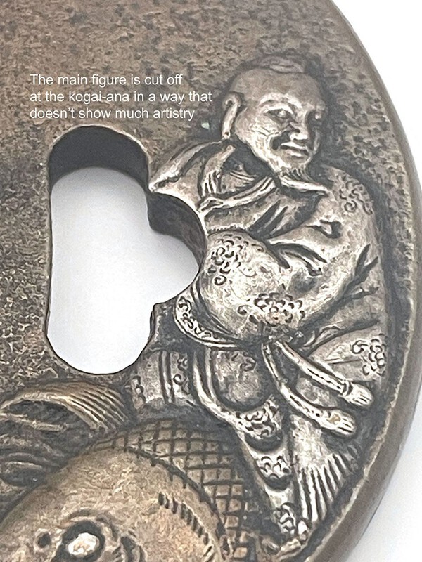

These images show what I have noticed about it that indicate that it is not really a good piece.

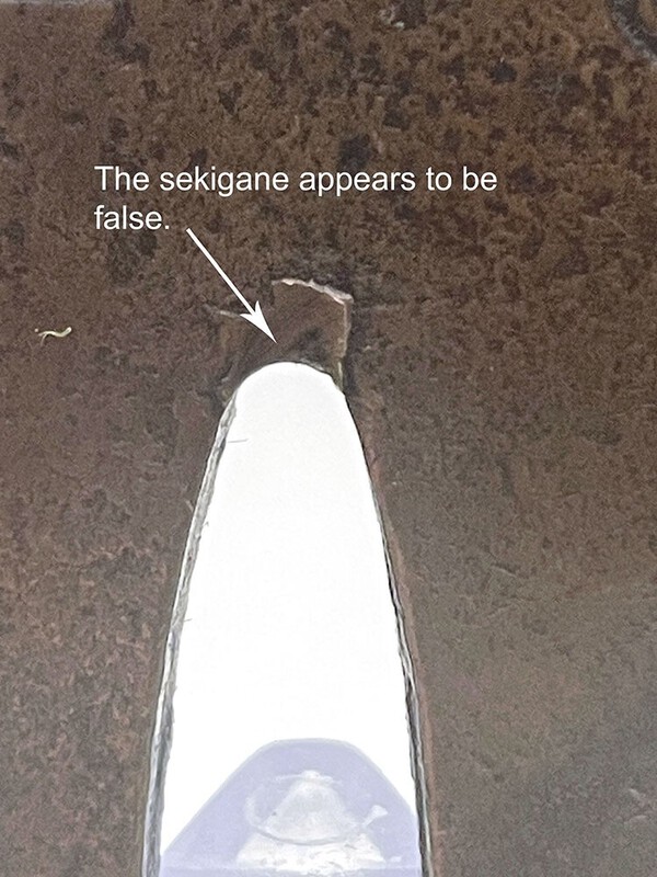

The sekigane looks like it is not actually another piece of metal, just a shape in the metal.

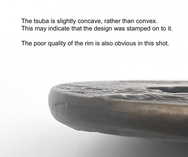

These patterns look like they are artefacts from either a casting or stamping process, but I am not entirely sure. The concave shape (see below) makes me think that it was stamped.

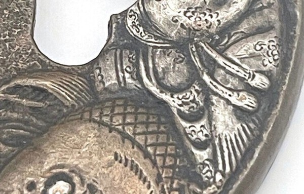

Also, the way the fish scales have been engraved/carved is extremely crude. Usually Japanese artists will take the time to carve them properly, and not by using  a hasty cross-cross pattern that in this case also extends beyond the intended boundaries.

Justyn,
the concave shape of the TSUBA plate is not necessary a sign of stamping. There are many hand-made TSUBA which show that feature.
Stamping could easily be done in any shape desired, be that flat, convex, or concave. But I agree that the TSUBA above is not authentic in the sense of a traditionally made Japanese swordguard.
Thanks for the info. I haven't seen many concave tsuba, so it's good to know that they are out there.
Katakiri carving with a chisel usually results in a sharp cut, meaning that the cross section of the cut will look like a "V". Cast copies won't have that feature, the cross sections will look like a "U". Dirt or other coatings may disguise the sharp cut. This is difficult to tell from a photo sometimes so may need to enlarge or use a magnifying glass. Another tell on these reproductions is the extensive use of silver. Silver was usually used to pick out small details.
