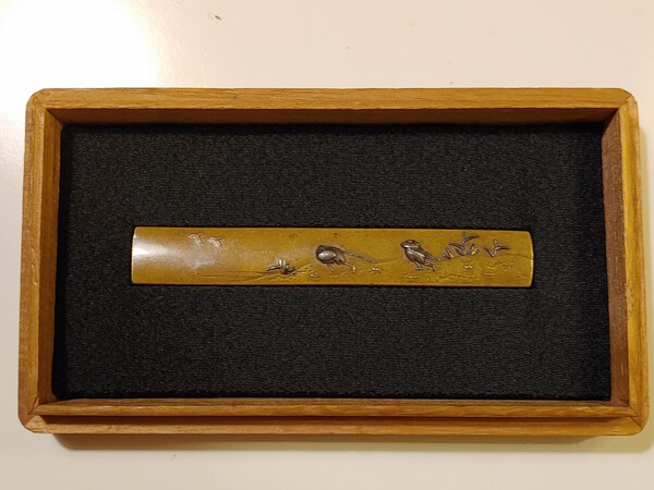

LeonLop Posted April 15 Report Share Posted April 15 I was wondering where people source their fitted (made to fit by recessed (denting) the internal base) wooden storage boxes for a Kozuka? I have already contacted Token Bijutsu Kogeisha but they do not make 'fitted' boxes - they just provide standard boxes with elastic securing straps (see images below). Can anyone suggest to whom I can contact to help me out.? Thanks Quote Link to comment Share on other sites More sharing options...

Andi B. Posted May 19 Report Share Posted May 19 Hi, I can recommend the great instructions from Paul Kremers' website tsuba.info. https://tsuba.info/making-a-kozuka-dai/ So I upgraded some of my old boxes... ...but if paulownia wood is available, it's not so difficult to make them too: 4 3 Quote Link to comment Share on other sites More sharing options...

Curran Posted May 19 Report Share Posted May 19 13 hours ago, Andi B. said: Hi, I can recommend the great instructions from Paul Kremers' website tsuba.info. https://tsuba.info/making-a-kozuka-dai/ So I upgraded some of my old boxes... ...but if paulownia wood is available, it's not so difficult to make them too: Impressive! Having fitted boxes and shifuku made in Japan is quite expensive. Mailing and agent fees have risen a good bit after the Pandemic. I don't think people realize how much expense that tacks on to an item. For it to be cost effective, I only do so about every 2 years: usually with one or two friends joining in. If sending to shinsa in Japan, best to have the boxes made then. As I get more to the high TH and low Juyo end of the spectrum, most come with papers, fitted box, and shifuku. Heaven knows when I will have more fitted boxes made, though I have two good ones out of the woodwork in the last year that will eventually need a higher end box. Quote Link to comment Share on other sites More sharing options...
