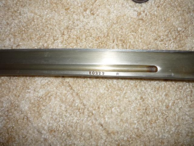

cisco-san Posted October 24, 2009 Report Posted October 24, 2009 Hallo, I intend to buy a Type 95 Army sword In general it look genuine - but the Kokura stamp makes me very confused :? I found a lot of stamps in my book, on the Web... - but no three cannonball stamp?! Therefore I would kindly ask for your opinion. Many thanks in advance. Quote

cisco-san Posted October 24, 2009 Author Report Posted October 24, 2009 .....attached some photos from the sword Quote

Brian Posted October 24, 2009 Report Posted October 24, 2009 I don't have the time right now to go and look at Dawson's book to verify this one, but i would be very cautious. I don't like where the hi starts, and the serial number or arsenal marks. Something makes me cautious about this one. It is also trying to be one of the scarce copper handled ones, so be doubly cautious. Maybe it is right...but there are a LOT of good fakes out there. Brian Quote
Tom Clancy Posted October 24, 2009 Report Posted October 24, 2009 In my opinion I would pass this by, cannon balls not right, serial numbers not right, and the fuller should start almost at the habaki. Plus hilt is neither aluminium or copper. Tom Quote

Bruno Posted October 24, 2009 Report Posted October 24, 2009 Hello everyone! I read somewhere in a book(do not remember the title) that copper handle NCO where the first NCO model produced. Their serial number were from number 1 to number 5000(aproximately). Then, they started to produced the aluminium handle one. This NCO has a copper handle and serial number 50322, so I think the NCO is a chinese reproduction. It is only my opinion. I hope that help. Bruno Quote
Brian Posted October 24, 2009 Report Posted October 24, 2009 Klaus, Had a chance to check the Dawson book. I am now pretty certain that it is a bad fake. The arsenal marks are totally wrong, and the fuller is wrong. I would avoid this one. Brian Quote
cisco-san Posted October 24, 2009 Author Report Posted October 24, 2009 Klaus,Had a chance to check the Dawson book. I am now pretty certain that it is a bad fake. The arsenal marks are totally wrong, and the fuller is wrong. I would avoid this one. Brian Dear Brian, many thanks for your comment. During the afternoon I checked also the Dawson book and came to the same conclusion because nothing matched and I think the hilt is brass. Sorry for that this stupid question (english is not my native language), but what is the fuller? @all: many thanks for helping me Quote

Dave0258 Posted October 24, 2009 Report Posted October 24, 2009 Klaus, Servus, Dawson's book points out that all Type 95 swords with a copper fuchi have 3 stamps. The one you are looking at appears to have only two, and is missing the corporate logo. The arsenal identification (Tokyo arsenal in this case, with 4 cannonballs) should be on the right, and the arsenal inpection mark (to) in the center. So I would classify this as a fake. Additionally, the 4 cannonball stamp seem to have some of the circles off-center. Based on the legitimate Type 30 bayonet I have (which also displays this stamp), this seems to be a sloppy reproduction. I doubt the arsenal at Tokyo had to stamp four eparate circles. My bet is they had a stamp with all four circles already set and spaced. I would stay away from this one. Too many things wrong. And despite living in Vienna, Austria for 3 years, I too am hoping to hear what a Muhlikuh is. I am embarassed to say I do not know. Nevermind. I just saw your explanation. I always did have problem with the Austrian dialects. Regards,, Dave Quote

Weidas Posted October 27, 2009 Report Posted October 27, 2009 this one is 200% fake. Have one alike from my beginner days, when i was jumping on everything which was referred to Japan without at least basic knowlage. Luckily i paid not too much for that junk... Quote
Weidas Posted October 27, 2009 Report Posted October 27, 2009 and by the way this is quite poor fake - begining from fuller and finishing with mixing of both arsenals into one - number on blade is placed as Nagoya, inspection mark refers to Tokyo, arsenal mark on fuchi misses one more canonball, producer mark missing, drag on scabbard looks like of Tokyo... Forget it, Klaus Quote
David Price Posted October 27, 2009 Report Posted October 27, 2009 Is it just me or does the "To" stamp on the fuchi look like it is photo-etched? Dave P Quote
