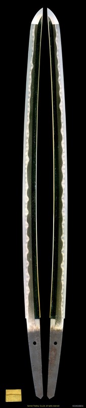

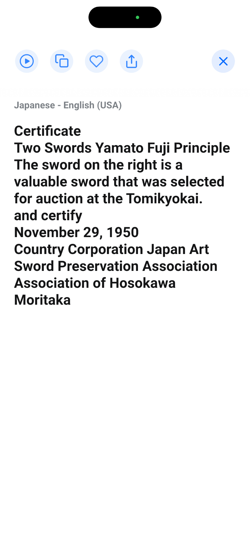

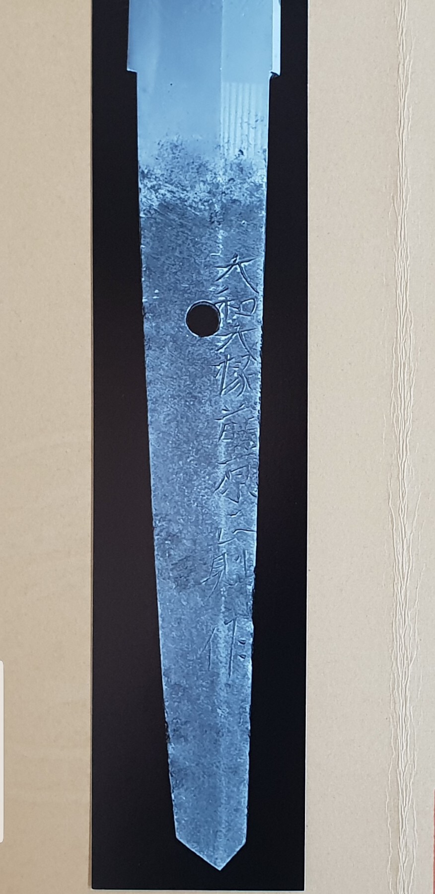

Ben-W Posted October 28, 2023 Report Posted October 28, 2023 Hi, I'm surely one of the least experienced person on this forum in relation to Nihonto. The good news is, recently while travelling in Japan I became a first time custodian of two Nihonto, one of which was signed Yamato Daijo Fujiwara Masanori. Also appraised as Tokobetsu Hozon. I've spent the past few weeks researching Yamato Daijo Fujiwara Masanori. I can share my findings. There were two smiths who signed Yamato Daijo Fujiwara Masanori in Echizen province 1600's. The first generation Masanori. (referred to as shodai) And the second generation Masanori. (Second generation referred to Nidai) In the book named, Japanese Sword Smith directory, Japanese edition (which is in English) by Mishina Kenji, I've found the following information (photos attached. Reference: Ma - 121 rank C) You can also investigate the province Shodai Masanori worked in to find who was the Daimyo of Fukui domain during this period. This timeline is very close to the battle of Sekigahara which marks the beginning of the Tokugawa Shogunate. Daimyo of Fukui domain in Echizen province 1601/1607 - Yūki Hideyasu (Seond son of the first Tokugawa Shogun, Tokugawa Ieyasu) https://en.m.wikipedia.org/wiki/Yūki_Hideyasu Succeeding Yūki Hideyasu was his eldest son, Matsudaira Tadanao. Daimyo of Fukui domain in Echizen province 1607 - 1622 https://en.m.wikiped...i/Matsudaira_Tadanao As referenced, Tadanao was banished and replaced by his younger brother and second son of Yūki Hideyasu; Matsudaira Tadamasa Daimyo of Fukui domain in Echizen province 1623 - 1645 https://en.m.wikiped.../Matsudaira_Tadamasa If your katana is first generation Masanori, The probabilities are it was forged during the reign of one of the above Daimyo. What historical battles may have Shodai Masanori katana possibly seen? If it was forged early enough, The siege of Osaka 1614 to 1615. https://en.m.wikiped.../wiki/Siege_of_Osaka Samurai of Fukui, Echizen province were sent to Siege of Osaka under the Daimyo Matsudaira Tadanao. Some additional research can begin from other names referenced in the photos such as; Sanjo Yoshinori, which Masanori is referenced as being a descendant (I lack further information for now) The smith he apprenticed under; Kanenori. I'm guessing, of Fukui, Echizen Domain early 1600s And other references Ive read saying he was the son of a Norimitsu (again, lack further information) This is all I've found so far. When you come across further information, I would also love to hear. Cheers, Ben 5 1 Quote
Baba Yaga Posted October 28, 2023 Report Posted October 28, 2023 I'm kind of confused, but what else is new. You both have TH papers on the same smith but the papers vague on the generation of Masanori? Quote
J-Dubb627 Posted November 8, 2023 Author Report Posted November 8, 2023 @Ben-W Thanks for all of the information you shared! Here is some information (matches alot of what you said) that I have on him. My blade is from the first generation Masanori and I, too, have wondered if it had any involvement in the Siege of Osaka Castle. This blade was forged by Yamato Daijyo Fijiwara Masanori(大和大掾藤原正則), who was born in Miyatsu city, Tango koku (northern Koyoto prefecture). Based on his remaining work, he was active during the early Edo period (the 13th year of Keisho-the fourth year of Keian:1608-1651). Masanori is famous for having forged extremely sharp blades and was popular among high-class Samurai. It is said that he was a descendant of Yamashiro koku Sanjyo Yoshinori(山城国三条吉則), one of the most famous swordsmiths during the Muromachi period(Prior to Edo period).After learning the sword-forging technique from his father, Norimitsu(則光) in Miyatsu city, Norimitsu, he moved to Kyoto city. Masanori eventually was noticed and supported by Matsudaira Hideyasu, the third son of Tokugawa Ieyasu, the founder of the Edo government. Hideysu was the feudal lord of Echizen province during the early Edo period. He then moved to Echizen province to serve the Matsudaira clan. He became an Okakaekaji for Matsudaira Tadanao(松平忠直), who was the first son of Matsudaira Hideyasu. An Okakaekaji means those who exclusively forged swords for specific Samurai or clan. It was honorable for any makers to serve this position back then. He also received an official title of Yamato Daijyo from the emperor for his excellent craftsmanship. 1 Quote
J-Dubb627 Posted November 8, 2023 Author Report Posted November 8, 2023 On 10/28/2023 at 9:17 AM, Baba Yaga said: I'm kind of confused, but what else is new. You both have TH papers on the same smith but the papers vague on the generation of Masanori? No, mine is first gen Masanori Quote
Ben-W Posted November 10, 2023 Report Posted November 10, 2023 On 10/29/2023 at 1:17 AM, Baba Yaga said: I'm kind of confused, but what else is new. You both have TH papers on the same smith but the papers vague on the generation of Masanori? Hi, The Masanori I took ownership of was still in transit when you first posted, I was awaiting arrival before replying. I would say my certificate is a bit vague but, then again, I'm new. The shop in Japan I purchased from stated it was first gen Masanori. http://sanmei.com/co...nts/en-us/p2392.html I myself am unable to read Japanese, and all I have received is the NBTHK certificate, no further documentation. (Although it did have the original papers from 1960.) Using Google to translate the Tokubetsu Hozon certificate, It appears to restate what is signed on the nakago and no further information. I will post a photo. When it comes to the NBTHK providing certificates for blades from known smiths which do have signatures but, have multiple generations of smiths signing the same name, does the NBTHK usually assign to which generation it belongs? Many thanks, Ben Quote

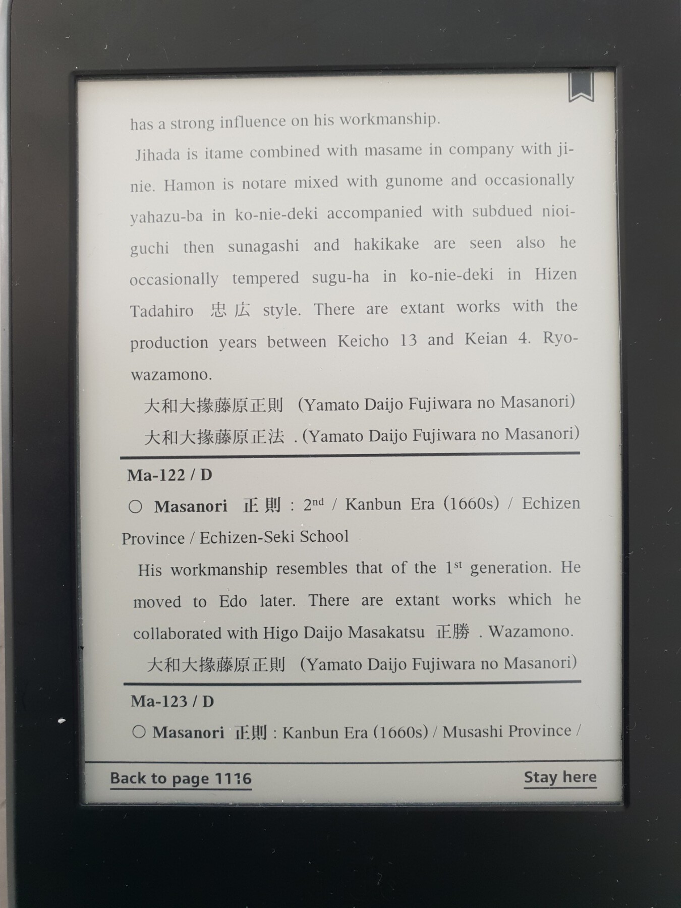

Shugyosha Posted November 10, 2023 Report Posted November 10, 2023 Hi Ben, The NBTHK does sometimes assign a blade to a particular generation of smith but often not, and not on the paper above. As you say, it just confirms the smith's signature and so it's a case of looking at the work and signatures of each generation to try to attribute it to one or the other. There's some information below on the two generations of smith with examples of the signatures of both (in the link of the final post). For me, the overall shape of your blade looks more like that prevalent in the Kanbun (straightish, chu kissaki) era rather than the Keicho era (extended chu kissaki), so 2nd generation, though the citation from Markus Sesko's book suggests that the signatures of both are similarly "spiderish" and different to that on the papered 2nd generation blade pictured by the OP. That said, my opinion isn't worth that much and you may get better ones shortly. 4 Quote
J-Dubb627 Posted November 10, 2023 Author Report Posted November 10, 2023 @Ben-W the picture of the sword you posted looks beautiful. While no two swords are exactly alike, yours does appear to look slightly different than mine. Just based on the photo, it looks like your blade width is wider and the curvature to your blade is straighter than mine, although that does not rule out that our swords were made by the same Smith. The place in Tokyo where I purchased my sword said that the certificates don’t always state what generation when there are Smiths with the same name. They did, however, say that if it is a later generation then the certificate sometimes would be marked with Kodai (meaning late generation). Quote

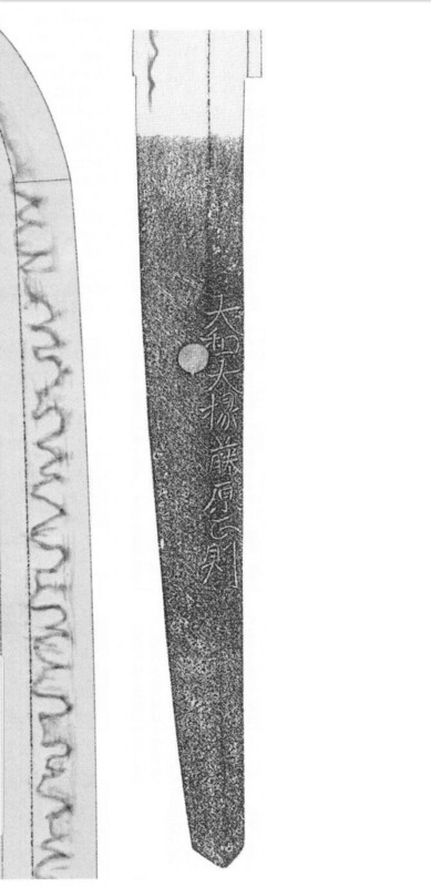

Ben-W Posted November 11, 2023 Report Posted November 11, 2023 Thanks Shugyosha and Geraint for supplying reference to Markus's book. I also appreciate you clarifying my question about the certificates. Analyzing the reference provided from Markus, I've noticed similarities between the blade in question and the 2nd Gen Masanori. (1) 2nd Gen Masanori: Markus reference Nagasa: 61.5cm Sori: 0.9cm This Masanori Nagasa: 61.5cm Sori: 1.0cm (2) In relation to the signature, with characters 1# Yama, 3# Dai The top stroke runs much higher on the 1st gen compared to the 2nd gen. (1st Gen Masanori: Markus Reference below) The kanji in location 1# and 3# on this blade looks uniquely similar to the 2nd Gen. (2nd Gen Masanori: Markus Reference below) (This Masanori below) (3) For this blade, the end of the nakago has a very sharp angle, it's almost a point. This also appears more prominently on the 2nd gen referenced by Markus. In relation to characteristics of forging and the hamon, that's still beyond my ability to comment. In addition Shugyosha, you noted by the shape it's more likely from the kanbun period 1661-1673, which I believe aligns closer with the window of 2nd Gen Masanori. Based on those observations I would more lean towards this blade being 2nd generation if I was making an estimate. Welcoming any further input Quote
Ben-W Posted November 11, 2023 Report Posted November 11, 2023 On 11/11/2023 at 2:17 AM, J-Dubb627 said: @Ben-W the picture of the sword you posted looks beautiful. While no two swords are exactly alike, yours does appear to look slightly different than mine. Just based on the photo, it looks like your blade width is wider and the curvature to your blade is straighter than mine, although that does not rule out that our swords were made by the same Smith. The place in Tokyo where I purchased my sword said that the certificates don’t always state what generation when there are Smiths with the same name. They did, however, say that if it is a later generation then the certificate sometimes would be marked with Kodai (meaning late generation). Thanks Josh, I have a few more screenshots I can share about 1st Gen Masanori from an older document. I'll get those up for you soon. Quote

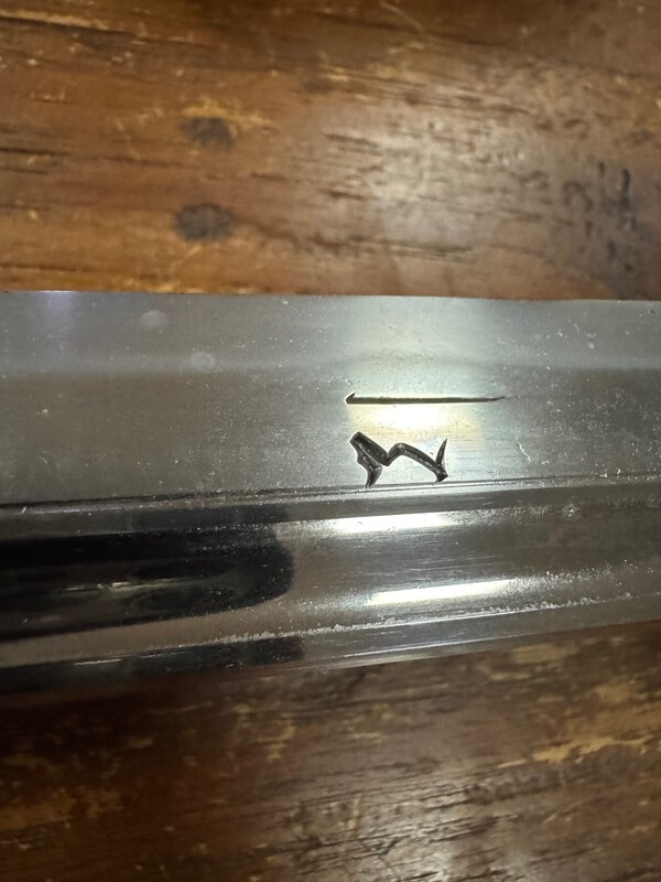

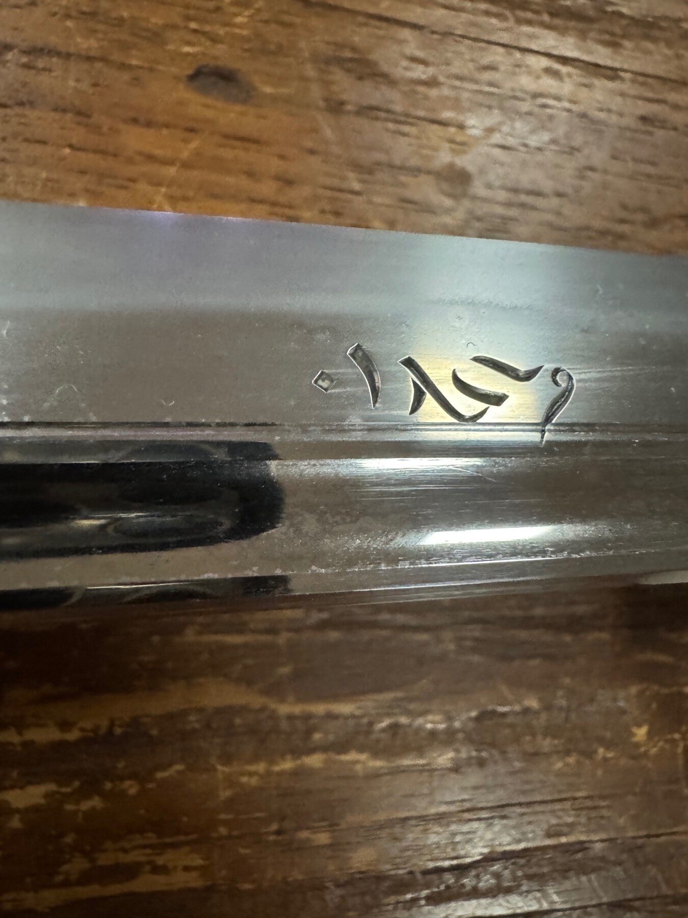

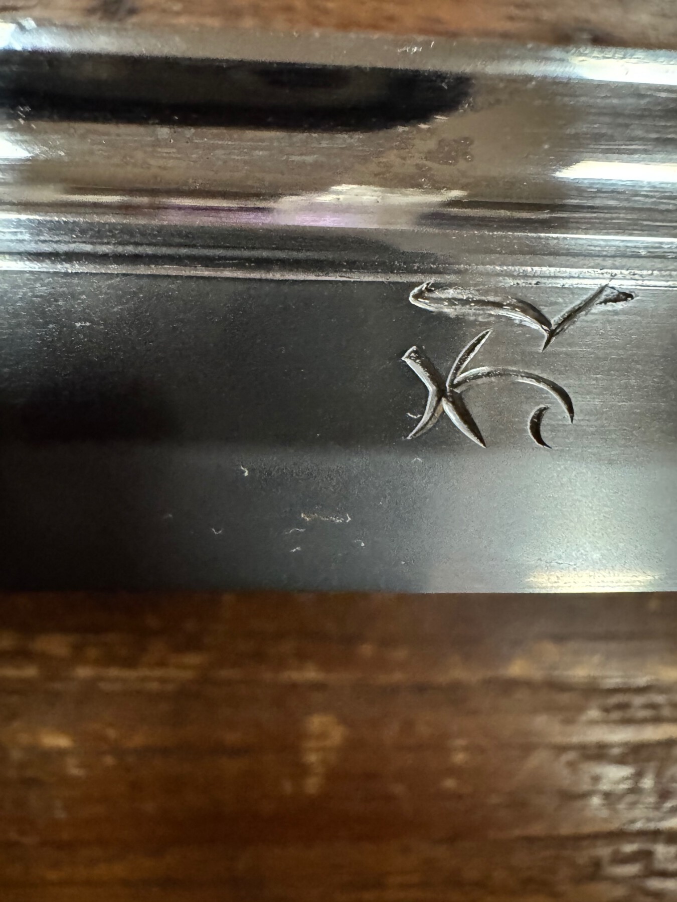

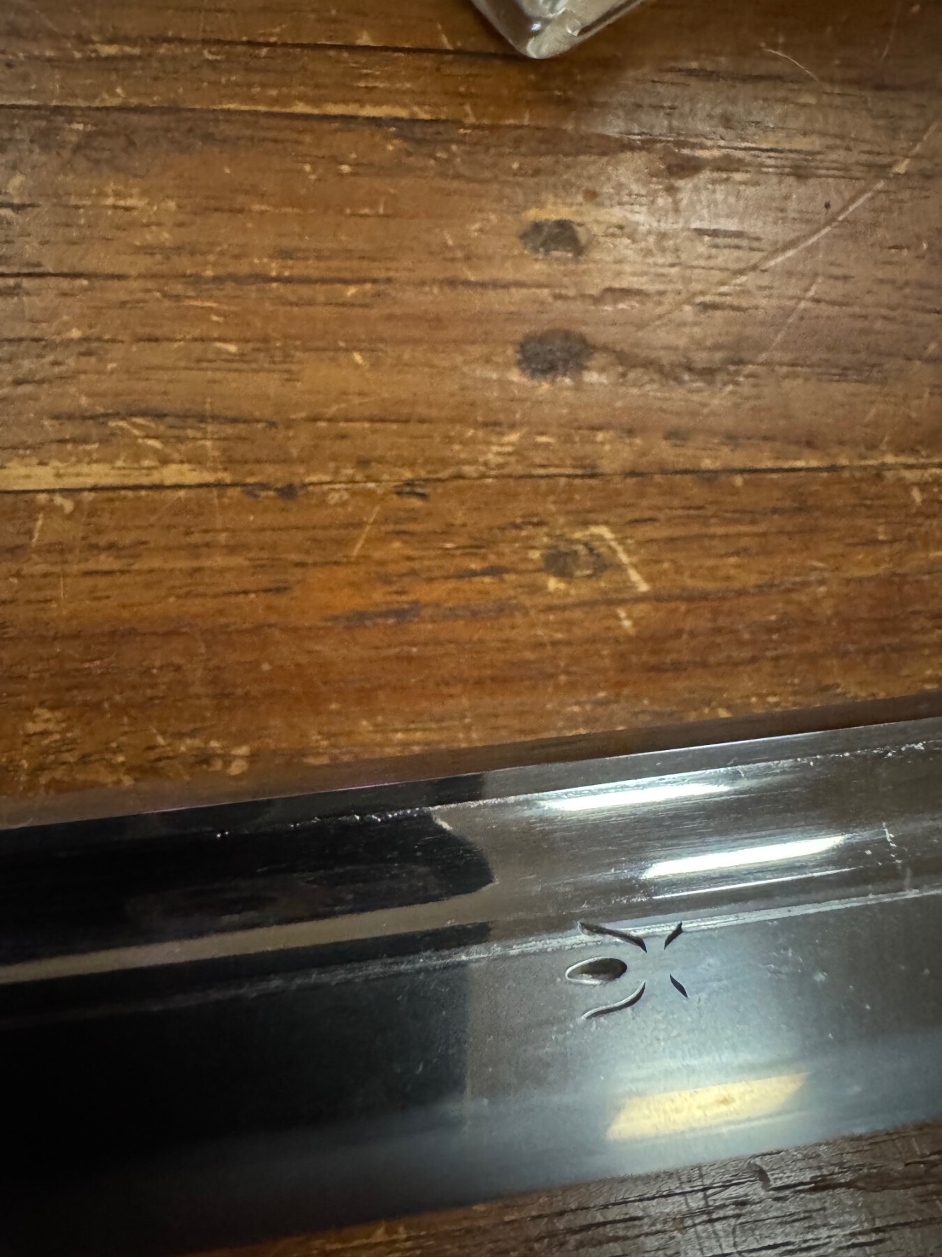

Shoebedo808 Posted March 16, 2025 Report Posted March 16, 2025 Greetings all, I also have a beautiful sword forged by Yamato Daijo Fujiwara Masanori. I will post some pictures tomorrow. I believe mine to be early generation. It has multiple symbols (both sides) on the blade. I’m trying to find out what they mean. I’ve been told they look like Buddhist symbols. Forrest Quote
Shoebedo808 Posted March 18, 2025 Report Posted March 18, 2025 Here are the various symbols on the blade I would love to have interpreted: Quote
Shoebedo808 Posted March 18, 2025 Report Posted March 18, 2025 Any help is greatly appreciated! Quote
Lewis B Posted March 18, 2025 Report Posted March 18, 2025 They are called Bonji and usually have a Buddhist religious significance. The script is Sanskrit. 1 Quote
Shugyosha Posted March 18, 2025 Report Posted March 18, 2025 Hi Forrest, The one in the last photograph is a rendai: a representation of the lotus-shaped platform or seat on which images of Buddha are shown. The others are, as Lewis says, bonji and there is a list here and it's a case of matching the ones on your sword up with those in the chart: Quote

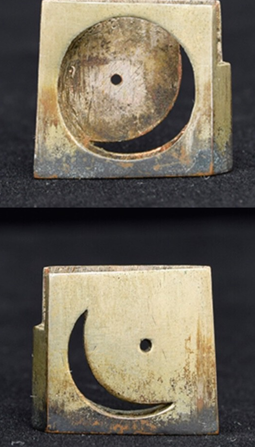

Lewis B Posted May 27 Report Posted May 27 (edited) 3 hours ago, eternal_newbie said: Perhaps it wouldn't surprise you to learn that some in the Nihonto world (mostly in the West) feel that way too; I've seen folks on here back in the day arguing that polishing an old blade is taking away part of its history. Funny you say that. I debated long and hard whether to restore this habaki. I found the 'patina' not unattractive and felt restoring it would diminish some of that 'history' to which you are referring. In the end I decided on restoration since the blade was getting a fresh polish and it fit a little loose on the blade. Edited May 27 by Lewis B 1 Quote

eternal_newbie Posted May 27 Report Posted May 27 1 hour ago, Lewis B said: I debated long and hard whether to restore this habaki. I found the 'patina' not unattractive and felt restoring it would diminish some of that 'history' to which you are referring. It's rarely an easy choice - aside from the costs, there's also the risks of a restoration going bad, getting stuck in an expanding queue, going lost in transition, major or even fatal flaws being uncovered in the process etc. In the end all we can do is use our best judgement in deciding the best way to curate and preserve these items so that future generations may enjoy them as well. 1 Quote
