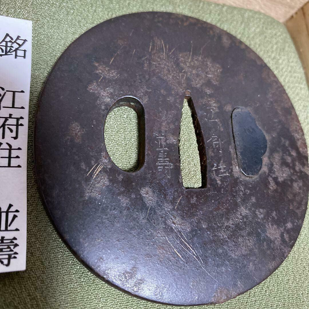

There is a 並壽 Namitoshi - abundantly represented in the thread linked above - who was a student of Tatsutoshi. Maybe it's the one mentioned in Piers' book, and Tsunetoshi was in turn his student?
To console Xander, this Namitoshi tsuba from the other thread looks similar to his, but in even worse condition...
bad_Namitoshi.jpg.bb7233b40b1d09d33b3a7cd9d3f27d43.thumb.jpg.5a767dda6675e49ea6e1676173e157dc.jpg
There is only one Namitoshi listed, in Edo, and he is described as being a student of Inoue Tatsutoshi, and as making many iron sukashi tsuba, around Koka. (Reverting to the easier modern Kanji here).
p133 古今金工全集
Quote
並寿、江戸、井上辰寿の門人、鉄透かし鍔の作多し。弘化

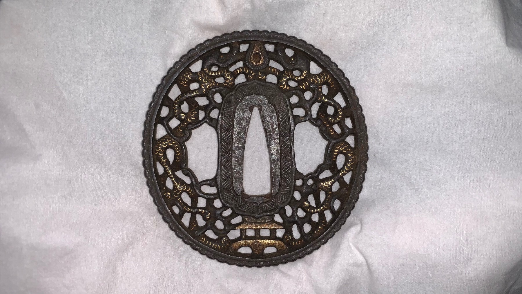

These are the last 2 of the batch. I’m guessing the one on top has a chidori design. What are those things behind the torii gate on the bottom tsuba? They remind me of something you’d find under the sea but there are birds so that’s definitely wrong.

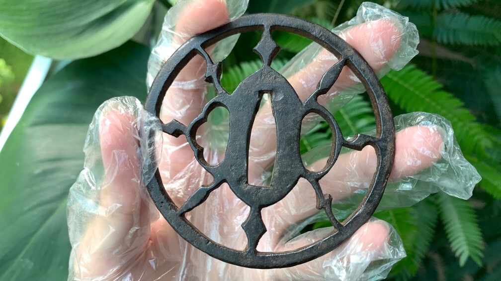

In the spirit of this thread, this tsuba passed by couple weeks ago.
Odd openwork and at first glance an odd copper tsuba but the (apologies, correct term for the pattern escapes me atm), careful outward radiating grooves (sunbeams from point on horizon), made me think it was perhaps more interesting than I gave it credit for, only having half-recorded seeing it while browsing. Maybe new and not a masterwork but interesting I thought. Interested in opinions on what it is. Thank you in advance.
Because the thread went silent > bump for more feedback on this tsuba. Would love to hear more impressions/thoughts on it. I like it but have no real idea on what it is or what school or modern worker might be responsible for it. Thanks in advance.
Thanks for the identification of the tsuba up top Dale. Any clue what the “pillar” looking things in the background of the second tsuba are supposed to be?
Xander, from their placement in the background they must be trees of a considerable size, if it was a European landscape I would say Poplar trees and there is a species of Poplar native to Japan/Korea and Mongolia. They could also be "Maidenhair" or "Ginkgo Biloba" from the gold colour. Or any number of tall pine trees. Impossible to be definite. If they were in the foreground you might expect to see "horsetails" Jap. [sugina (杉菜)] or reeds. But the size and placement of the Torii makes that unlikely. You might have to put it down as "Artistic license" the gnarled tree in front looks huge. The flying geese must be close to the observer as they all look the same size. JMO

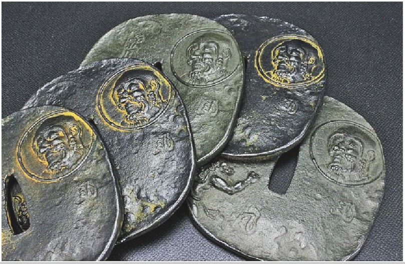

I found 3 tsuba which look quite similar to one another. Are these cast copies? The first 2 pictures also look like they are the same tsuba judging from the sekigane. Would be happy to hear everyone’s thoughts on this.

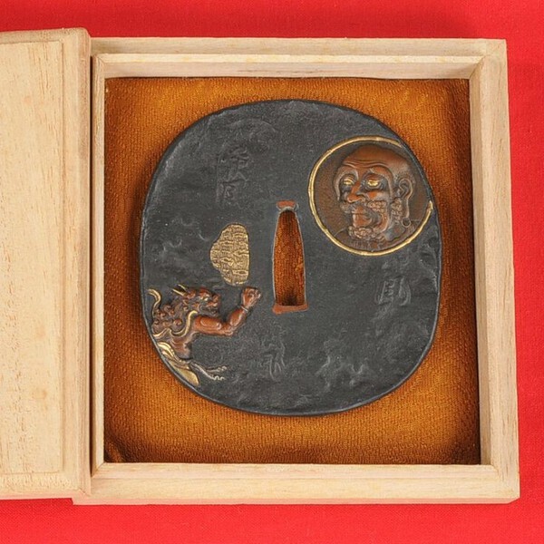

These are expertly done 'replicas' there are thousands of these - believe me thousands! Two general types - [1] those like your images with 'iroe' or colouring and [2] a plain one metal colour lot. Attached is an image from a bulk buy auction of the plain coloured ones - cheaper by the dozen! I have seen one mounted sword with the same design tsuba which may have been the pattern the rest are taken from, but with so many about I wouldn't be one hundred percent sure. These are not utsushi there is no individuality in them.

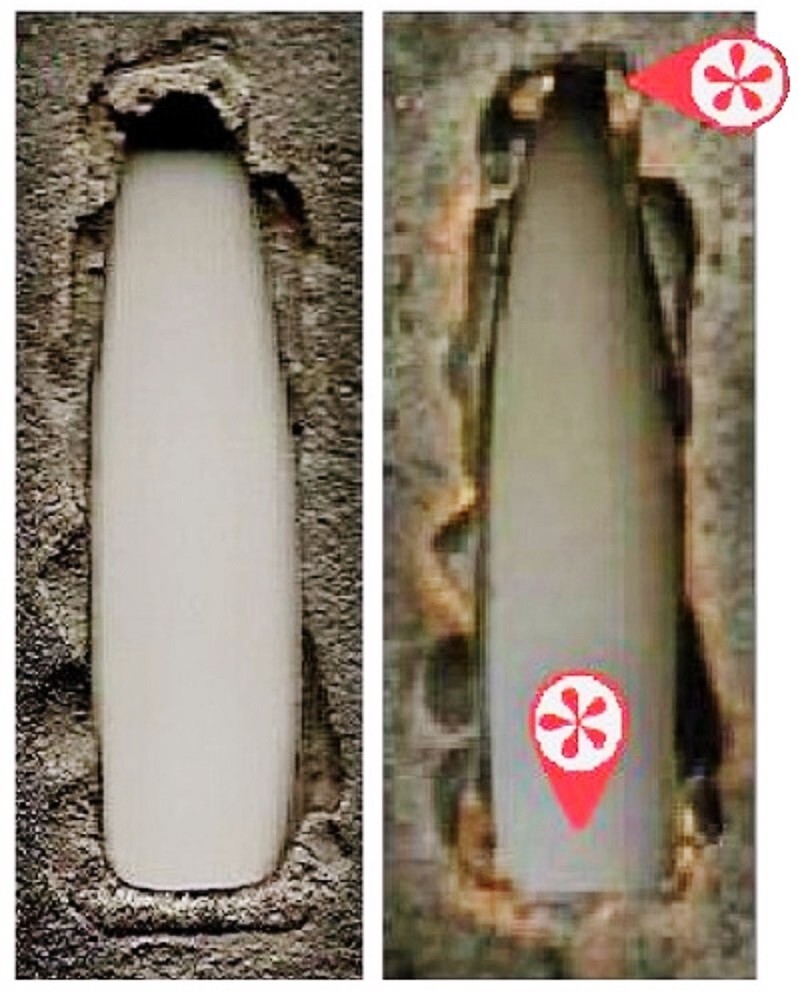

The other image shows the nakago-ana - also usually identical except in this case where it was re-cut for a blade and the cuts have been made through the faked sekigane. [ If it had been real sekigane it could have been removed rather than cut through.]
https://www.worthpoint.com/worthopedia/Japanese-tsuba-oni-and-priest-large-katana
There may be two sizes available for Katana and Wakizashi
A single coppery example same tagane-ato around the nakago-ana.
I did a page on these replicas back in 2016.
A plain one going through auction - https://www.jauce.com/auction/f1041785451

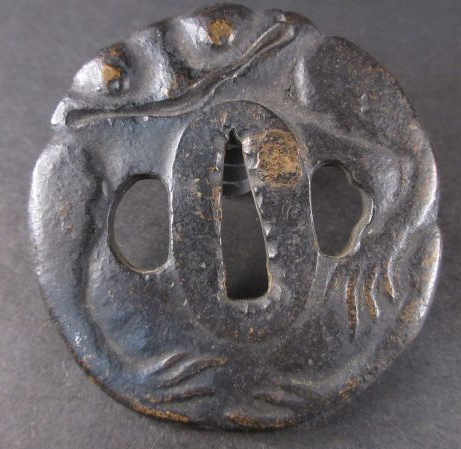

Likewise I did the same with a "frog" or "toad" tsuba - examples turn up from time to time and even feature in some of the "best" museums even if in fact they are cast fakes! [the Rijksmuseum, Ashmolean and the V&A all have a copy.]
I only point this one out as a rather poor example has turned up for auction. https://www.jauce.com/auction/b1090145297  or  https://buyee.jp/item/yahoo/auction/b1090145297
Thanks Dale! This is more in depth than I had expected. So people have they been faking this tsuba for hundreds of years? I’ve actually seen quite a few modern repros of this Futen and Oni tsuba before, didn’t know the “real” ones were also reproductions themselves.
I think I would be hard pressed to find a "real" one, I feel there must be one, probably held in a Japanese museum and used as the basic design - there are lots of examples where the Chinese have been able to make copies simply from images in existing books or from on-line museum collections. The copies sometimes have to resort to the reverse side being from another guard entirely if the image of both sides is unavailable! I think this particular design are made in Japan and the quality is reasonably high. There are a number of designs made as museum replicas, some better than others, I have no evidence so far, but the quantity would suggest to me these ones were made as a souvenir - of what I have no idea?

The sellers wants to start at 26,980 yen - but from my experience it is worth what I paid for mine = 25 cents
[by the way there are three of these selling right now and they turn up every other week!]
The seller probably thinks it is genuine and hand forged, he is either ignorant or profiteering, but I know it is one of thousands, a cast souvernir. Yet some buyers will pay up to $800 USD in the belief these are valuable. So what price would you pay?
