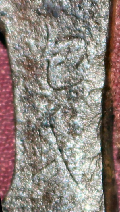

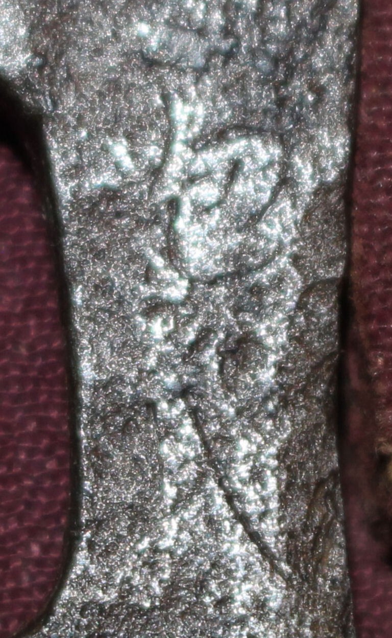

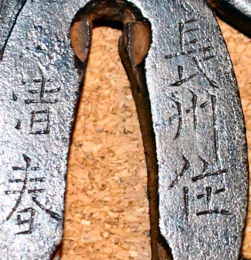

kissakai Posted November 22, 2021 Report Posted November 22, 2021 First two images Choshu ju Kyoharu which doesn't seen right The design has, drum sticks, cord, drum (?) and festive banner (?) so I wonder what the collective design would be Last two images are very faint and I'll try to get better images later today and an image of the whole tsuba The image on this tsuba has the standard mountain, waves and waterfall Quote

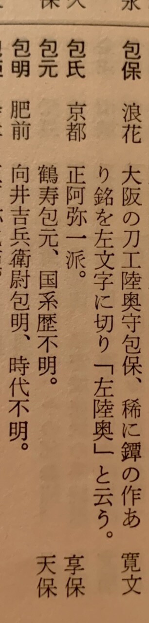

Shugyosha Posted November 22, 2021 Report Posted November 22, 2021 Might be Kaneuji: 包氏 but there isn't one in Haynes. 1 1 Quote
Geraint Posted November 22, 2021 Report Posted November 22, 2021 Hi Grev. With regard to the Chosu tsuba the festive banner is a saihai, a command baton carried when in armour, so the theme would be a martial one, command baton and war drum. All the best. 2 Quote
kissakai Posted November 22, 2021 Author Report Posted November 22, 2021 Thanks Geraint I thought is was an warriors signal device but I expected it to be on a slender pole rather than a bit of 4" x 4"! Any ideas about the rest of the items? Quote
kissakai Posted November 22, 2021 Author Report Posted November 22, 2021 Hi John I agree with the first kanji but looking at the second kanji with a glass and torch I'm pretty sure it is 七 No idea how it would be read as a mei Quote
kyushukairu Posted November 22, 2021 Report Posted November 22, 2021 The Choshu tsuba is signed ‘Kiyoharu’ (清春), and I agree with John that the second looks like Kaneuji (包氏) Quote
Geraint Posted November 22, 2021 Report Posted November 22, 2021 Grev, I surmise that the saihai, with it's tassel, is matched with taiko and a pair of drumsticks, both used in signalling during battles. All the best. 1 Quote
kissakai Posted November 23, 2021 Author Report Posted November 23, 2021 Thanks Geraint That sums it all up 1 Quote
