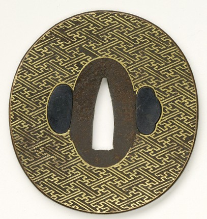

dirk marshall Posted November 28, 2006 Report Posted November 28, 2006 Norisuki Keyfret gold inlay tsuba Quote
kusunokimasahige Posted November 28, 2006 Report Posted November 28, 2006 so should i just cut out the lines and hammer messing rod into them? (i dont have gold) KM Quote

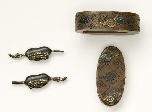

sencho Posted November 28, 2006 Author Report Posted November 28, 2006 Dirk, All awesome... you're killing me here!! Hope you have all of those for sale... he he he! Thanks very much for posting them and welcome to the board (though I suspect you have been lurking for a while!) Cheers Quote
Brian Posted November 29, 2006 Report Posted November 29, 2006 Dirk, Great fittings! I especially like that fuchi/kashira. I think those stylised clouds design might also make for an interesting theme...see them quite often. Not quite on topic..but since the keyfret design was linked to early basketweave patterns, I found this online today: (Not quite showing the manji, but you can see how it would evolve from the basketweave as shown earlier) Brian Quote
