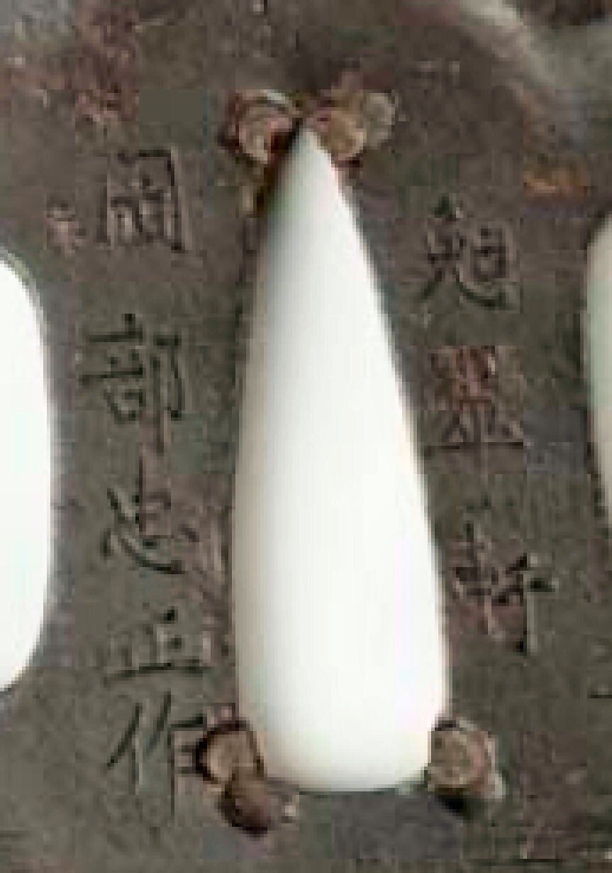

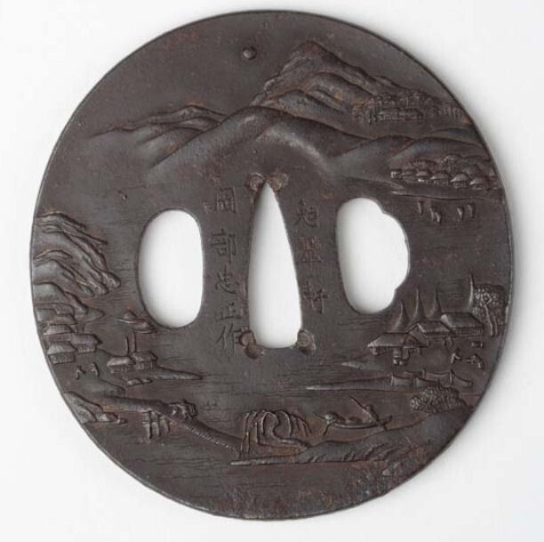

kissakai Posted September 30, 2021 Report Posted September 30, 2021 I am trying to see the tsuba that archived to the UK Wolverhampton Museum. Looking on their website most description look OK and it looks like that they have had help from the Nihon Bijutsu Hozon Kyokai at the Japanese Sword Museum in Tokyo They have two outstanding queries that are shown below One is the single kanji by the flowers The second is a translation of the mei – two images I was just hoping for a couple of ‘Brownie’ points if I ever get to see them all Quote
SteveM Posted September 30, 2021 Report Posted September 30, 2021 The gold letter on the front is 寿 (or, a stylized version of it). Kotobuki. The mei is 岡部忠正作 旭翠軒 Okabe Tadamasa Hisuiken (unsure of the reading of the gō) 1 Quote
kissakai Posted September 30, 2021 Author Report Posted September 30, 2021 Many thanks Steve for a great start All I've found out that Kotobuki is feminine name and Okabe Tadamasa. H09100.0 Worked in Aizu in Iwashiro province and Choshu and Nagato Province Died around 1700 Haynes states 旭翠軒 = Kokusuiken uses the ban 旭 which is unusual Not sure what is meant by Kokusuiken Any other help appreciated Quote

Nobody Posted October 1, 2021 Report Posted October 1, 2021 6 hours ago, kissakai said: ..................... Haynes states 旭翠軒 = Kokusuiken uses the ban 旭 which is unusual Not sure what is meant by Kokusuiken Any other help appreciated Maybe, 𣆶翠軒 - Bansuiken 𣆶(晩)翠 means evergreen in winter. 1 Quote
