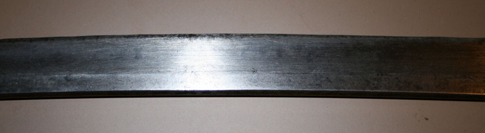

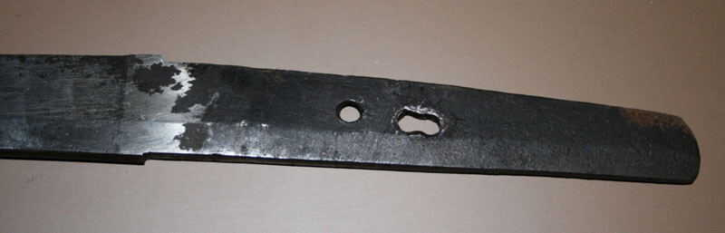

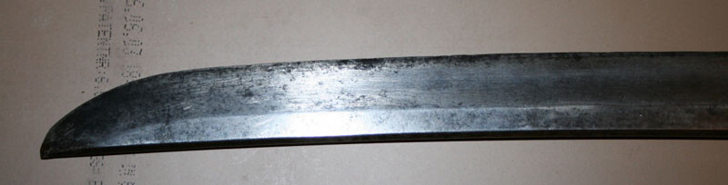

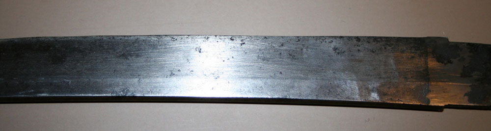

loiner1965 Posted January 30, 2009 Report Posted January 30, 2009 sorry for dramatic introduction but another blade recently aquired but needs a polish badly..please read document which is from a shop in 1995 describing said blade but i cannot see hamon now so must have been better then. can add the following info... kasane at hamachi is 6mm................4.7mm at yokote mihaba at hamachi is 27mm...............20.3mm at yokote so its a nice slender blade its a torii sori shape and is 12mm..........is this common in bizen blades? everything else is as the document..its not in bad shape at all with just a little turn up at the point where i presumed it must have been dropped years ago. question is.......is it worth getting polished and is late 15th cent early 16th as the other documents say.....shin gunto mounts i have for it are not made for the blade so will be sold on to recoup polishing funds.....many thanks for your time and help Quote

Brian Posted January 30, 2009 Report Posted January 30, 2009 Download Irfanview. Free and good for cropping and resizing This waki looks pretty done. I notice it has been sharpened by grinding and that tip is a mess. It might warrant a window by a decent polisher to see what is in there. If the kissaki can be repaired, it might turn out ok, but not worth a professional polish imho. You guys who use the "less professional" polishers who charge only $200 or $400 might have it looking a lot better, but that is a call you have to make. Can't get too much much worse anyways? Brian Quote
leo Posted January 30, 2009 Report Posted January 30, 2009 Hi, looks like a Momoyama or early Shinto blade. Hamon seems gunome w. choji, everything else is obscured. Blade itself seems healthy, but the crucial point is the kissaki. Looks bad from here, but pic is unsufficient to tell exactly. Nakago does´nt look very virginal to me. Sori on a wakizashi must not necessarily tell you where it was made. Regards, Martin Quote
loiner1965 Posted January 30, 2009 Author Report Posted January 30, 2009 Hi,looks like a Momoyama or early Shinto blade. Hamon seems gunome w. choji, everything else is obscured. Blade itself seems healthy, but the crucial point is the kissaki. Looks bad from here, but pic is unsufficient to tell exactly. Nakago does´nt look very virginal to me. Sori on a wakizashi must not necessarily tell you where it was made. Regards, Martin its meaty enough but was told its bizen 15th century but its not koshii tori like i thought it might be....just investigating at the moment before i take the plunge with a polisher...not after a national treasure but i do like them to look like they should be rather than what it is now...why do you say its gunome with choji as its suppose to have midare with choji according to the sales receipt from previous owner Quote
Brian Posted January 30, 2009 Report Posted January 30, 2009 Steve, In that condition, gunome and midare aren't too far apart. Midare is just irregular, whereas gunome would be more regular "bumps" Could turn out to be either, or both. Gunome midare..irregular waves. Can't be sure until it is in better polish. As far as sori is concerned, there are guidelines, but no hard and fast rules. Brian Quote
